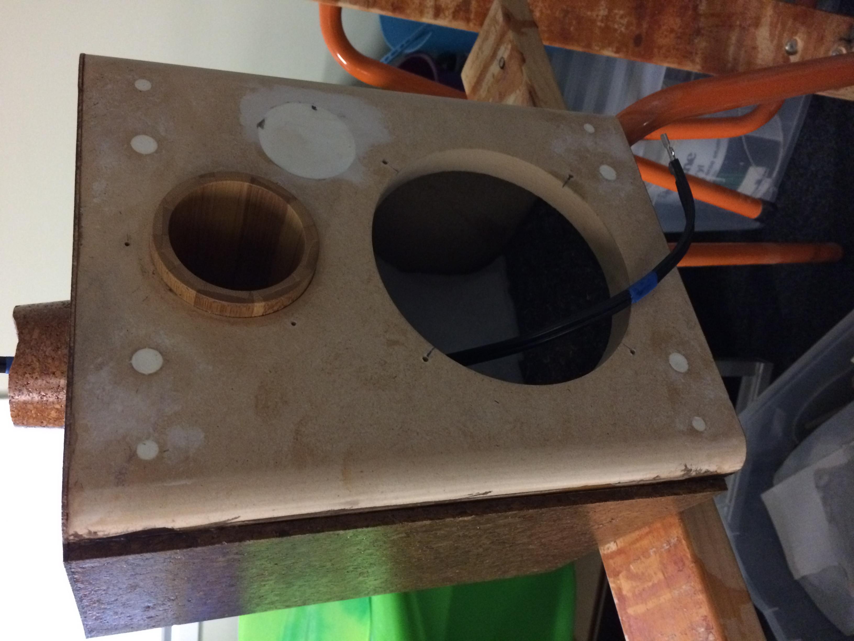

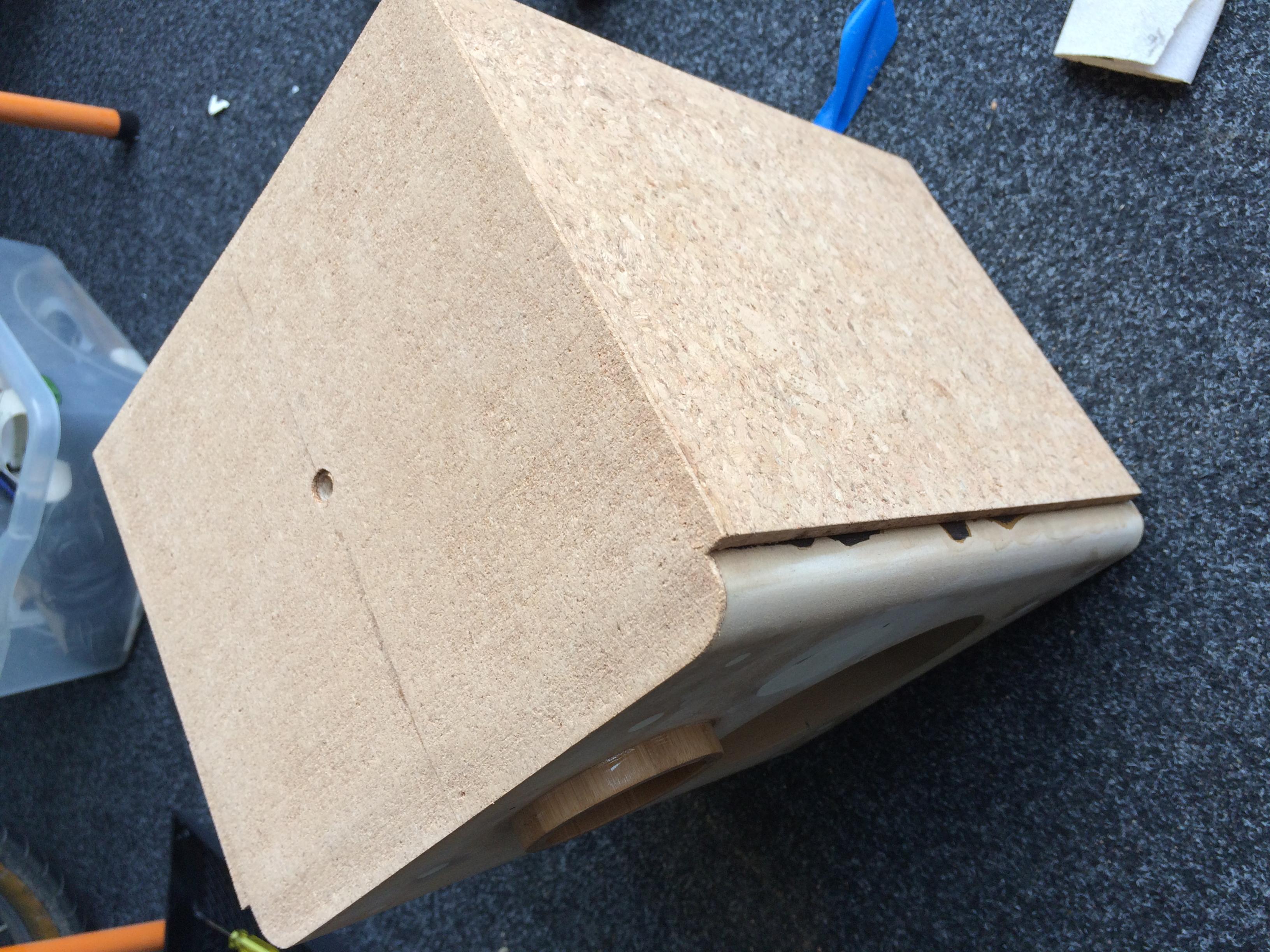

I pulled them apart and removed the plastic front, sanded the boxes down ready to cover.

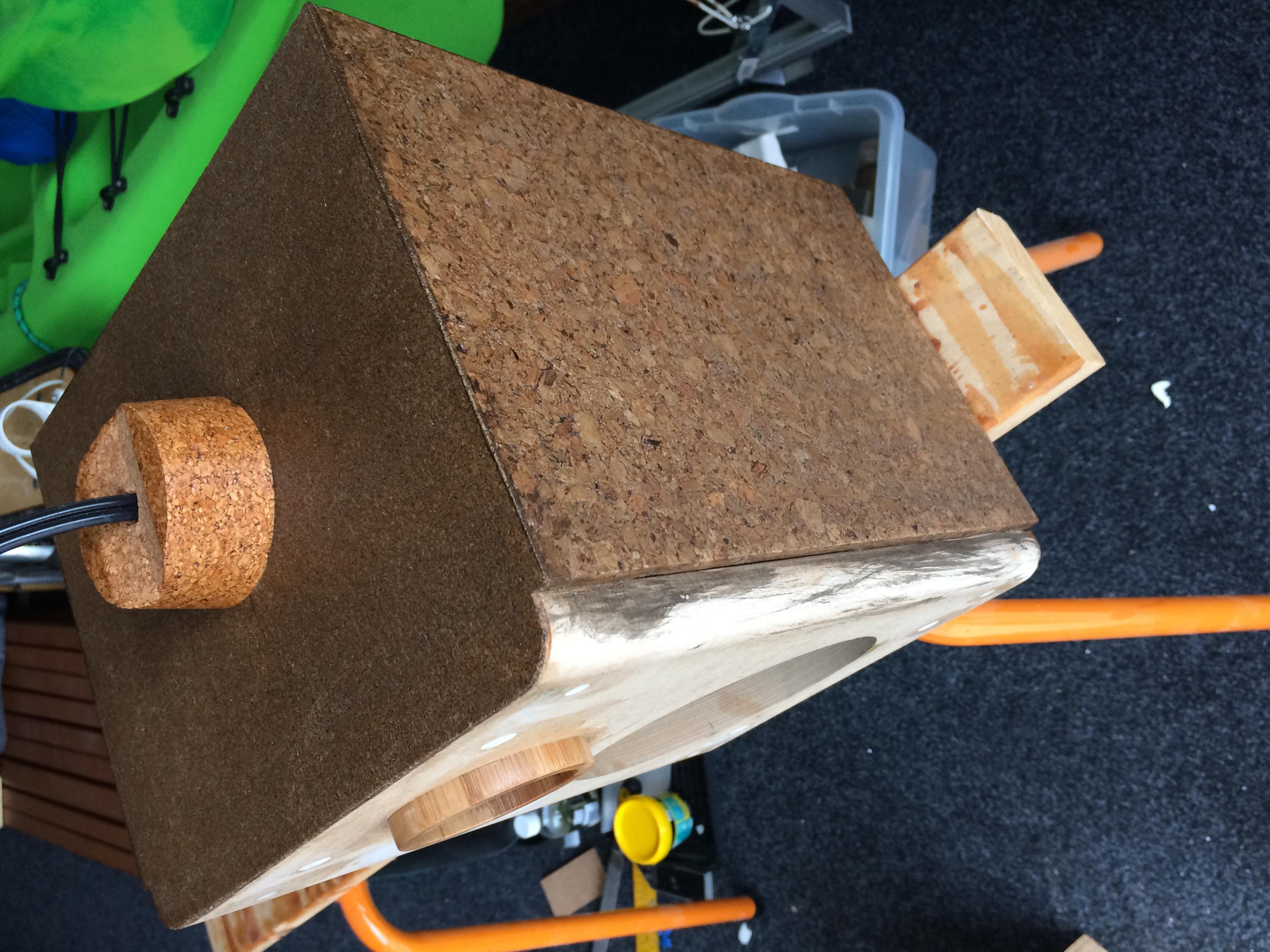

Filled in the existing port and used the tweeter hole with a bamboo cup(end removed), for the new one. Hoping it would be ok.
Glued cork onto the sides and top of boxes and oiled (after staining with a single coat) 6 coats, then stuck a cork block on top to hold the tweeter unit. I find most of this stuff at the 2 dollar shops.

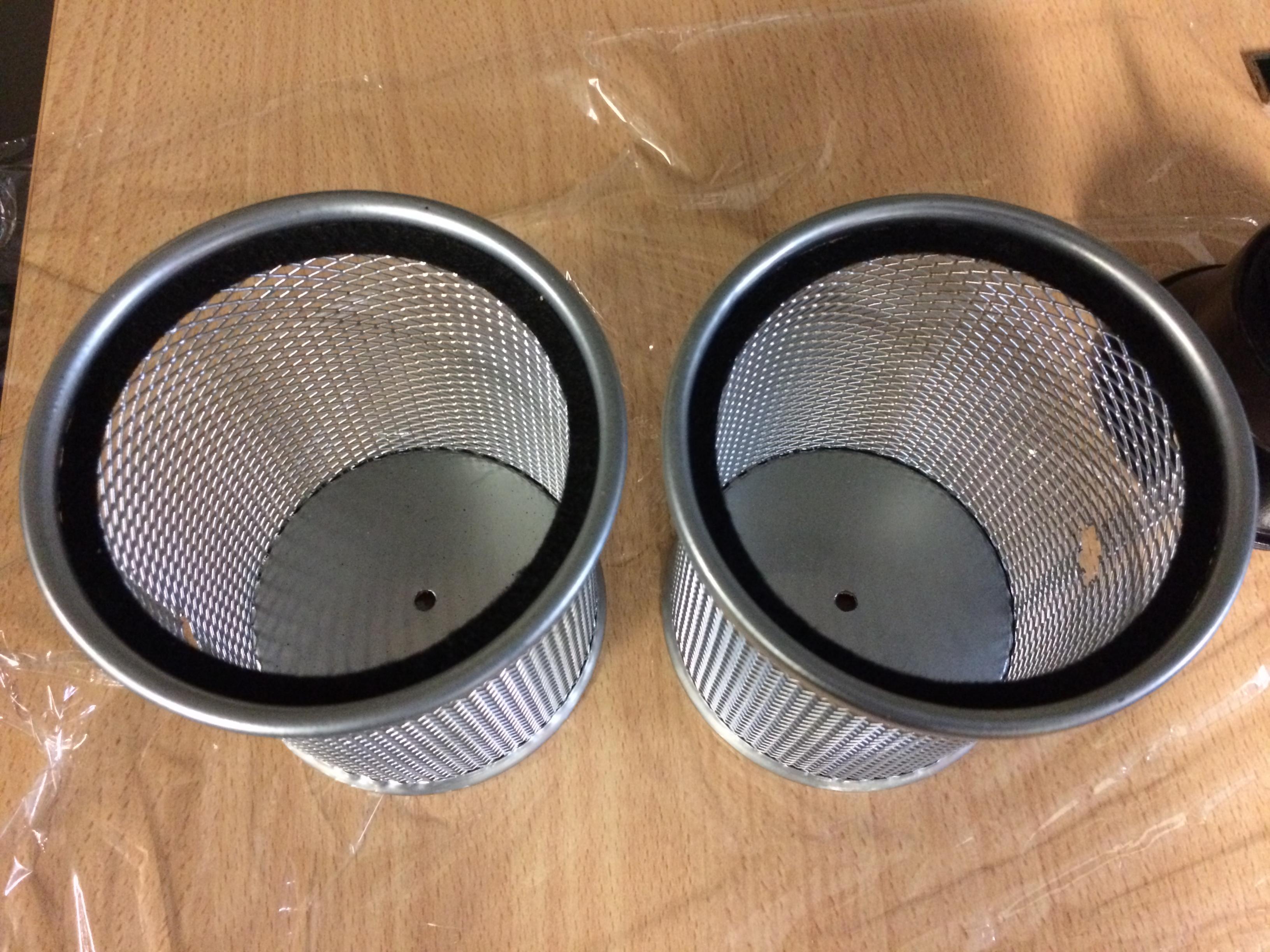

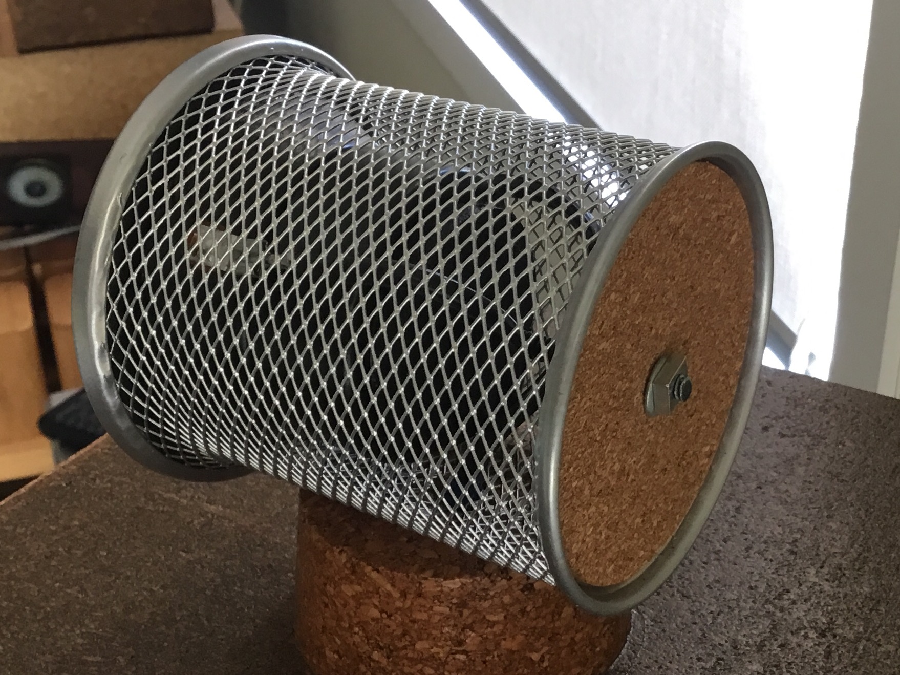

Also found a mesh basket used to hold pens and pencils, drilled a hole in the bottom and made a hole in the side to slide the cable through.

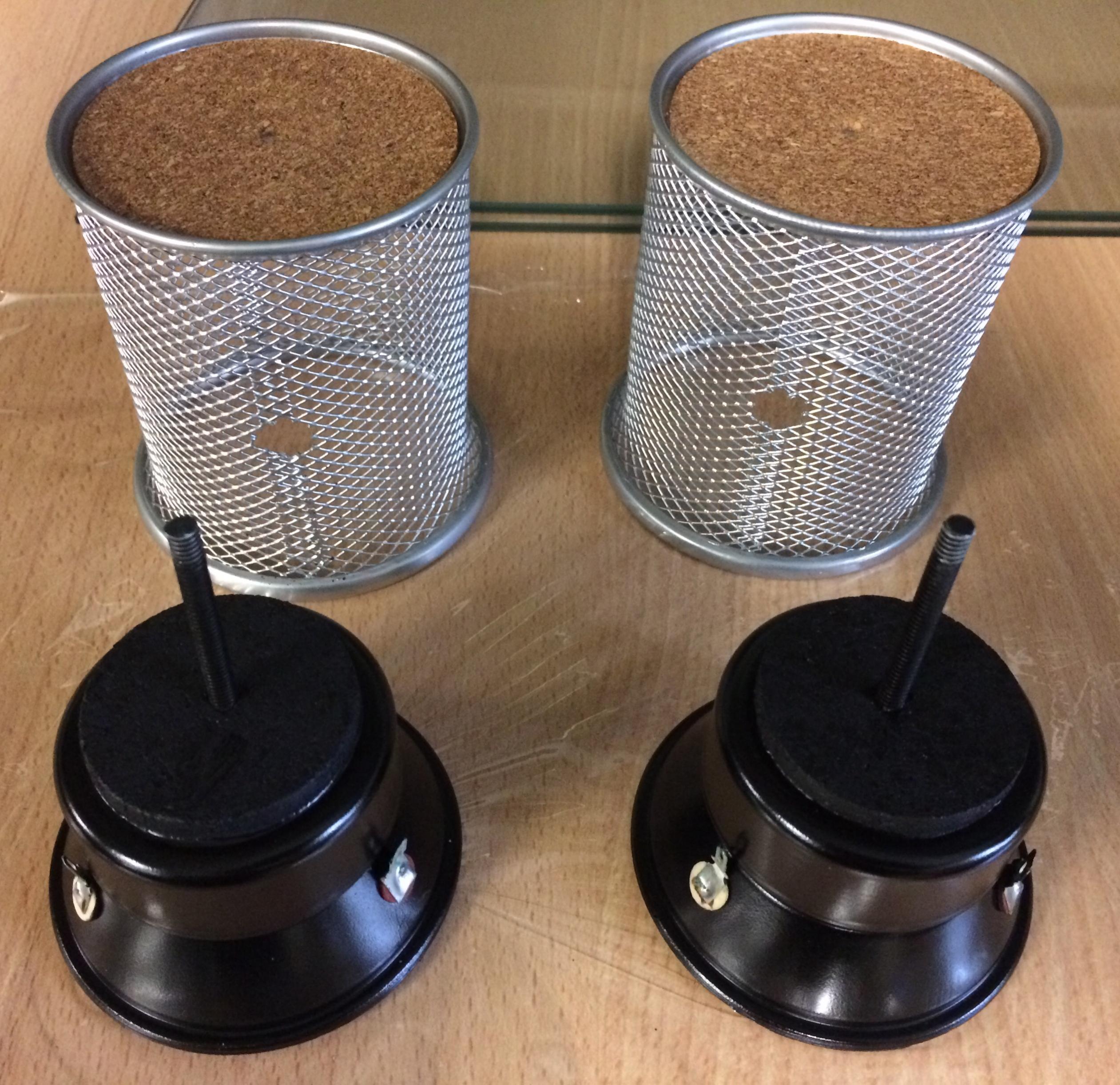

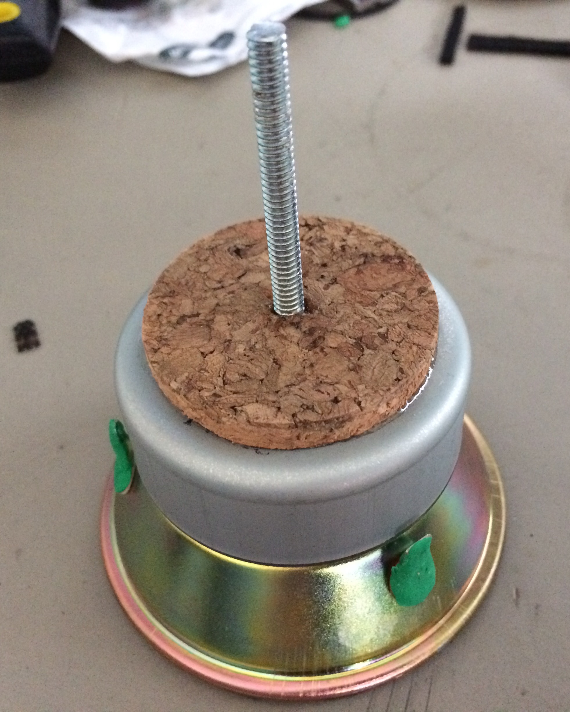

I used plastercine to cover the terminals while painting the tweeters as it can form any shape and be peeled off easily.
I also glued a circle of cork onto the back of the tweeter with a thread in it, which I would later use to attach to the rear of the basket. Cut some felt surrounds to secure up against the mesh for the tweeters.
I also glued the mesh onto the front of the tweeters.

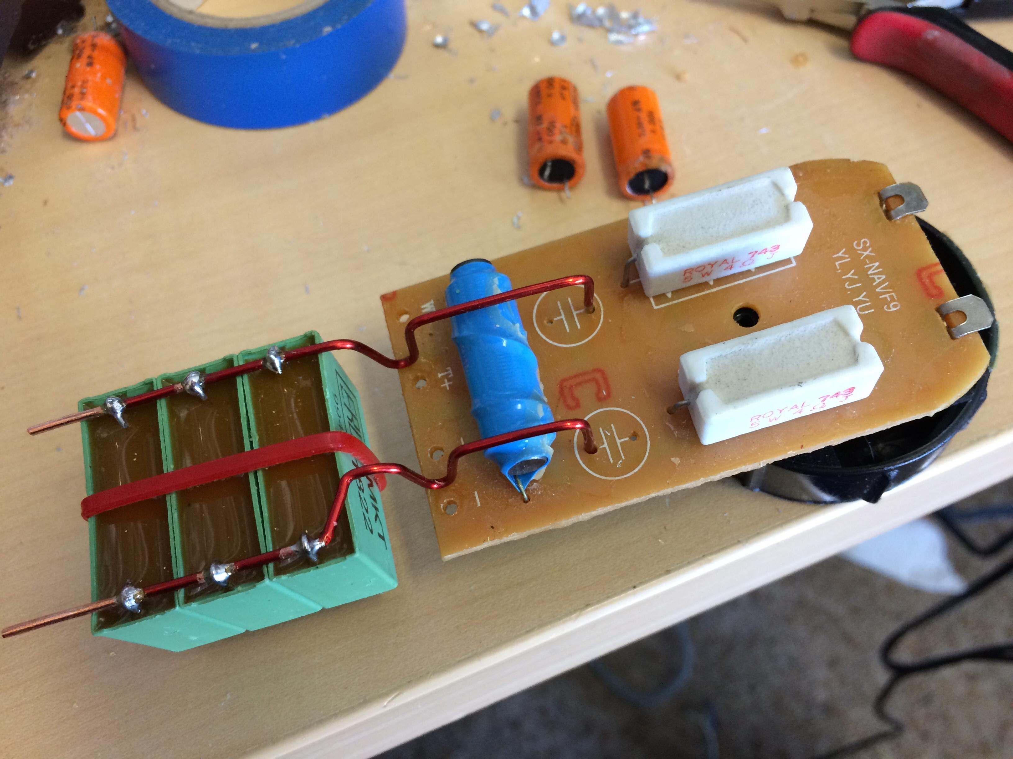

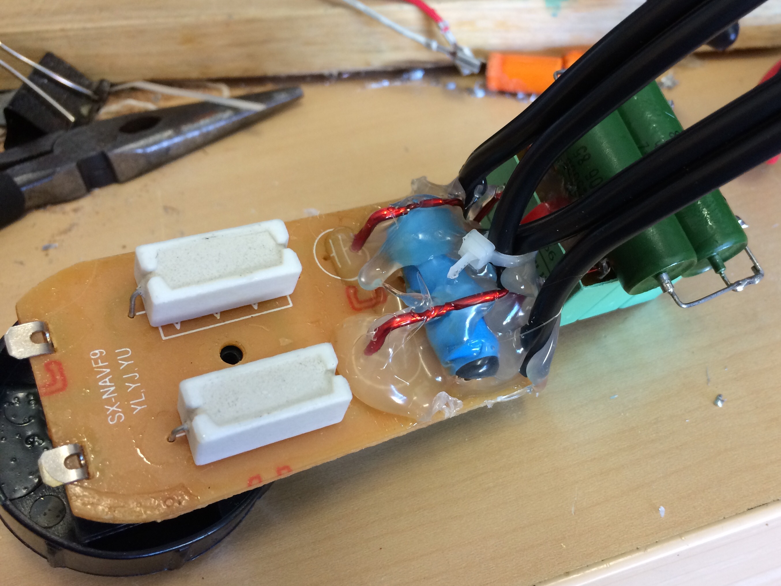

Next I replaced the caps on the cross-overs
I took out the old orange caps and replaced them with others.

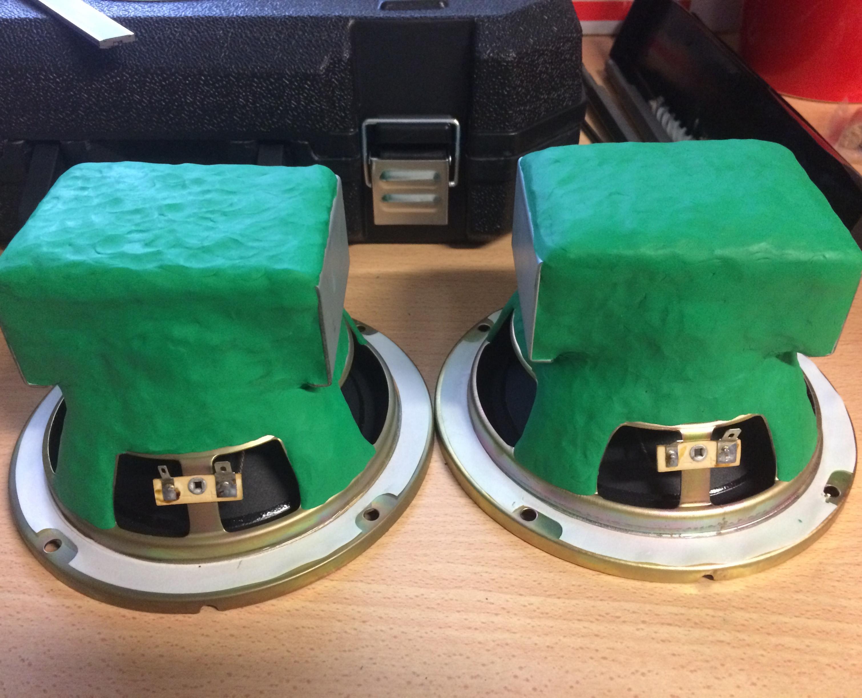

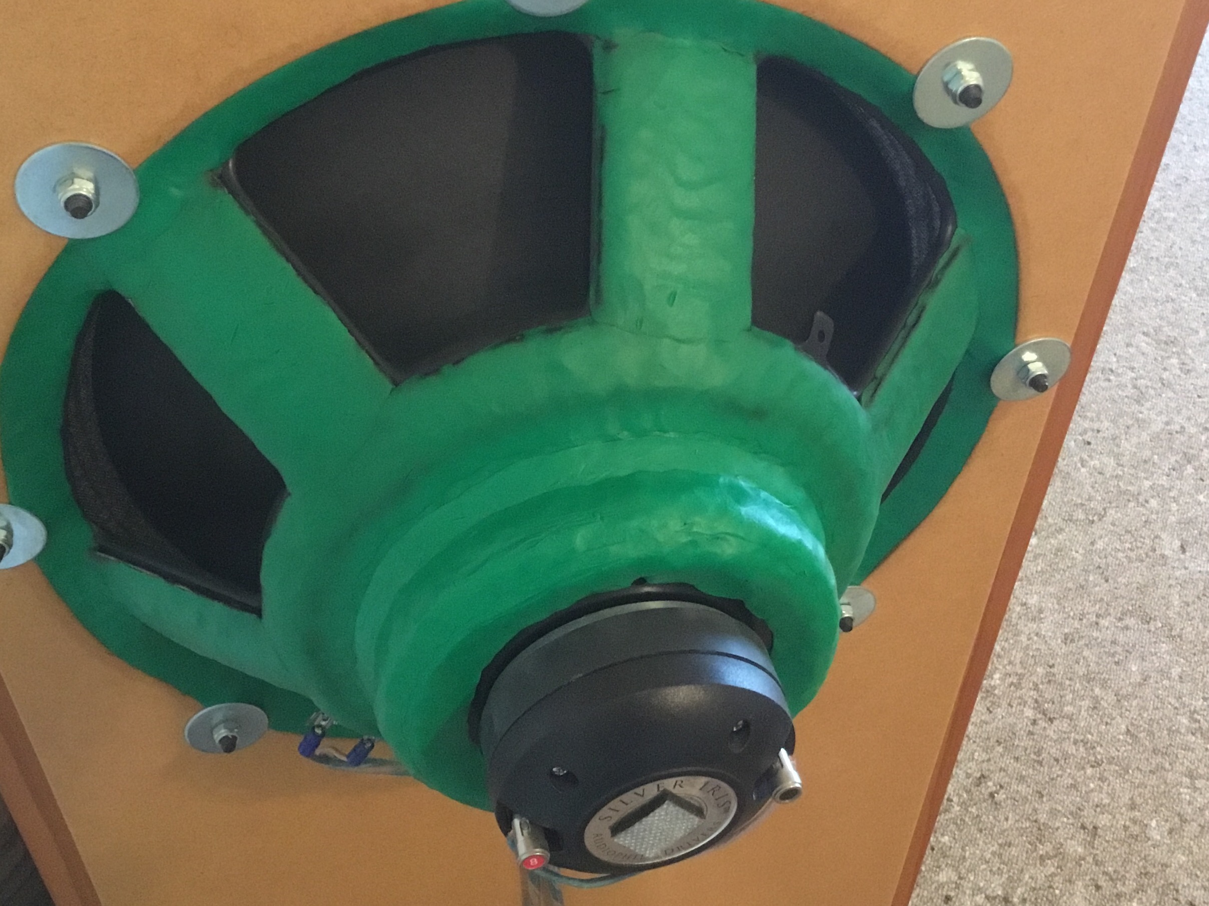

I took two packets of 500grm plastercine and proceeded to work in onto the rear of the drivers little by little pushing in into the gaps building up layers and including the shielding. I used a total of about 450grm per driver. I have done this before on my much more expensive OB drivers with such great success, that putting on these was not even a second thought.
It won't go hard, crack or sag. Never dries out, so no worries. My OB drivers are still going well and they are waaaaaaaaaaay more expensive than these little things.
Glued the final front cork on in two steps. First the flat front was glued, then using contact glue rolled the edges down.

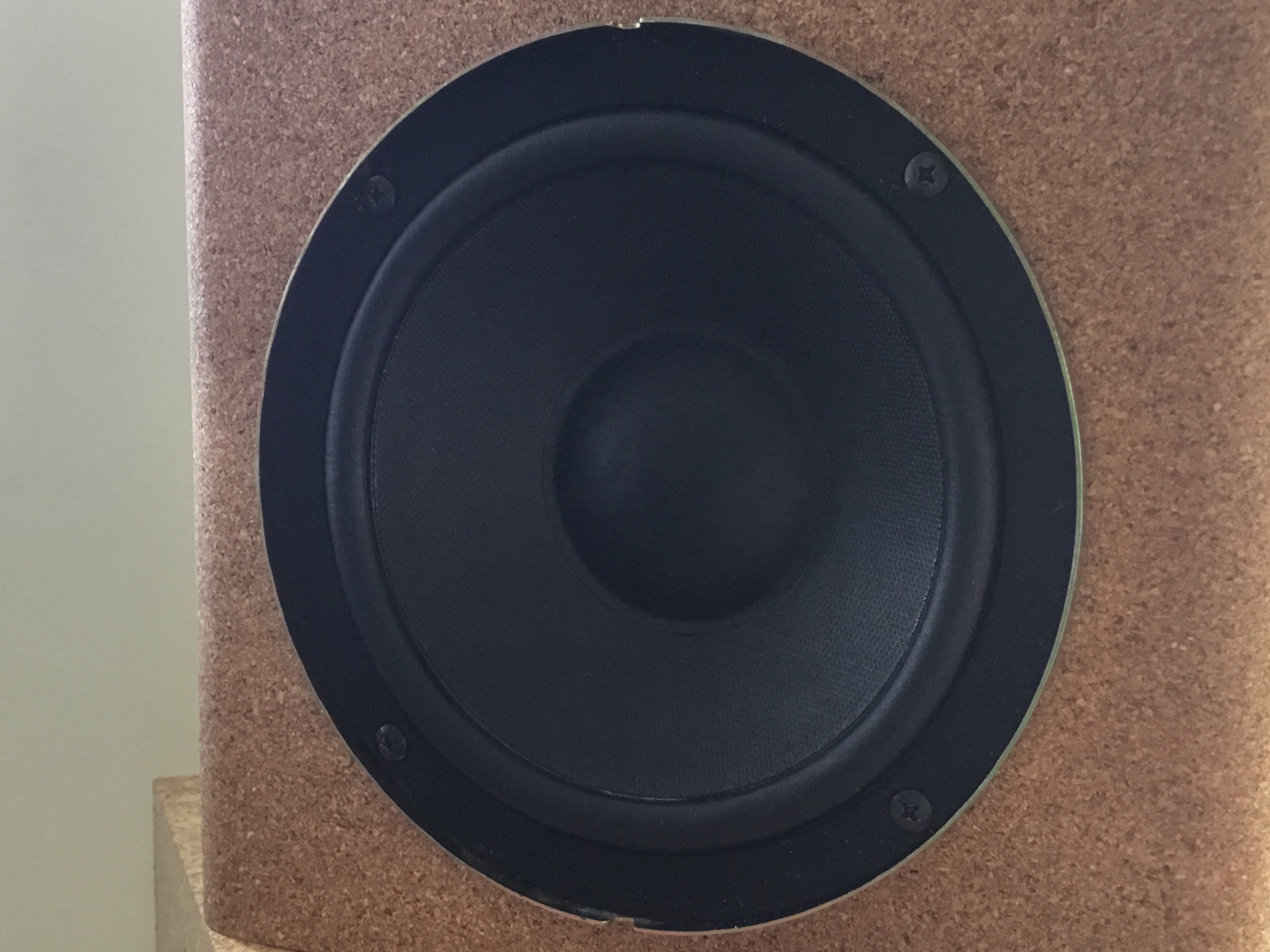

Made up some felt surrounds for the drivers.
Put felt on the bottom as well

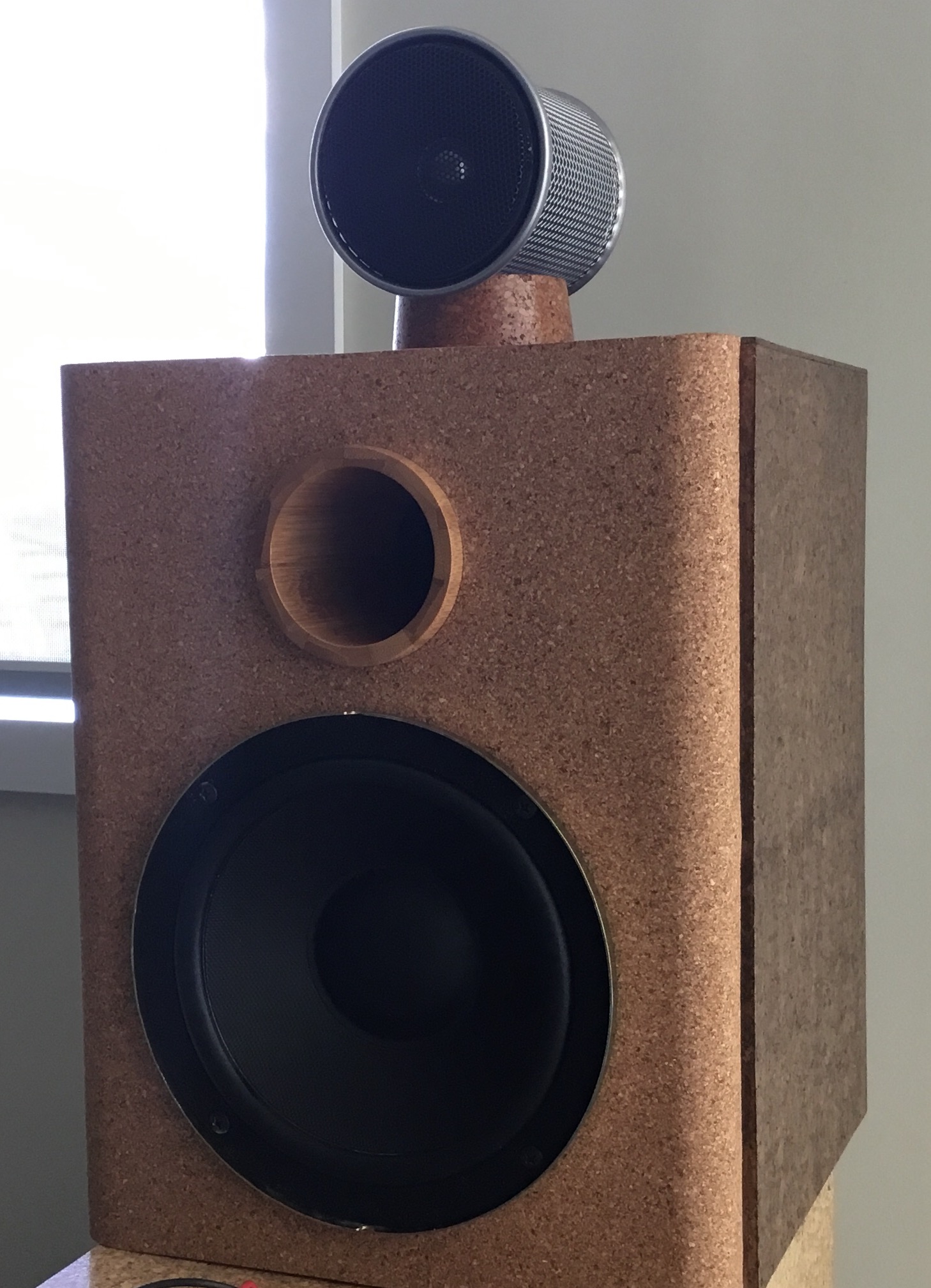

Glued the tweeters in place
Installed the main drivers and they were done.

They actually sound better than they should. But don't take my word for it, go and buy some plastercine and try this out on some speakers you have lying around. I have also used this stuff to dampen the chassis of a CD player with great results.

It's not modelling clay, it contains petroleum jelly so will not set and go hard.

Nice job but the box should be flipped upside down so the tweeter sits near to the woofer.
I know that perfection doesn't belong to this world but this basic knowledge should be *used*

yes i was looking and listening today and realised i could have easily flipped the units over, nevrmind.

I have had Plasticine on my Hawthorne OB's for a few years now and are completely sold on the improvement to them, so was keen to try something else just to confirm this theory. And that Plasticine has stuck hard, no issues what so ever. Could have done a better job on them, but its all about the sound.
