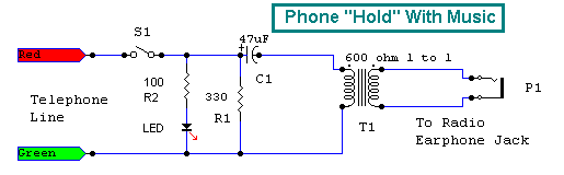

I found the following schematic and it would be nice if you could give me your comments about it.
http://home.maine.rr.com/randylinscott/jul98.htm
If I want to be able to speak at the same time as the music plays, can I simply remove R1 ?
Thank you 🙂
Thank you 🙂
Thank you 🙂
The circuit looks goo. You might want to see if the CD player has an earphone jack and volume control or not. Normal RCA outputs don't handle 600 ohm impedance well, and you might want to adjust vlume.
If you plug this circuit along with the phone, you would be able to talk while you play when the switch is on.
Unfortunately, there's no volume control. Is 600ohms too low for RCA outputs ? Could a simple potentiometer between the cd output and the coupling tranformer correct the problem ?
Thank you very much !
Most CD outputs like at least 10K. If the CD player has a remote controlled volume, you might just at a buffer. I'm not really sure whether a potentiometer will work or not because I normally don't deal with tranformers in the signal path.
Normally the CD manual would specify what kind of load the RCA output interface requirements are.
