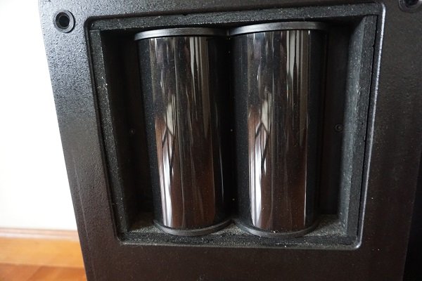

Discovered that the Linaeum dipoles from some Optimus LX5 nest nicely on the top of the ADC MS-650. I’ve been listening to them and have been pleasantly surprised how well they add airy-ness. I’ve crossed them using a 6.8 uF cap at about 3,900hz which is a little lower than what they were originally (6.2 uF).
What have others done with the Linaeums? Any pointers?
