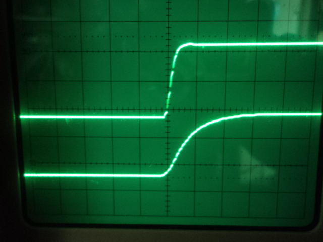

Why not ? Somethings not right here. That relationship goes completely against the grain. All amps using global feedback, use it to extend the frequency response, as such the slewrates become faster; one has only to look at 1kHz squarewave to see this with and with global feedback. The results are dramatic !
Pic with Square wave output of 100W power amp with global nfb (upper trace) and without (lower trace) . Rise time with feedback ~3.5uS.
Without the feedback, the response -3dB @ 10kHz !!; With it -3dB @ 55kHz. BIG difference. I fail to see the sounds "thin" connection. It must be something else to blame.

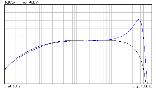

Here is the open loop response of the amplifier (1watt) into a dummy load. (blue trace)
The black trace shows the result when I used an RC-network gNFB.
Transformers resonance is at 44,5 kHz
These where all measured without plate to plate NFB

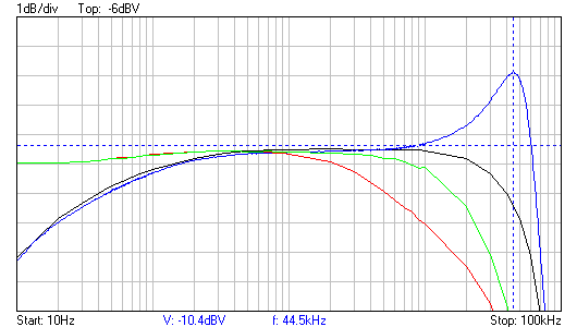

Wow, it is starting to make sense..!
Red trace is with shunt feedback added and the gNFB through RC network.
The green trace is with shunt feedback and no gNFB.
If you compare it with the blue one, you'll notice the similarities and a little bell inside your head should begint to ring.
Now, how do i fix it ?

OK, the OPT peaking is increasing the NFB at high frequency, causing less gain.
I'm guessing (without detailed observations) that the peaking is much greater on the primary side as the P-S coupling decreases, resulting in greater effect on the feedback vs. the output, hence the greater loss with local feedback.
This could be the issue Sheldon is noticing as well.
The feedback or the OPT or both could be compensated. I'd be inclined to try a zobel across the OPT primary as an experiment.

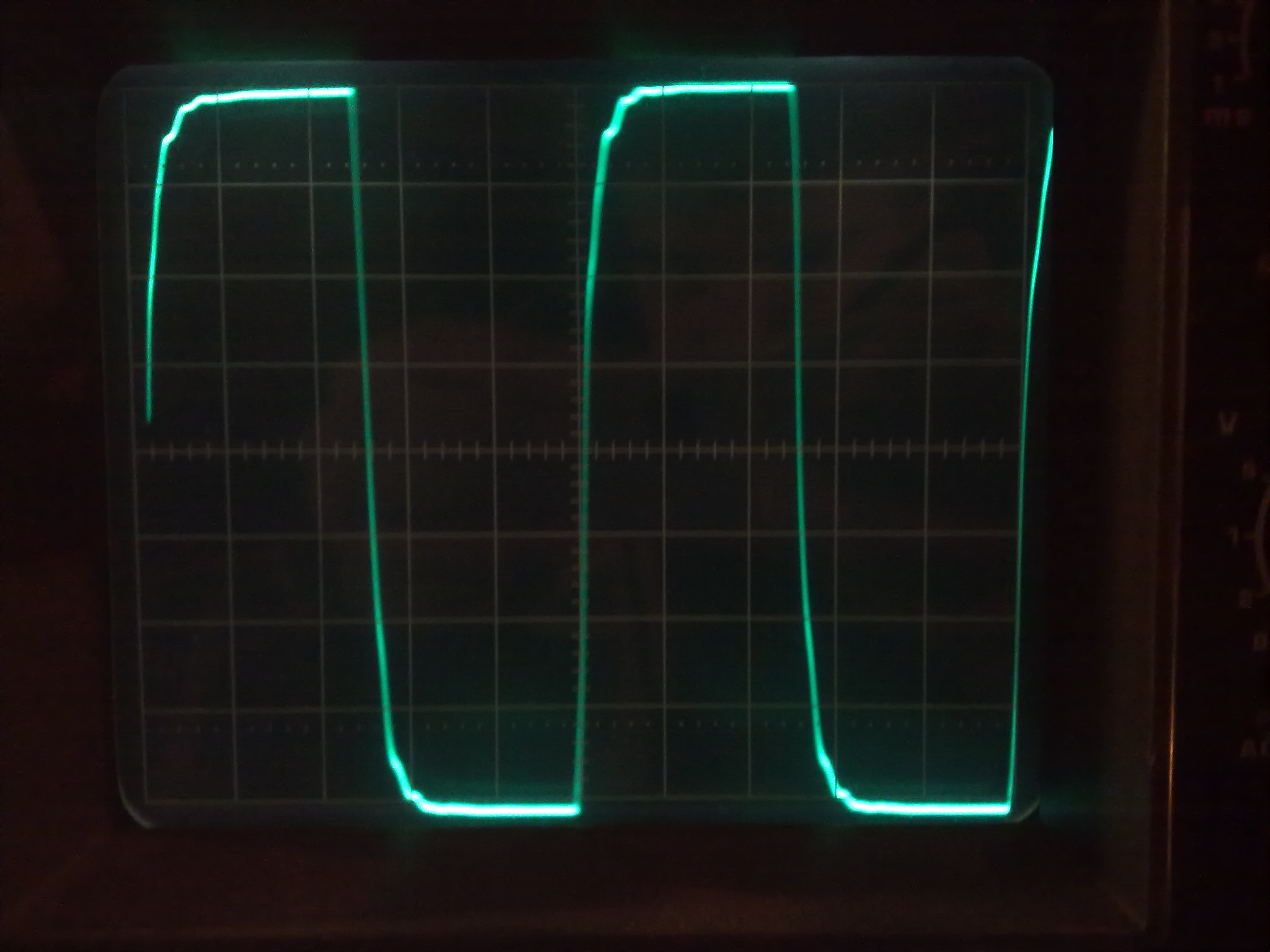

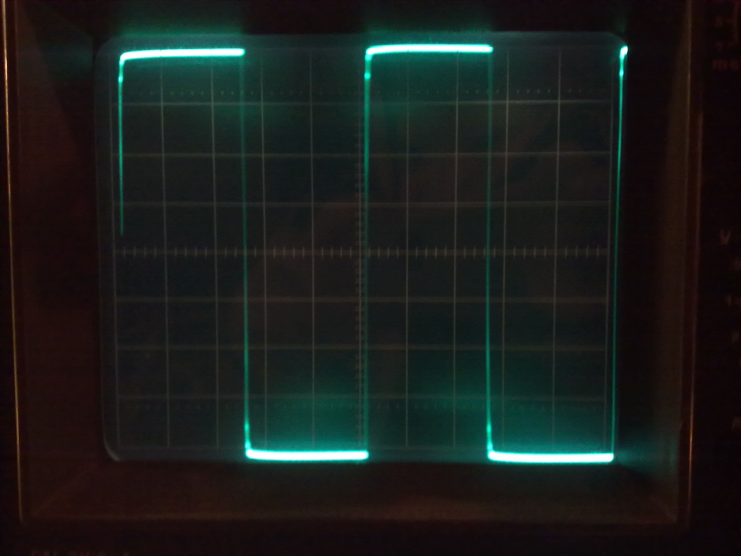

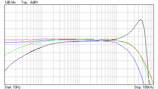

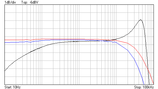

So.. I added a load of gNFB no RC network this time (altough turning it upside-down might have worked..)
Black = open loop
Blue = with plate to plate feedback
Red = same as blue, but with gNFB
The other pics are square wave (1khz and 10khz) at 1 watt into the dummy load.

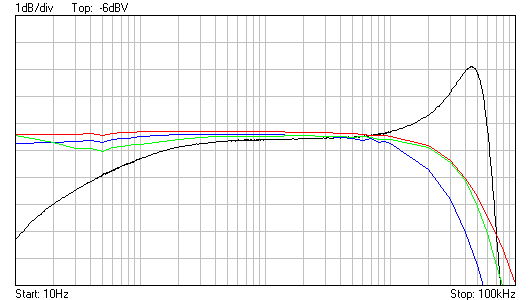

..So i replaced the 0.91µF capacitors I was using to couple the feedback resistors, with 47nF ones..
This creates LF roll-off in the feedback circuit, compensating the LF roll-off of the output Xformer..
(evil/genius plan, I leave it up to you to decide..)
Et voila!
No gNFB and pretty decent square wave response, even with a real speaker as load. Just like I wanted..
The green trace is that of the circuit I just described.
The previous idea obviously was a stupid one, as it made the DF higher where you want it to be small, on the lower frequency's..
Another way, wich I'm testing now, is to make an arrangement with resistors, in baby huey style. And accross the resistor that connects the two phases together, I placed a zobel.
Now there is less damping in the highest frequency's, but the High frequency roll-off of the amplifier is much better then without the zobel..
