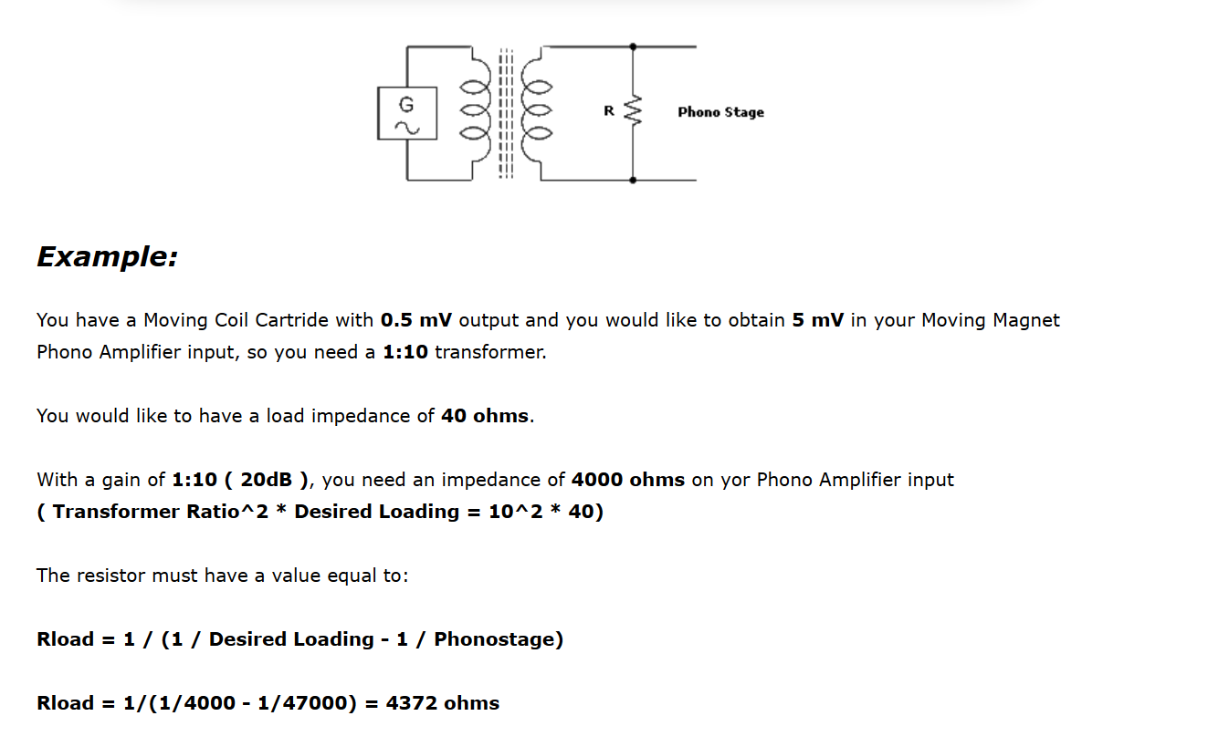

Step Up Transformer Calculations
Visit this site, it shows how to calculate Rload, X and other params.

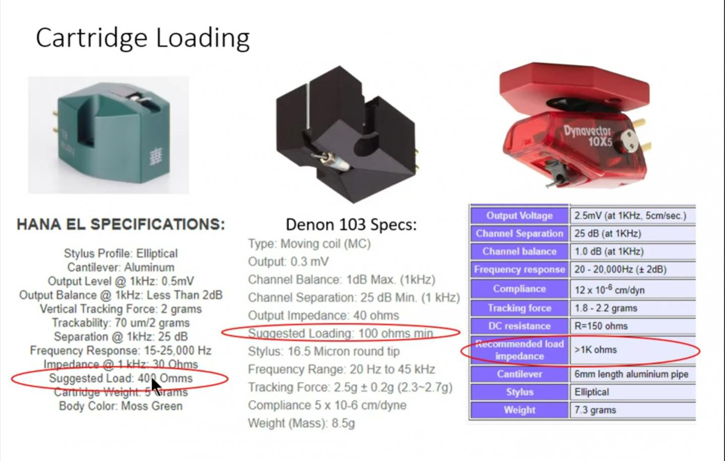

X=SQR(70000/250=280)=16.72, is this correct turn ratio of your setup xformer? What brand and model of MC you using? What is MC catridge load impedance? When you have these params then you can calculate the Rload resistor. The calculator is based on 47k grid resistor of phono preamp, can be changed to your own value.
