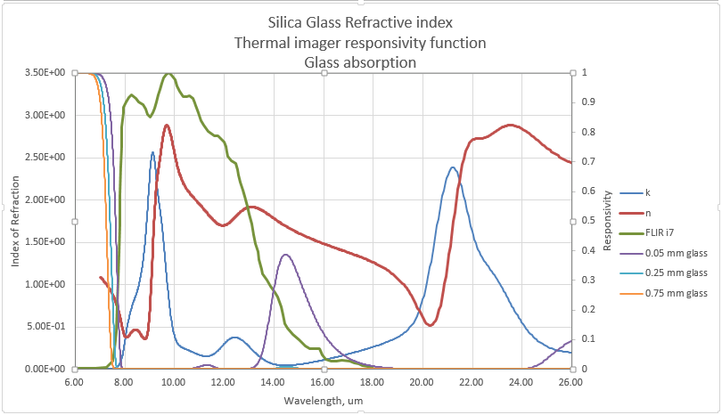

I've read a few papers, and put together the plot attached:
- left axis is for Index of Refraction (complex: real part in red, imaginary in blue)
- right axis is for the rest
- green is the relative response of the FLIR i7
- purple, light blue and orange are the transmittance of the glass at thicknesses of 50, 250 and 750 um, where 750um is approximately our thickness.
The data is from this paper:
R. Kitamura, L. Pilon, and M. Jonasz, 2007. Optical Constants of Fused Quartz From Extreme Ultraviolet to Far Infrared at Near Room Temperatures. Applied Optics, Vol. 46, No. 33, pp. 8118-8133.
The absorption curves come from the imaginary part of the index of refraction: it's also called the extinction coefficient, and it's related to transmittance as
T = exp(-2\pi k x / \lambda_0)
where k is the extinction coefficient and \lambda_0 is the wavelength in vacuum and x is the distance traveled.
This Stack Exchange answer has a very nice derivation of the relation above from John Rennie.
Lastly I observe the very complex shape of the real part of the IOR, goin from 0.35 to 2.5 in one micron and then staying mostly above 2 in the region where the instrument has an sensitivity.
The next step I have in mind is to plot the emission resulting from this and its angular dependence, looks like it'll be quite shapey 😱

Or perhaps it shows that the FLIR CCD is ineffective at measuring the plate through the glass envelope, regardless of any sort of attempt to 'mis calibrate' the device to in an attempt to overcome the short coming of the device and read the temperature better.
I'm sure I read somewhere that the temperature can be approximated by the perceived colour, and if ball park is good enough, then +/- 25 degrees may be good enough, and feasible?
Other than cracking a tube opens and then putting the FLIR and tube electrodes into a new vacuum....
But then, that much effort, or this much effort? What does it actually achieve?
Say it's about 450 degrees at full barely visible red. I'm not sure what any more accuracy gets you.
Surely it's now more of a semantic study.
The anode is then either, hot enough, or too hot.
My point was more that the FLIR misestimates the temperature of the glass, because really it's the spectral distribution of the glass radiated field that violates the assumptions built in the thermal imager.
