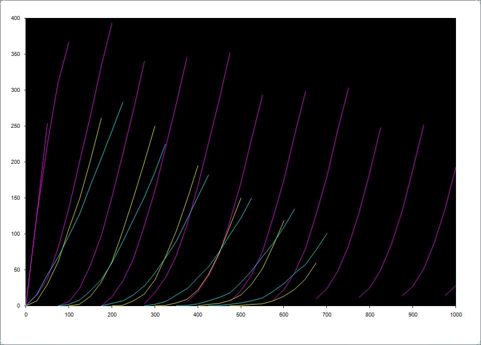

The attached circuit uses a p-channel mosfet follower with a so-called 'Schade network' to introduce plate-grid feedback and make the pentode or beam tetrode output tube behave like a very efficient low-mu triode. I put in an n-channel follower to present a very low capacitance to the Schade network. This allows higher resistances to be used in the Schade network without rolling off the high end too much. I have been using FQPF2N90(900V, 5.5pF Crss). Another advantage is that the driver can supply grid current. Anyway, the schematic shows values for 20% plate-grid feedback. I calculated out a 170+kHz corner frequency for the feedback network which should keep things nice and flat through the audio range.
I have also attached curves for KT88 triode connected(blue), 300B(yellow), and KT88 with 20% plate-grid feedback (pink). Sorry, grid voltages are not labeled and are different increments for each of the three. If I recall correctly mu came out to a little less than 4 for the 300B, 5 for the plate-grid feedback KT88, and about 8 for triode connected KT88.
Anyway, I think that this circuit should best a 300B in linearity, gain, have a higher input impedance, lower plate resistance, and higher power output. It obviously has the disadvantage of needing a bunch of supply voltages, but I'm not gonna let that stop me.

From looking at the purple curves, it certainly looks like a very linear triode. A cascode could fix the P-chan voltage issue, but getting into a lot of parts then. I can see Tim's issue with the input follower causing some Fet characteristic, but not much due to it's high gm.

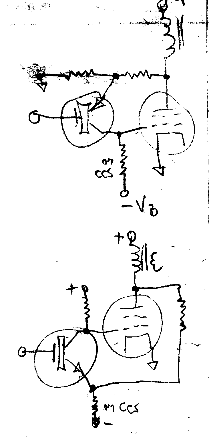

I like a little different approach to Schade feedback, using voltage or series feedback at the input. (see attached) Then the Fet operates at near or at constant current, so no Fet signature remaining (constant voltage across the Fet gate to source). Loses some voltage gain though, but tubes are good at voltage gain anyway. Some issue maybe with Drain to Gate capacitiance, but recent Fets are very good there if you keep 25 Volts or more across them. Main issue is tube bias stability, needs additional circuitry.
The super triode is a different animal, but a very nice scheme. Using the Fet for current gain and the tube for voltage gain control (via plate feedback) . With no Fet signature remaining either. Some Japanese sites have used that scheme for some time. You won't have much of any showy power tubes that way in most cases since the Fet is handling the power.

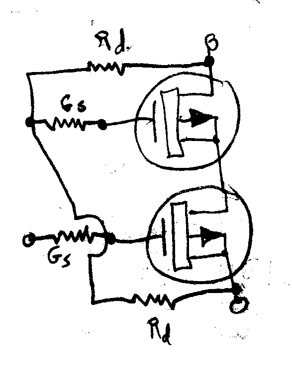

A couple of questions:
What does a cascode follower look like?
I think that the p-channel follower would be going from abut .5 to 6mA on the extremes. I would hope that what Vgs variation there is would be pretty small especially compared to the swings we are talking about here (100Vrms or so). Would there be a significant amount of distortion because of this? I don't know. I think I will eventually build this and see.

The P channel cascoded follower is attached. The Rd/Rd voltage divider keeps half the Source to Drain V drop on each Mosfet.
Edit: OOPs! I just noticed I drew an N-chan cascoded follower with P-chan parts. For P-chan, the divider middle would go to the bottom gate, and the input drive to the top gate. And sources go on the top sides.
I just noticed some goofs on my earlier diagrams. The bottom one should have the "or CCS" on the top drain resistor, not the bottom source one.
I forgot to put real in Mosfet diagrams too (my shorthand instead). Top diagram is P-chan and the bottom one N-chan. Some gate stoppers needed too.
With a CCS instead of a resistor in the above diagrams, the gate to source voltage stays near constant, so removing that capacitance issue (390pF for FQP2N90). The reverse transfer capacitance from drain to gate with Miller gain factor is now the predominant issue. (5.5 pF * Miller for FQP2N90) For the N-chan case, one could just use some 5W video amp tube instead.
The local loop gain gets quite high with the CCS's also, so some freq. roll-off element may be required for stability.
