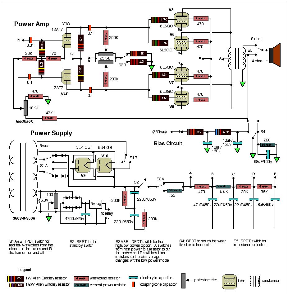

I just worked on a Peavey TripleXXX amp with almost the exact same circuitry. Best advice is to make or buy a bias adapter, just a male and female tube socked wired straight across, but with a resistor so you can measure the bias current. You can also buy them ready made from Eurotubes for $25 or so. FWIW, the inductance of their output transformer was equal per side, but the DC resistance was different by about 10 ohms.

About the adapter: I've seen those and may get one at some point. But in my future amps I plan on having a quality 1 ohm resistor with a test point by each tube and rubber grommet. One can then pull the tube slightly to measure the plate voltage w/o having to take the thing apart and measure the cathode voltage to bias it correctly and easily.
