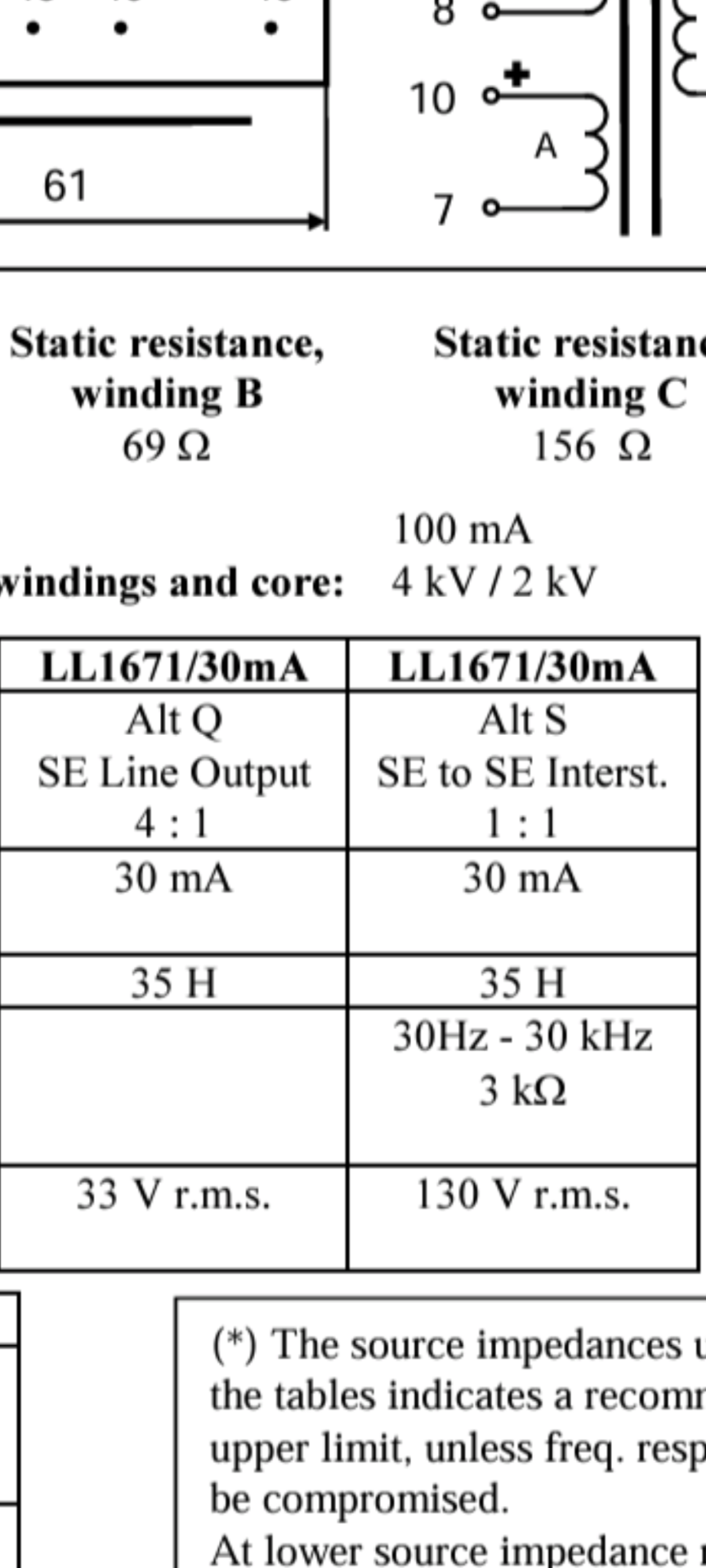

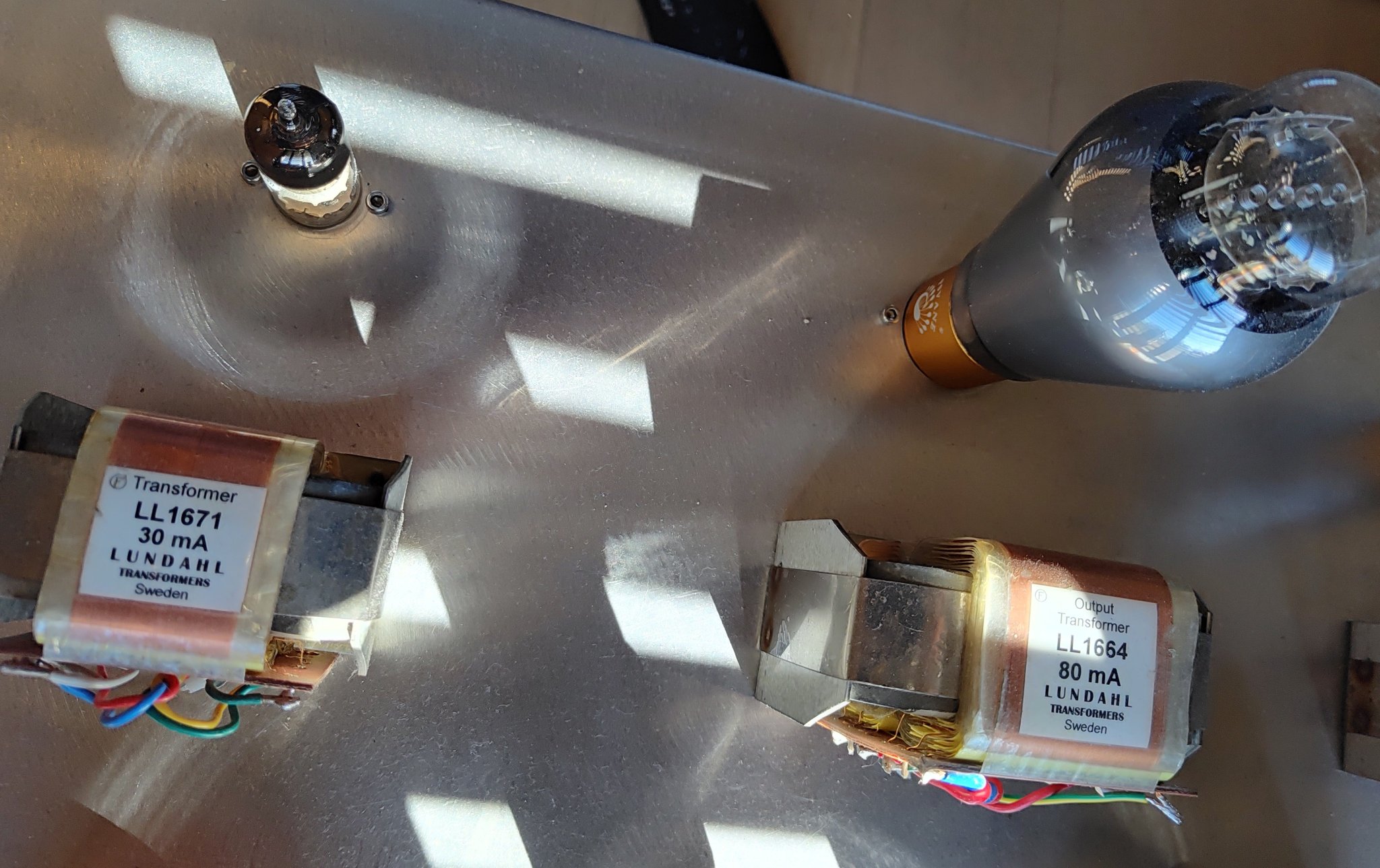

I use Lundal 1671 , 35H primary SE to SE 1:1 , 1900ohms plate resistance D3a in triode mode 195v 21mA and have serious bass response. I use Two Subwoofers , between amp and speakers, using the high impedance input in the Subwoofers. Serious bass response, maybe 20 25hz.
