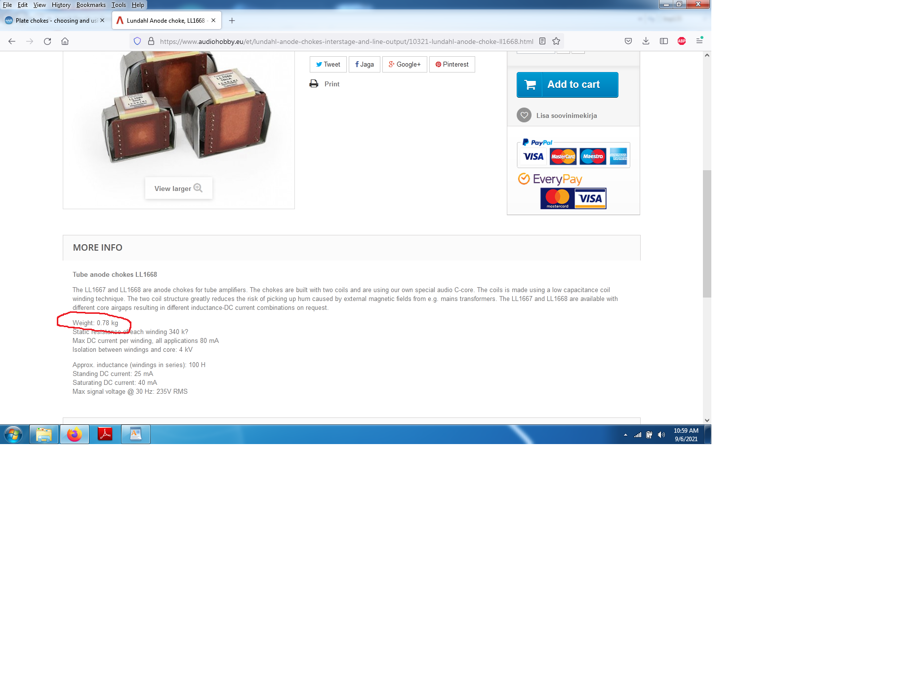

The only problem i have with them apart from the price is that the ones able to withstand normal use currents for usefull bandwidth are really heavy!Then you need serious Shielding...
The Hammonds are quite affordable and the Lundahls not overpriced, but yes, they cost more than a basic tube or SS anode load, and yes they do add size and weight. For an input stage 15mA is pretty decent and most models will do that.
