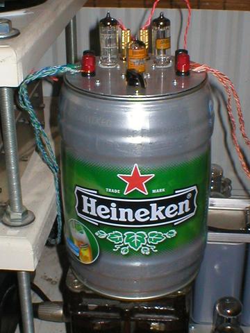

It really is a lovely valve , I use this type in my 'beercan' amp driving A2293 🙂 I rate these along with E80CC and 12AY7 as the nicest sounding 9 pinners that fit the 12A*7 pinout . If the valve has the 'T' for Trustworthy logo it's probably going to be the CV4068 special quality version , early types had the double getter support in keeping with the Mullard/Brimar/GEC tradition with ruggedised valves . As far as I can tell , like the 6BR7 , Brimar was the only manufacturer of these
