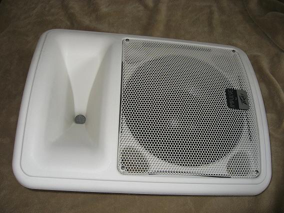

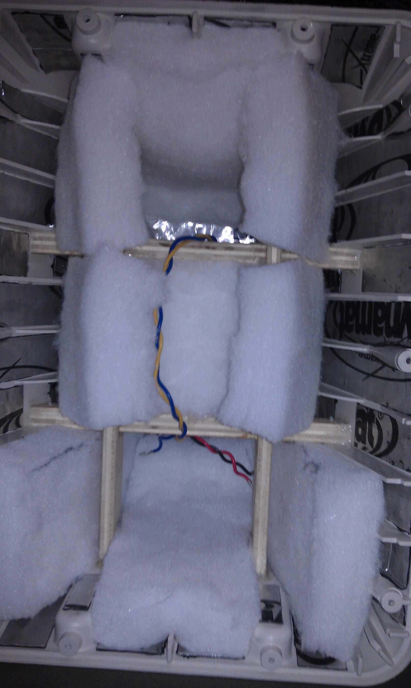

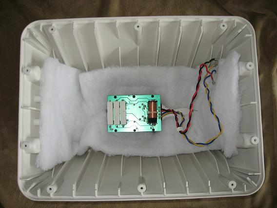

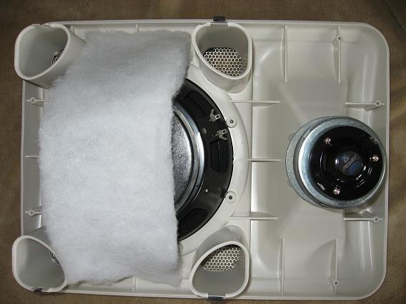

So, I finally got these mostly done and listened to them a bit last night, here is the list of mods:
- Braced the cab with 2 vertical and 2 horizontal plywood braces, interlocked
- Covered 90% of the inside (not the ribs) with strips of dynamat extreme, rubbery bitumen stuff with AL backing
- Replaced the thin plastic rear connector plate with 1/2" plywood, sealed with silicone, mounted the crossover on standoffs, and installed a speakon connector
- Stuffed extensively with 2" thick poly material
- Dynamat on woofer basket and compression tweeter, silicone around woofer/baffle junction on inside
- Sealed baffle to cab with mortite window sealer
- Reversed tweeter polarity vs. factory, tweeter is now in phase with woofer, both have correct phase.
- They weigh a bit over 32lb modified, and look identical to stock aside from the rear plate.
This took around 30 hours of labor, working a couple nights a week on it for a few hours a time. And I'm a bit slow, lol.
I was a bit nervous about how difference this would actually make, considering the time spent and delays to the overall project. As discussed before, they sounded pretty good at low volumes but distortion increased rapidly at higher volumes, clearly due to cabinet vibrations. Well, my fears were unfounded, the improvement is massive. They now image at 110+ db like they did at 90db. They are dynamic, musical and clear/revealing at high volumes and low. Very little vibration can be felt in the cab at high volumes and there seems to be quick decay, no ringing. They actally smoke my venerable Klipsch CF-1's everywhere except for bass below 100hz when used without subs. I'm using an analog PEQ to cut bass to crossover to the subs, these are fed by a full analog chain after the usb interface (DAC) out of a computer.
The swap on the tweeter polarity (and possibly everything else) has made a huge improvement in the frequency response of the speaker, they were waaaay too harsh and sylibant in the upper midrange (around the 2200hz XO), where I was running a major PEQ notch, they were unlistenable without it. Now I have been able to go to basicly a flat eq without particularly bad behavior. The upper-mid lower-treble still has plenty of punch when needed but is not boosted un-naturally. They could possibly do with a bit of a boost in the mid-upper treble.
Only issue I'm picking up on is a subtle nasal quality to vocals on most modern popular music. I can't tell if this is due to a FR issue, or if it's due to the speakers just being very dynamic and bringing it out. I doubt it's induced distortion. The upper midbass on these has a ton of punch when called upon, such as with lower range distorted electric guitar, there may be a bump around 300hz, may take a hair of a cut there. I do have the subs crossed rather high, but don't have any issues with chesty sounding vocals.
Overall I'm extremely happy with how these are turning out so far. I'm trying to put together a portable PA system for house parties, tailgating, etc, that stands apart from normal PA equipment in sound quality, approaching mid-high fi quality. Getting there.

Not a great pic, but you get the idea:
