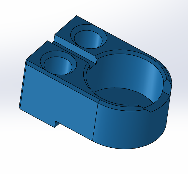

Thanks for the replies. I DID see that eBay listing, but the dude wants $75 for each HALF of a sensor, which quickly becomes $300 for a machine. AND, it isn't even the same part # as listed in the Studer A810 service manual.

Do you have a sample part that could be drawn and copied?
Do you have (or a friend with) CAD capabilities?
Do you have (or a friend with) a 3D printer.
Do you have a local 'Makerspace'?

What´s it used for?
An end or broken tape detector?
Part of a reel or capstan speed controller?
Maybe you can mod Tape Recorder to use some kind of optical detector to detect/trigger whatever´s needed.
OR you may fabricate an equivalent bobbin holder out of a small piece of Acrylic or ABS sheet: top - bottom - separator
You cut-drill-glue them together, glue bobbin to top nd bottom or drill themso you can "embed coils as in original part (not sure about available space) and drill small "guide holes".
I guess this part slides up-down on two polished/chromed metal guides for fine adjustment.

It is to be used as a tension sensor on my Otari reel-to-reel tape recorder. It senses the position of the existing tension arm in order to control the holdback/takeup tension. I am woefully under the delusion that I can make and retro-fit a reel servo control for this machine so it can handle tape like the big boys (Studer and Ampex) do.What´s it used for?....I guess this part slides up-down on two polished/chromed metal guides for fine adjustment.
I sent you a PM. That's the best pic I got; the only other guideline I have is the pot core/bobbin datasheet:I can probably do you up a set out of milled nylon. Can you provide more pictures/dimensions?
https://product.tdk.com/system/file...e/ferrite-acc/data_sheet/80/db/fer/p_14_8.pdf
The spec helps a little. The coil is actually 14.3mm x 8, so making that mounting hole would probs need to be 14.4mm, depending on the fit.
The real issue is the spacing of those two pin sleeves in relation to themselves. You would have to either take the measurements yourself (with calipers at a bare minimum) or send the assembly, with coil, to me to measure.
If you want to go the printer route, just come up with the best measurements you can and I'll implement them in an STL file, and you can print one out. If it doesn't fit, I can tweak the dimensions and re-STL-
