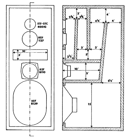

I built a pair of the HI Fi Answers R50 rip-off in the 70's and subsequently made new baffle boards because the speaker units appeared to be too far apart - a rising glissando from an orchestra's violin section gave the impression that it was floating upwards! I submitted the mod and it was published (earned me a whole year's free subscription;-) and I received positive feedback from others who applied the changes. Nothing as drastic as moving the TL port below the 139. The oblong port became a round port beside the lowered 110 and the tweeters moved down and sat beside one another above the 110; the baffles were mirrored right and left. The other modification was to remove the flanges formed by the front side edges of the cabinet so that they were flush with the baffle. This kept the violin sections firmly seated at all times! If anyone was going to play around with the design today I don't think two tweeters are any longer necessary - today's scandinavian offerings more than exceed the T27 and 4001's combined ability.

Yes something similar has been going through my mind recently but with the mid and treble driver in their own enclosure sat on top of a TL enclosure. Something LS3 5A came to mind so we're on the same track but I reckon there are better mid/treble combinations available now than the ubiquitous B110/T27 and for less money too. I think I'd stick with the good old B139 though for the TL cab as I can't think of a modern equivalent that would give the same bang for the bucks.
Incidentally just like Sreten suggested I repaired my IMFs with a new pair of Coles units and I've been very happy with them 🙂
- Plans for TL Cambridge R50s/HiFi Answers version
