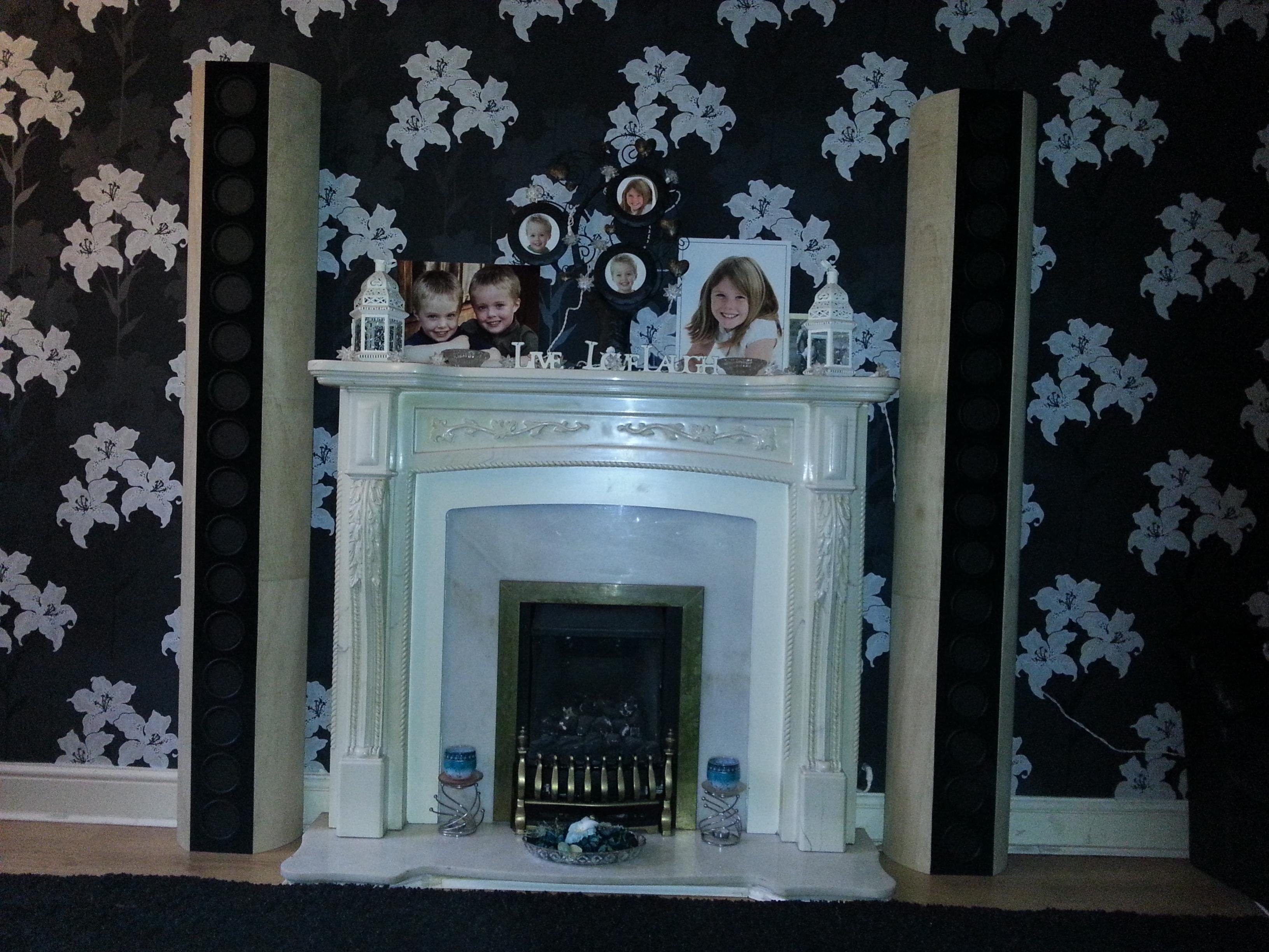

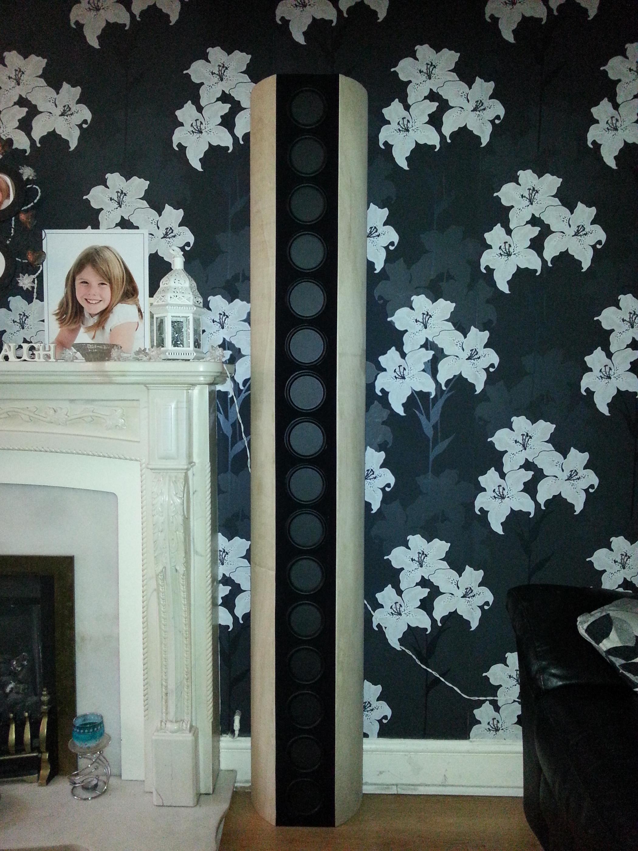

The above photo's are of my latest ( 3 years) speakers.
They are line arrays with some unique features:
(1) The driver is a fab little creation, a custom 4.5 inch Neo motor, Bending Mode Radiator ( BMR) with an amazing performance and almost zero beaming ie its within + / - 2 dB over a 160 degree radius over most of the audio band!
(2) I have designed the cabinets for On-Wall mounting and voiced ( with Eq) the speakers to take advantage of boundary reinforcement.
(3) The curved birch ply cabinets are shaped externally and treated internally to enhance the unique BMR characteristics.
(4) Zero crossover or any passive components at all.
(5) Only some DSP Eq ( applied at source in JRiver media) required to voice the speakers.
(6) All the usual Line Array benefits of high sensitivity, low distortion, detail and stable SPL independent sound stage.
Plus they don't take up any floor space and look cool!
