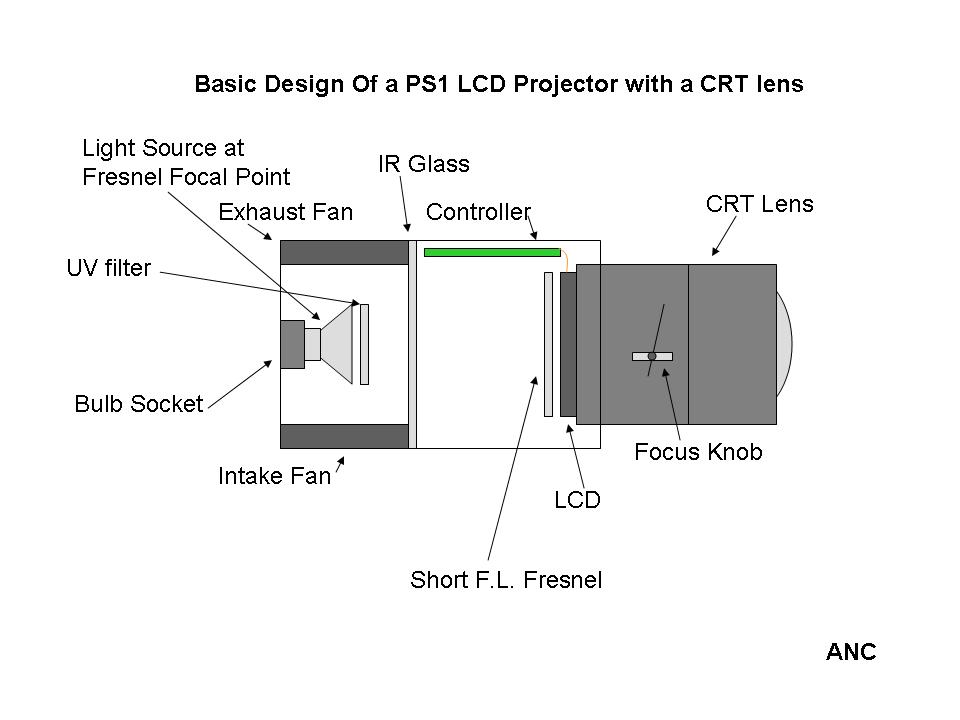

For a basic design with a crt lens you'll need - light, rear fresnel, lcd, fan, crt lens.
Here - I quickly drew up a design for a ps1 projector. Its not the best, and can vary plenty, I think some more senior and experienced members can fill you in on the details, or a better design, lol.
Once again - Good luck!😀

just one question about the design
short fl frensel - how much is short?
i got a rogers page magnifier from office depot ( from when i built the tv projector ) will it do ok? it doesnt say what fl it is or anything

fresnel focal lengths
Most people use 220 mm or 200 mm focal length for their lower fresnels. Those work well for even 17" LCDs. But for a small screen like the PS1, I would use the shortest focal length fresnel lens I could find. The shorter it is, the closer you put it to the light source, so it will intersect more of the light.
You can measure the focal length of a fresnel lens, just like any other positive lens: Hold it smooth side to the sun, move it until you get the smallest image (like cooking an ant with a magnifer), then measure the distance between the lens and the image.
If the office supply store has fresnels rated in "power", then you want the highest power. (Like 5X) If they are rated in Diopters, highest = shortest focal length and:
Diopters = 1000 / focal length in mm
Watch out for page magnifiers that have a little "super magnifier" circle in one corner. That has to be removed when you cut out the center part you need for your projector.
