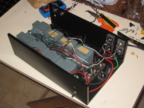

Just had a go at measiring current. I had a couple of 15W resistors here, and I borrowed some more heavy-duty ones (25W and 30W) from the Elec Eng. Dept. and gave this a go, using just one of the transformers and with the resistors across the secondary, adding more resistors (in parallel) to lower the total resistance and hence increase current.
With no load the total voltage across the two secondaries together was 19.1 VAC. Here's a small list of load resistances and voltages measured across the load:
With 15R, 18.1 V
With 7.5R (2 15R resistors in parallel), 17.1 V
With 6.5R (2 15R and 1 50R resistos in parallel), 16.4 V
With 4.67R (2 15R, 1 50R and 1 16.4R in parallel), 15.4 V
Only in the last case was there any measurable warming of the trafo - and even then only about 5 degrees C after 6 or seven minutes or so. No other signs of distress from the transformer (although the resistors were in danger of causing a china syndrome...
I should add that these are old transformers - the issue is not how cheap they are, since they are free, but is rather how many it would be polite to help myself to. The EE dept. uses this stock of used parts and junk for various other people and purposes...

Look at your data.
15.4V across 4r67 is an output of 50.8VA.
The unloaded output is 18.1Vac. Did you check the input voltages during the tests?
The regulation at 50.8VA is 17.5%. For a 50VA EI, this is probably a little high but about right.
This 50VA transformer was 5degC warmer on the outside. What were the temperatures inside? That's where the problems will start.
If there is room to replace the secondary using a thicker wire then you will improve the regulation and slightly reduce the heat generation but don't expect any more continuous output current.
Now to some ClassA data.
If your single channel amplifier is biased to 1.3A and draws another 50mA for the voltage amp stage then the total continuous DC current is 1.35A.
The AC rating for this is ~ double the continuous DC requirement, i.e. ~2.7A continuous.
At this current the transformer will run at the manufacturers maximum rating.
It is usually recommended that the transformer operate at <=50% of maximum rating for continuous use. That brings the AC current ability up to >=5.4A
Performance is generally improved by using a larger transformer and some recommend 6times the maximum output power, others recommend upto 10times maximum output power.
6*25W gives about 300VA for a two channel transformer.
10*25W gives about 250VA for a monoblock.
Three of your 50VA transformers should work for a monoblock and should approach the performance of a correctly specified low regulation transformer.

The F5 is biased at 1.3A, the primary task of the powersupply is to deliver that current while keeping the rails at 24Vdc.
Your measurements show that your EI transformer is able to do that, without overheating.
Any transformer will sag under load, your comment on the size of your EI's and the measurements illustrate that their VA rating is not tiny.
Four EI transformers of 75VA each may not be able to deliver as much current as a 300VA toroidal, nor keep the output voltage as rigid, but you can compensate that for peak transients by having ample capacitance after the rectifier bridge.
Mr P just grabs a toroid from his Lost Ark warehouse, at least 2.5 times the idle dissipation is the standard practice.
The VA rating of the transformer is not all-important, for example a picture of a French Audioanalyse Class A power amp.
This model does 50W Class A on a 160VA toroidal per channel, the amp was on display for years at the museum of modern art in New York.
The bulky 100W model of that brand run on 330VA transformers and 200.000uF lytics.

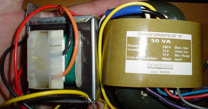

The 75VA was just a number, 300VA divided by 4.
Regulation is (Vu-Vl)/Vl , Vu = unloaded voltage, Vl is loaded voltage.
(19.1-15.4)/15.4 ~24 %.
Whatever.
You could measure the weight of the transformers and the secondary winding diameter.
Numbers for modern block type transformers are in the whereabouts of :
50VA-2lbs, 75VA-3lbs, 100VA-4lbs, 150VA-5lbs, 200VA-6lbs.
For a reference, a picture of a 50VA block transformer and a 50VA fancy R-core.
The block one has a width on top of around 2.75", each weighs ~2lbs.

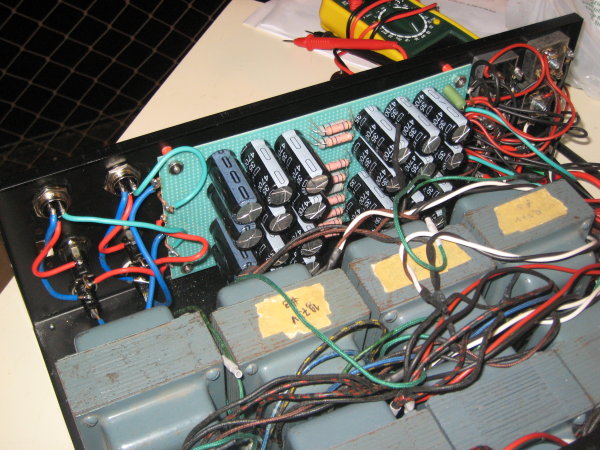

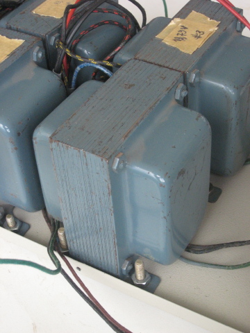

Well, I don't have a scales handy, but four of them (screwed into a metal case) weigh more than a 5 kilo bag of rice, but seems to be less than less than two such bags. So somewhere over 3lbs each seems a reasonable "guess-timate". Of course,these aren't "modern" transformers at all. (The connecting wires have the old-fashioned woven insulation around them...) I've attached a photo of one of them.
My initial suggestion was 2 for each rail.
For the whole amp? or for each channel?
Nigel
2 for each rail, makes 8 transformers for stereo.
They should be close to 1kg each without the covers, corresponds to the 50VA number.
Heavy, would be four times as much weight as a single 300VA toroid and require quite a chassis size for a stereo 25W amp.
jacco vermeulen said:2 for each rail, makes 8 transformers for stereo.
The good news is that I stopped by the Elec. Eng. dept. and talked them out of four more of these transformers and four bridges, so I have the eight necessary. 😎
It certainly will be heavy; next job is finding some kind of box to fit it all. I will definitely use separate boxes for amp and PSU, possibly more than one box for PSU alone... I have some capacitors which I should be able to use to try this all out. It seems to me to be worth trying this to save a little cash - if not successful I can always order the big transformer and return this stuff to EE.
Yet another query - If I use the trafos to power each channel separately, do I need twice as many capacitors as using one PSU for both channels together? If yes, would I be better off using the trafos four (in parallel, after bridges) to each rail and using the same capacitors to smooth everything together?
Of course this may be decided for me when my wife sees the monster PSU I want to put in our living room...
Thanks again.

Sorry if I'm being obtuse, but this still isn't clear. Nelson's site shows a total of 120000 microfarads for a two-channel PSU. Are you saying each monoblock (powered separately) needs 120000, or 60000?
I like the idea of monoblocks - I find your reasons convincing. I think the right model is two PSU boxes, one for each channel, down on the floor reasonably out of sight, with the amplifier in full view (since it needs to be well ventilated). Whether my wife accepts the idea of two ugly black boxes instead of one remains to be seen.... Also depends on which configuration I can think of the better design for.

Update...

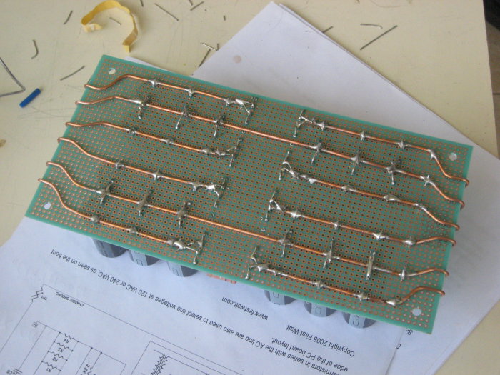

For anyone who might be following this, I have spent the evenings over the last week or so putting together the PSU for my F5. Not finished yet (no caps in it yet, for instance) but I have the first stage done. Following suggestions made above I have eight trafos, and eight bridges, all apparently working properly, and putting out very similar voltages. Picture below. As usual any comments and criticisms are very welcome.
I have gone with one box for the whole PSU, but in fact it will contain two entirely separate supplies, one for each channel. I would have preferred two boxes in some ways, but was unable to find anything suitable size-wise. (I am still hoping to do the amps as separate monoblocks, but it isn't clear if this will work out or not...)
One simple question: I have a blue LED on the front panel, which I am powering off the 220Vac input with a power resistor and a 1N4004 diode in series. (The diode is to help a little with the "work" of dealing with the ac - a suggestion from a friend...) This works fine, and the brightness is about right, but there is a barely visible flicker to the LED. I read somewhere on the net that you can use a capacitor (presumably across the LED itself) to help with this (presumably by smoothing out the "bumps" from the ac), but I couldn't find any size recomendation for the cap. Did I understand this OK? Can anyone make a suggestion of value to try? If I do this can I keep the same resistor, or will I have to increase resistance a little?
Thanks.
Nigel

Another update, for anyone who's interested.... I spent the day finishing the power supply, which was loads of fun. The only way to put together enough capacitance was to use a total of 24 capacitors at 4700 microF, 32V each.... Sounds insane, I suppose, but it was the only option available - the "big" shop had 15000 microF available, but they were 24reais each and they only had three... These others were only 3 reais each (about US$1.30) so pretty cheap, and not a disaster if they don't work out well. (Although I have no reason to suppose they won't be as good as any other generic part.) I used some heavy copper wire to provide better rails and earth on the back of the board, to try to compensate a bit for any downside from so many caps in parallel. (Pic below)
The final result is as heavy as h***, and produces +/- 25.1 Vdc without load, which sounds just about right to give me +/- 24 Vdc in use.
I haven't put thermistors in the PSU yet, since I have been unable to find the CL60 type recommended. I have a thermistor I pulled out of a PC supply which is marked "NTC 5D-20".... Can I use this for either of the parts shown in the circuit? If I understand correctly the first thermistor is principally there to diminish inrush current, which is probably less with the EIs I am using than with toroidals, so maybe the part is unecessary anyway...
And now on to the case(s) for the amp itself!
