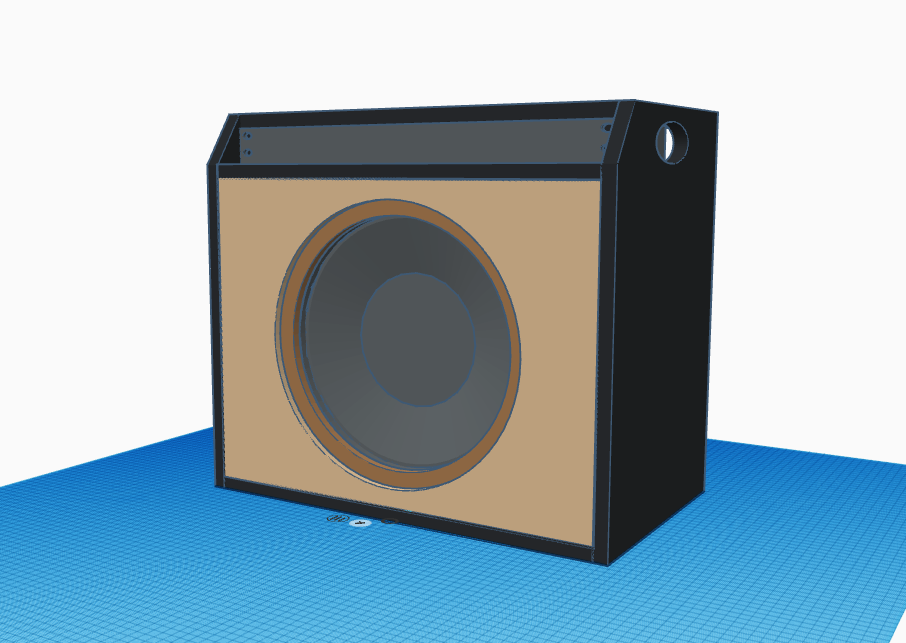

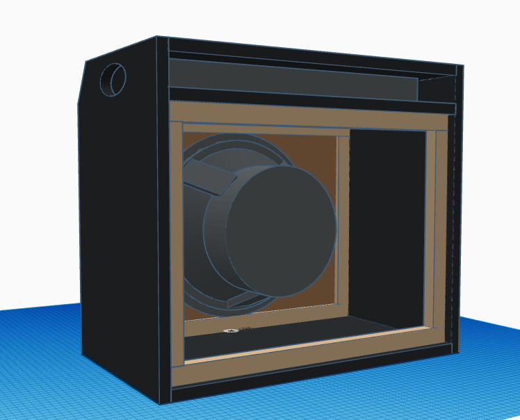

I've been asked to build a cab for a friend, which is something new to me. It's for an electro-acoustic guitar so it's kind of a mix between a classical cab and a powered PA speaker. It will use a 12" full range vintage goodmans and a DIY amp housed in a 19" 1u case. The amp has a class D output amp so it's quite cool.
I've drawn a preliminary sketch but I'd really welcome suggestions from people more experienced. 🙂
The pics attached show most of it, some explanations:
- the cab will use all 15mm baltic birch plywood, except the front cover to which the fabric will be stapled, which is made of 8mm.
- it will be painted with black warnex (same as duratex in the US).
- the driver will be rear mounted.
- size is 515mm*452mm*300mm (W*H*D).
And some questions:
- the back will be removable, but is there any sense in making it in three parts, to have the possibility of an open back ? It might be useful if used with an electric guitar and a head amp ?
- should I have something to protect the driver ?
- should the driver be somewhat recessed into the baffle, like 5mm ?
- should the driver be centered or should I rather put it a bit on the side ?
- I plan to cut handles on the top of the cab, near the amp. Would it be enough ?

Oh, I see now. So you are making a combo amp out of an old cab.
Why not.
Typically the driver has some protection. If you are using grille cloth, then recessing the baffle and making a removable fabric grille with it's own frame that is flush to the front edge is one technique.
I like centering.
Only trick here is to measure centre of gravity BEFORE installing handle. Carrying a cab by handle when it is permanently leaning away from the handle is infinitely annoying and conducive to scraped legs.
