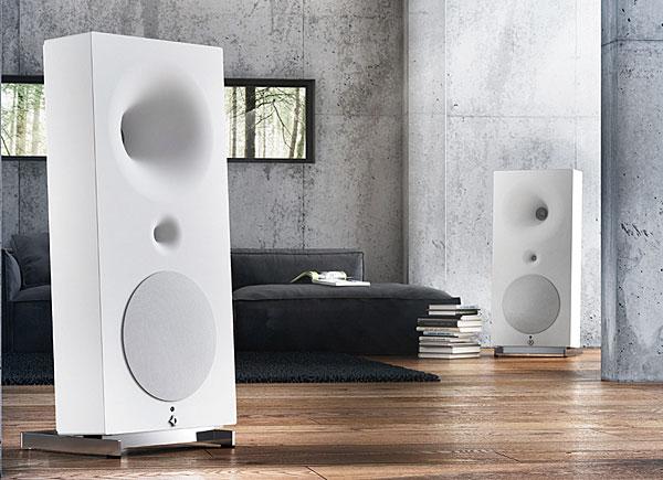

I’m in the early planning phase of a DIY speaker project inspired by the Avantgarde Acoustic Zero 1 XD and Zero iTron. While I don’t intend to clone them directly, I’m fascinated by their compact, active horn design and how they blend traditional horn acoustics with modern electronics.
My goal is to design a 3-way horn loudspeaker that reflects this idea — but with my own twist: a focus on analog signal integrity in the mids and highs, and digitally controlled, active bass using Hypex DSP.
