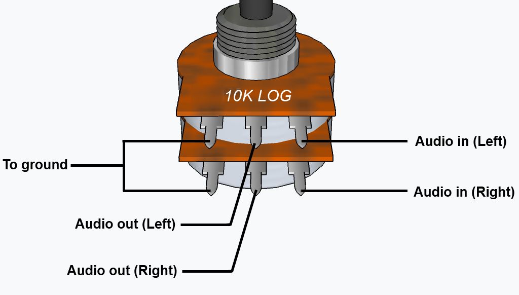

Planned Stereo Build
See attached image.

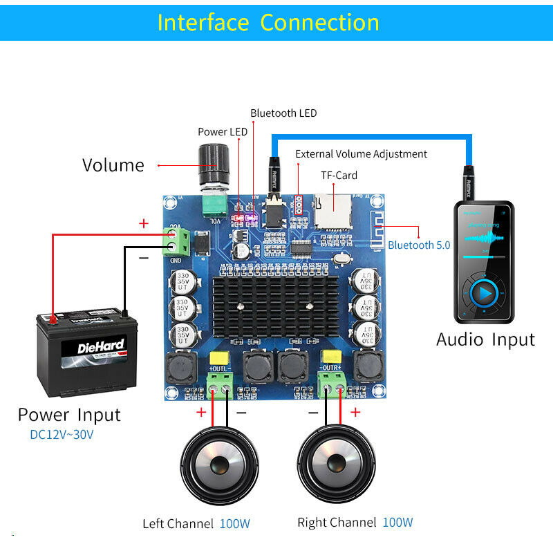

My 1974 Cassette player unfortunately just died. It was so great with audio but it fell about a foot to the ground. It spins the tape and all that, but the audio is screaming. It's ok, I will still put the tape player in there and give it the ability to turn.
But, now that I will not have any cassette audio I'd like to put a Bluetooth speaker in there. Not sure how I could make it run the VU meters, but it'll be easy to get in the box.

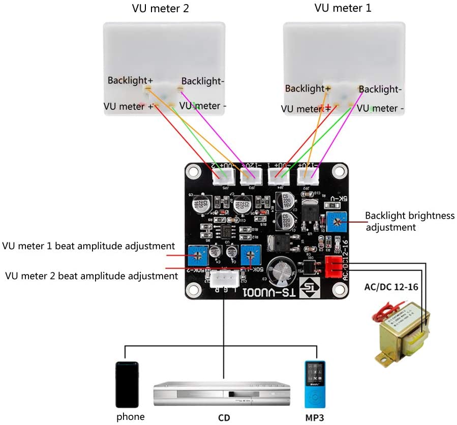

Ok heres the update:
I currently have an audio splitter plugged into the input of my speakers. One aux port leads to the PC's headphone input. The other runs to the VU board.
Luckily this does work, but it has a few issues. The reactivity of the VU meters is solely dependent on my computer's volume. I have tried changing the speaker's volume on the back, but this does not affect the VU meters at all.
On my meters, there is an adjustable stop for the small ticker. This allows me to essentially keep the VU meter from staying very low, but the caveat is the meters do not react as much because they are already set to a high VU level.
My trouble is I do not want to keep my computer audio at 100 all the time just to see my meters work. The only way to truly adjust my volume would be to turn the knob on my speakers.
This will surely still be the case with your option #2, since you will have merely moved the location of the volume control?
I would have expected you to adjust the VU board's sensitivity to match a sensible output level from the computer, after which the volume is controlled by the powered speakers' volume control.
Have you tried adjusting the VU meter amplitude adjustment controls?

Try to connect the VU in parallel with the speakers with a dropping resistor. Use a trim-pot to calibrate or to find out the needed value.
This way the volume knob on the speakers controls also the VU like on ordinary amps.
Perhaps there is already a series resistor on the VU that You can change for a lower value.
Ok now I've seen the board after the last post. It has trim pots, so it should be easy. Make sure Your speaker amps have a common ground and don't work in bridge mode.

Just adjusted them and this is proving to be the best fix currently. I can keep my pc in that 60-90 range and they move a good amount. Then I've been playing with the speaker volume to be proportional.

So with my audio switcher still in hand, I wonder if I could make a small Bluetooth speaker that also has an aux port. The aux port would allow the VU meters to still be active even on a Bluetooth speaker.
The Bluetooth function would only exist for ease, sorry aux cords.. you're not always easy 😀
