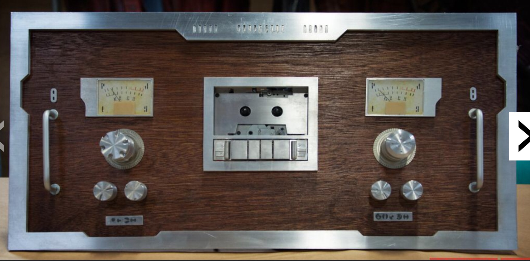

So I'm sure a few of us have seen Guardians of The Galaxy. Remember his cassette deck on the ship? It's always been a deck I wanted to try and recreate. Here's what I'd like to do and I'd love feedback and tips from anyone passing by, I'm no expert on audio devices.
I'd like to essentially make a deck that plays my audio from my computer while displaying the VU level and one other dial I have not decided on. If it could also play a cassette that would great, but if that's too much I'll just place a cassette player in there that can spin a tape. My question is how can I use modern/cheapish products to monitor VU and other levels, display them onto dials and work well, and have a knob that just controls master volume. Basically, I'd love some recommendations as to what I can buy/make to go into a themed box (basically all it is, a fancy box). Thanks for reading and I'm looking forward to learning a few things.
