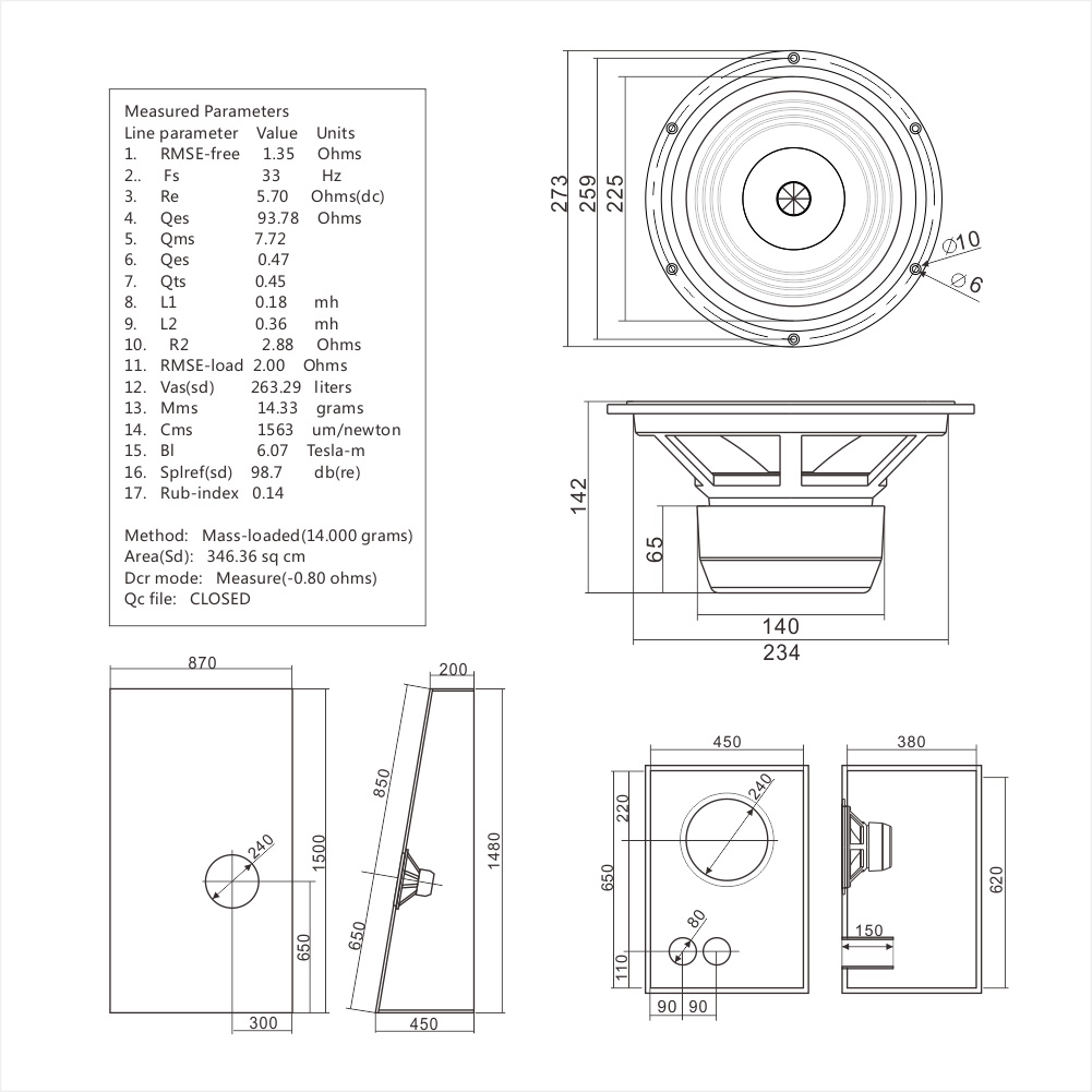

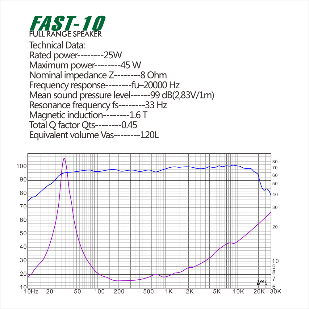

I have seen it suggested that the 10in Lii Audio drivers (datasheet for the ones I have attached) would be well suited to an Onken project - a not so mini variant of the Planet 10 miniOnken designs;
I've played with this calculator;
HiFi Loudspeaker Design
and it all looks good with an overall calculated SPL of 93.6 (dB 1W/1mtr) (which my only concern because of the flea-power amps I currently use). The bottom end -3dB point is calculated to be at around 30Hz.
Thoughts?

It looks like that is so.
400 litres, F6 & F10 both in the low 20s (F3 is meaningless to humans)
But it can be squeezed into a smaller box:
300 liters F6/F10 still in th elow 20s
250 liters, F6 drifting into the higher 20s
200 liters, F6 now in the upper 20s, a bit more midbass punch
150 liters F6 into the low 30s, F10 high 20s.
I’d look at the 200 litre box. Benefits in terms of material cost, getting the box not to move, and the midbass punch all appeal.
How is the SPL different than specified. Where are you loosing so much? This thing should wail with a watt or so.
Note that that calculater is for an Onken, not a miniOnken.
dave
