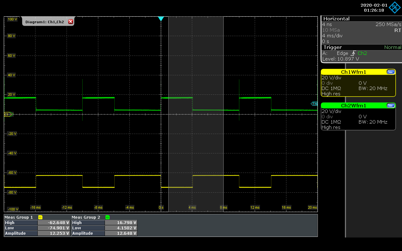

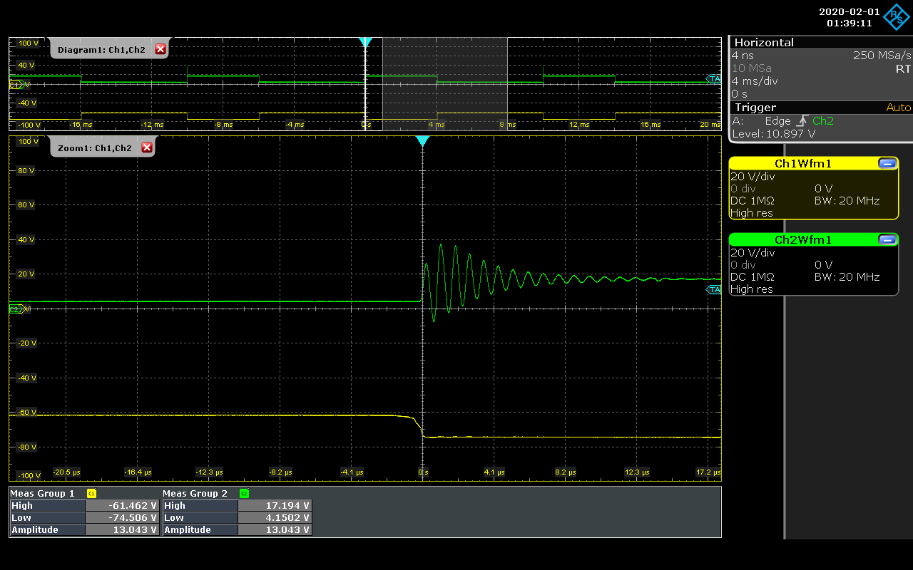

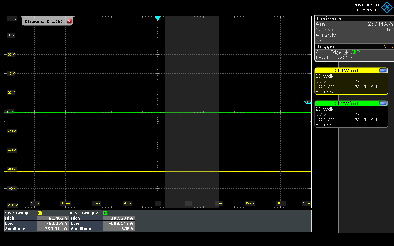

I'm working on getting the outputs installed and the fan, but for reference here is what the gates of the output fets look like with just a 1nf cap on each bank. There is a little bit of ringing on the rising edge of the high side, but I'm not sure if it is enough to be concerned or just a scope artifact. I'm using the negative speaker terminal as my ground reference with about a 6 inch cable to get to my scope probes.
One thing I do notice is that the on/off times are not symmetrical for the high side and low side, but again without the outputs in I'm not sure if that matters.
