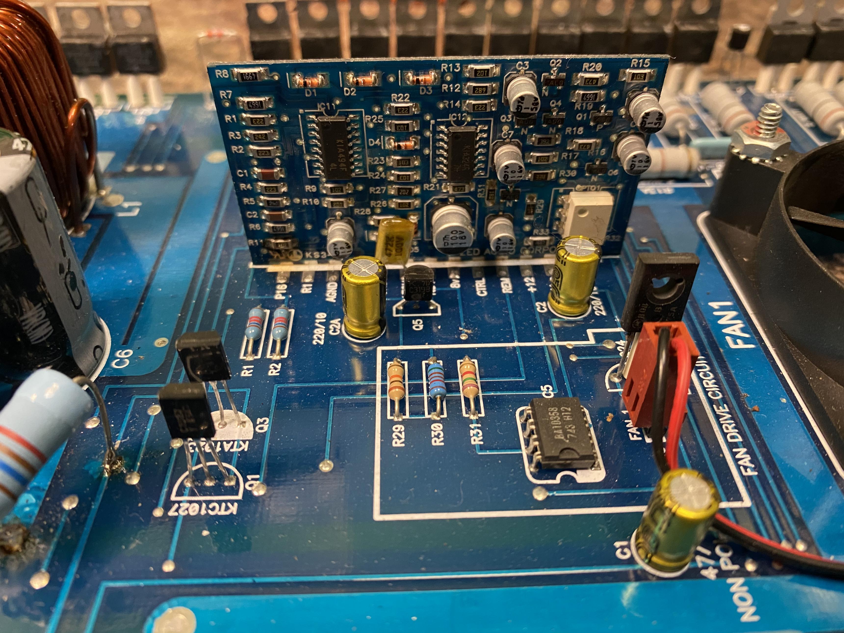

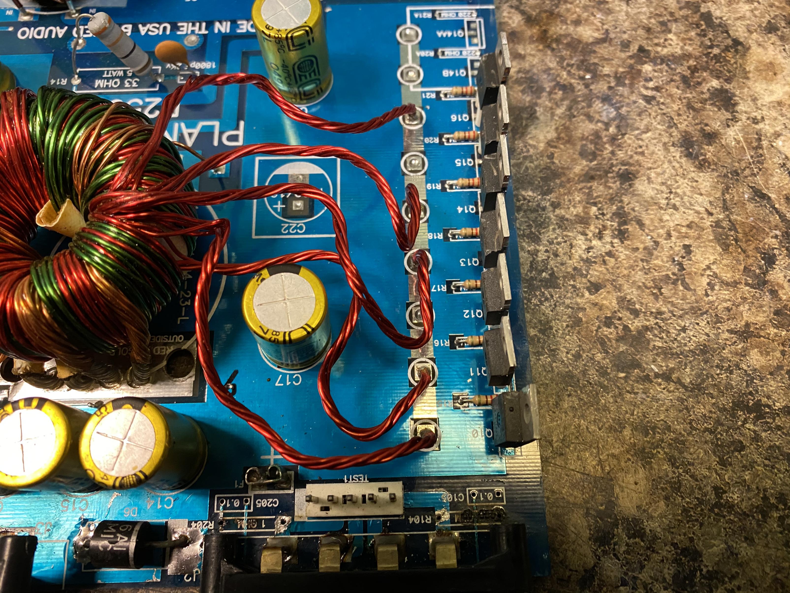

Could you post a picture of the entire board? I worked on something very similar and it did not use an emitter follower pair to drive the Power Supply MOSFETs. Just a resistor and a single transistor per bank.
That would likely struggle to drive 3205's, I think.
Ok before I put the 3205’s with 47 ohm gate resistors in their amp here is a picture of the entire drive circuit for the power supply .
After seeing these photos would you still proceed with the 3205’s ?

The 3205’s didn’t work in this amp .
It worked on the bench but in a car it lasted about 5 mins and blew the power supply fets .
I talked with Zed audio and he said I shouldn’t have switched the gate resistor value in the amp . I should have left the 220 ohm gate resistors .
Do you know What fets I could use with the 220 ohm gate resistors in this amp ?Since the BUZ102’s are obsolete
