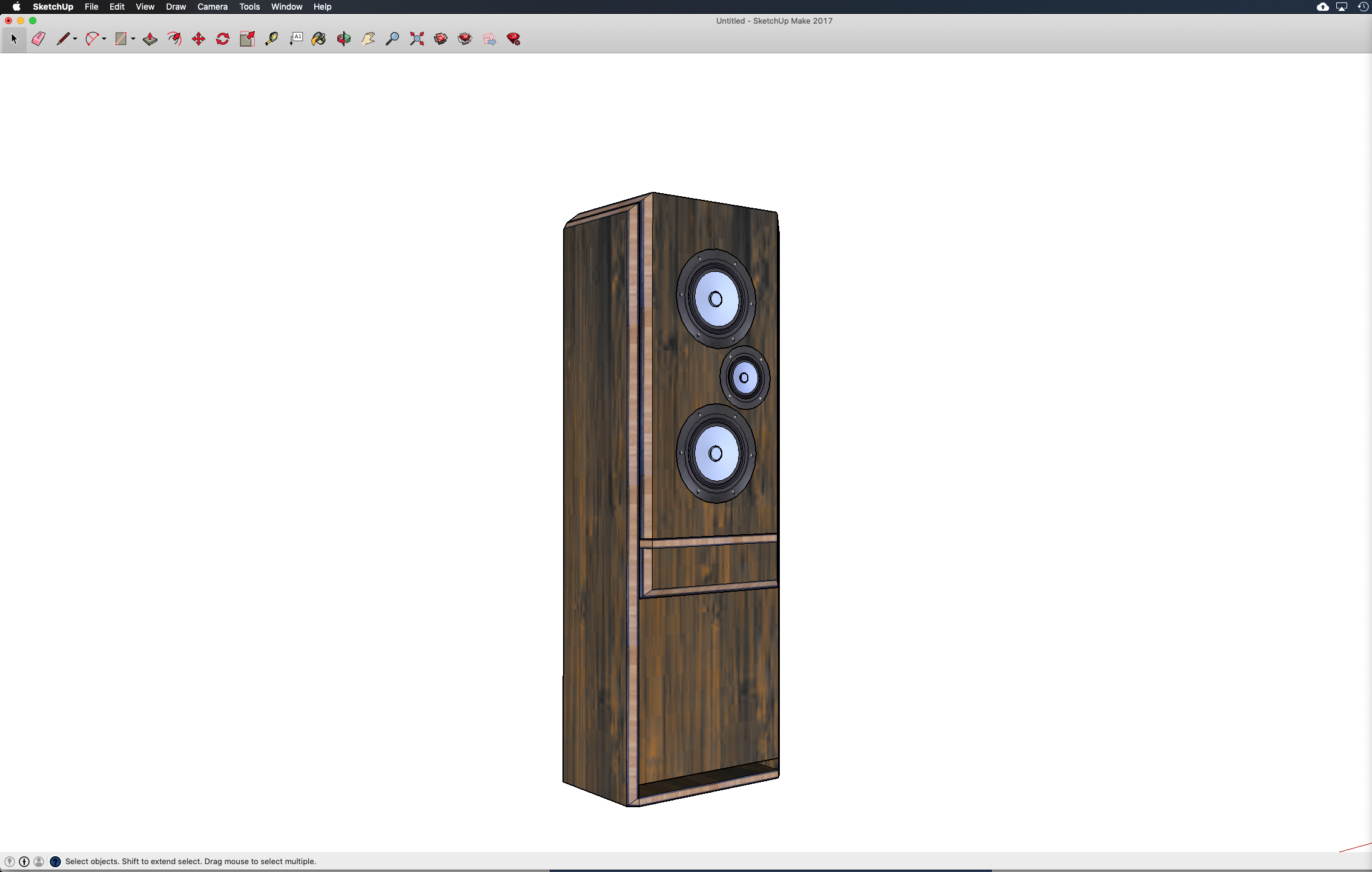

Thanks, Quattrofish. I played around modelling these for weeks before I decided on a final version... Even long after I had the materials...
First of all, getting a perfectly flat sheet of bamboo was impossible... and, it's insanely heavy (90lbs a sheet) and stiff - but of course thats a good thing when you're all done
Also, when birch chips out, the chips are small and easily hidden. When bamboo chips out, it follows the "go big or go home" kind of attitude... at least from my experience.
I got my bamboo from West Wind, but I'm unsure of brand that made the bamboo sheets. The only thing I see is the style is called "Nighthawk"

I’m gonna guess from the price that this bamboo is not in the class with the best properties for speakers. When we got the stranded variation (Plyboo, also available in Victoria, Chris?), was closer to $300 for a 4x6 sheet.
It may have decreased in price since we last used it, but not likely that much.
The 3 basic qualities of plywoods lies in the nature of the outer veneers. From poorest to best, a laminate of horizontally arranged pieces of bamboo, a laminate of vertically oriented bamboo, and stranded/fossilized that uses bamboo strands held together by some sort of epoxy, ie akin to composite construction using fibreglass. I imagine that an even better material could be constructed using multiple layers of the outer veneer layer. Hemp fire could also be used as a basic substrate, it has amazing fibres as well.
dave
I can say with certainty there IS better bamboo out there... but I could not get my hands on any at the time. NO ONE had bamboo sheet goods in stock... even up island. I will say however, I still found the results better than using birch ply. With double thick baffle, cross braced, etc, these sound like knocking on granite.... however, I still will use something less troublesome in the future.

I love the look of the stepped baffle on these, and I am wondering if the designers could chime in on whether they expect any impact to the sound?
I will probably stick with BB ply and veneer. Might do the step with hardwood to match. I think I'm entering a walnut phase...
If i knew what you meant by “stepped” i might be able to answer :^)
If you are talking about the heavy chamfers, Olson showed that a rectangle with heavy chamfers resembles a sphere in terms of BS transition response (ie smooth). B&W did a lot of work that shows the value of a tear drop for minimim external diffraction. In plan view the trapezoid miniOnkens resemble a teardrop, and at the loe frequencies involved the size of the wavelengths means that it acts like a teardrop leading to decreased diffraction, smooth 2π to 4π transition, still buildable with flat sheets, and, personally, i think they look really cool.

In this case, I mean the way that Danyo layered his baffle. I might do something similar, and am wondering if this departure from the plans might have an impact on the sound. If I understand his design, and assuming 12mm material, the flat face of his baffle is 48mm narrower than the spec due to the chamfering. I'm not sure if the flat face or overall cabinet width is the important dimension for baffle step or other issues.
