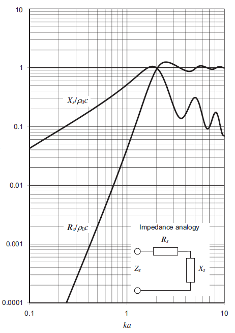

...as the planar is a dipole transducer, with no felt in the front & felt at the rear, will not the frequency characteristics change between front & back sides?
It depends on the acoustic characteristics of the felt. If it is fairly thin and firmly attached to the magnets/frame the acoustic impedance will be mainly resistive even up to high frequencies. The result will be that you would see a few dB uniform loss in the upper frequencies on the felt side of the planar compared to the non-felt side. If the felt is thicker, you may see some additional attenuation with increasing frequency. If the felt has such a small effect on the response, you may wonder how it is able to damp the diaphragm resonances as lowmass mentioned? It comes down to the nature of the airload on the diaphragm(also called radiation impedance) and how it varies with frequency. That, and the fact that the moving mass of a planar is so small that the airload dominates its mechanical behavior, unlike with typical dynamic drivers.
The attached plot shows the normalized radiation impedance for a dipole radiator. It is plotted vs ka rather than frequency so it can be used for any size radiator. When ka=1, the wavelength of sound is similar in size to the piston or diaphragm. So, ka< 1 for low frequencies where wavelength is larger than the radiator, and ka>1 for high frequencies where the wavelength is smaller than the radiator. The Rs curve is the resistive portion of the airload. Notice that at high frequencies Rs is 1, and at low frequencies it is several orders of magnitude smaller. This is why the felt is needed to damp the low frequency diaphragm resonances, because the resistive portion of the airload on the diaphragm is too small to provide any damping. It also explains why the response will be essentially the same on both sides at low frequencies even though it is different at high frequencies. To put some numbers to the acoustic resistances, for high frequencies the specific acoustic resistance of Rs is roughly 400 Rayles on each side of the diaphragm. The specific acoustic resistance of thin (1mm) felt is typically about 100 Rayles.

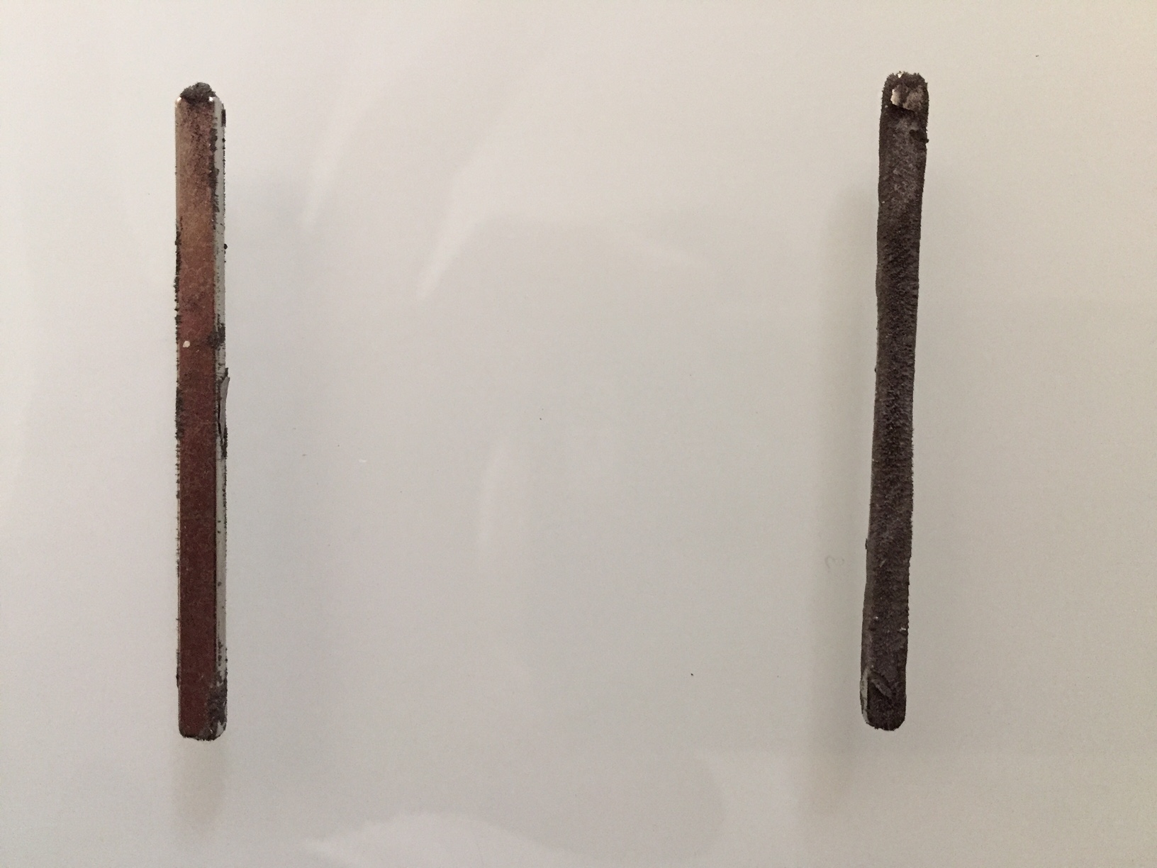

It is a Monsoon planar speaker...which I pulled apart. Now I am planning to change all the magnets after giving them a protective epoxy coating. The only question was the replacement of the felt.

Did you have rust on the magnets?

Lots and lots of rust...so much so I am replacing all the magnets. The rust has eaten into the magnets! So for the new set I wish to coat them with epoxy... MG Chemicals 4223

That is only slightly compromised!
Wow. A perfect example of what happens when you cheap out on magnet suppliers.

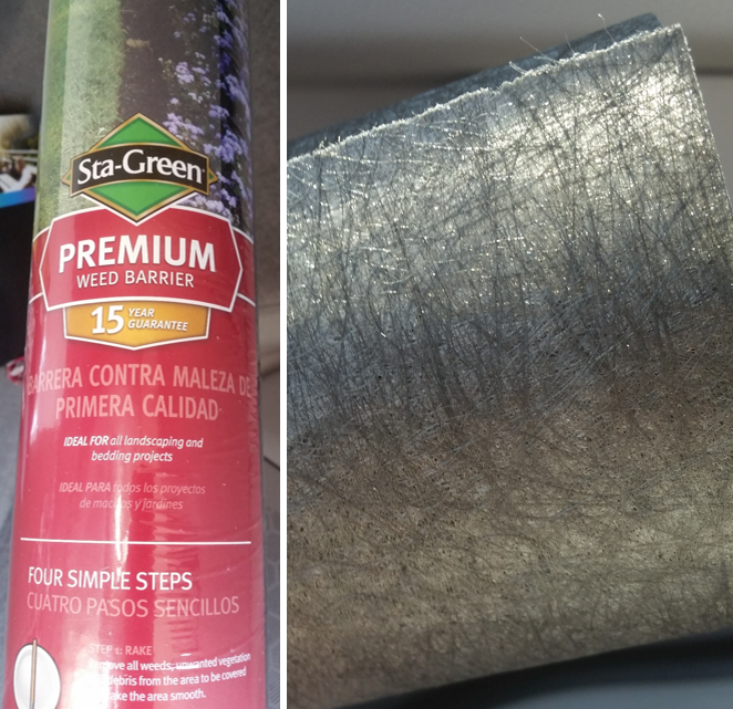

...Felt generally has random fibers that can move, the "felt" typically used on comercial planers is more likley not at all felt but a fiberous mat that is pressed and very thin where the fibers don’t move much at all.
Yeah, it seems most manufacturers use some form of spun-bound non-woven fabric like what is used as filter media in most air filters. This type of fabric is also used for many other purposes like fabric softener sheets, coffee filters, stabilizer sheets for needle work, etc. One source for a suitable black spun-bound fabric for damping planars can be found at the hardware store in the garden department sold as landscape fabric. The particular landscape fabric shown in the attached pic has a suitable 50-60 Rayle acoustic resistance that is nearly uniform over the whole audio spectrum. It is also pretty strong, so easy to achieve high resonance when gluing to frame or magnets.
Obviously acoustic mesh fabric like Saatifil Acoustex is ideal for this application, but it is a bit pricey and not readily available. Alternatively you can purchase silk screen mesh of similar thread count, but you won’t know what the acoustic resistance is until you get it and test it. To a first approximation, the acoustic resistance is inversely proportional to the square of the pore size, so thread count is not a direct indicator of acoustic resistance unless you know the thread size too.
