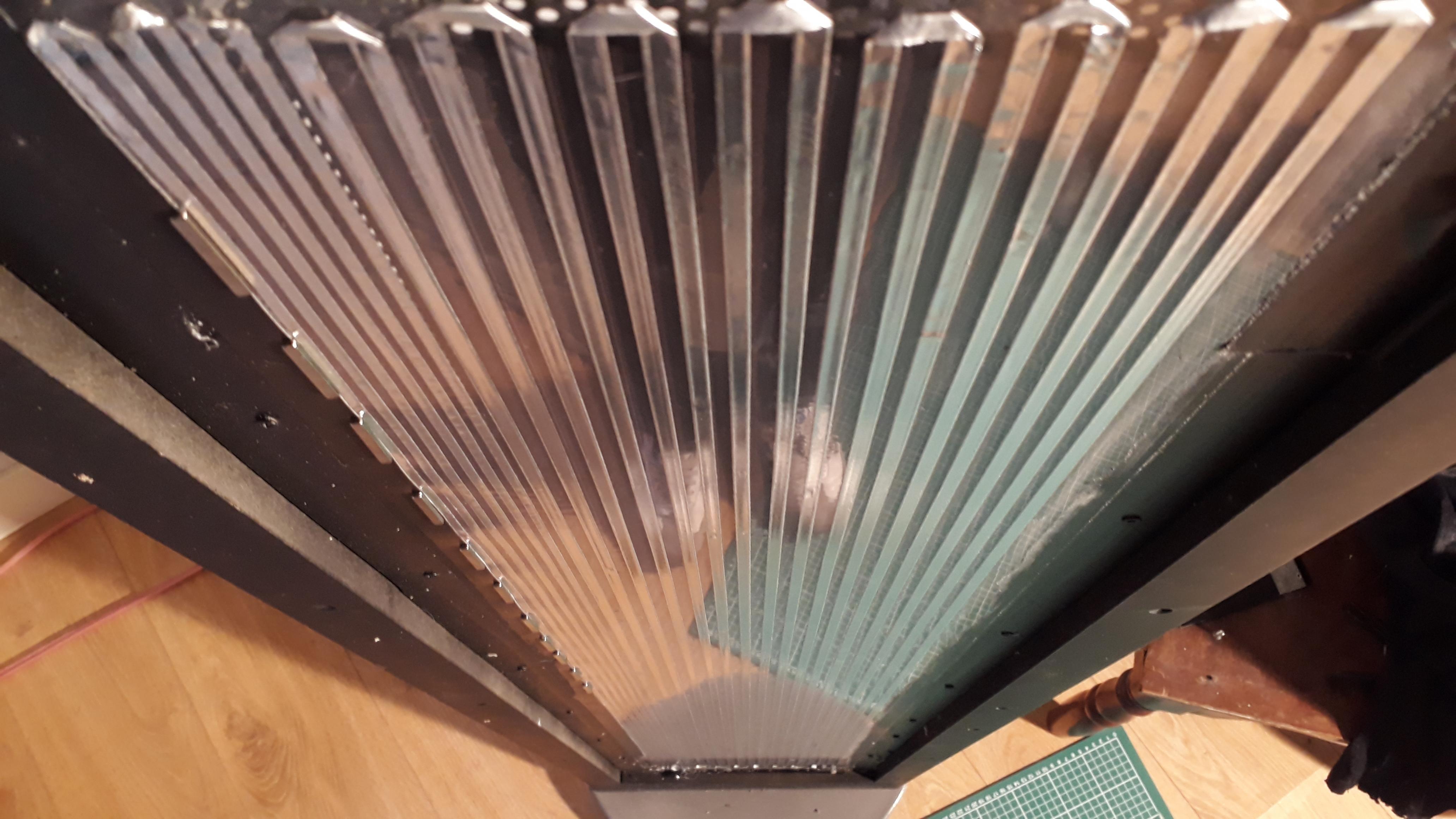

I converted my planar magnetics speakers from wire to foil. since i wanted to replace the foil anyways. to see what happens in the frequency domain once and for all !
The replacement itself 🙂

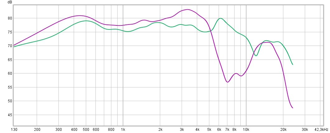

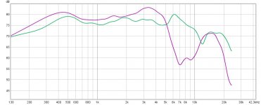

Green is foil pink wire. as expected either increase tension or increase conductor vs mylar to make the top end smoother (upp the breakup frequency by the looks of it)🙂 confirmed 🙂 jeeej and lose some output 🙁 but i already knew that hehe

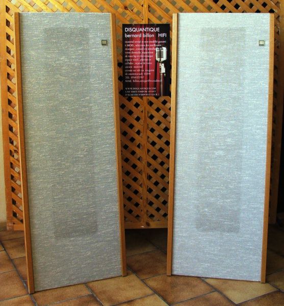

So I had to pull Some All wire,1987.....MG1c Tuff for me to get my head around this sound was around in the 1970s....These have the wire an mylar... facing to the back..
Using My ML CLS an Apogee Stages Speakers as a reference point to day.....like my old conrad Johnson PV2, PV5 Big tone magic tube preamps....these just biger brother of the SMga…
Sound Vary Sweet....can play vary loud with 50 tube watts...Theres a texture...I don't get with the ribbons...or ESLs.....vary quick...lot of fun for sure...heres MG1c what thay look like.....
I think Magnepan well have to come out with a new pr of all wire maggys..hehe..

Shorts possible tension? You can have any tension you want. Apogee is a complete different speaker indeed. A magnepan uses mostly a far bigger surface area then most apogees. So it does not need to have that same xmax. Higher tendion in the foil or wires/foil closer to one and other makes it lose controll of the foil in between rise upwards in freq range . I also wonder with apogee how much tension there is horizontal simce tsome of them where tuned to 40 or 50 hz. Depending on the width of the unsupported foil this says to me it still had quiye some tension. Or it would act more like ribbon with very low resonance
yep your measure shows the basic difference. The large area un-driven sections of mylar when a wire is used are trouble above about 300 hz. make the conductor wider and it gets better.
Make the conductor cover ALL area ( except small slit) and it will be even smoother midrange.
Yes in theory the magnet flux lines are not aligned with conductor as well directly over top of magnets BUT there is drive force none the less. As well there is a better damping effect from the sandwich construction over all area rather than the low self damping nature of the raw, tensioned mylar.
Sure there is some loss of sensitivity BUT in my experience its worth it.

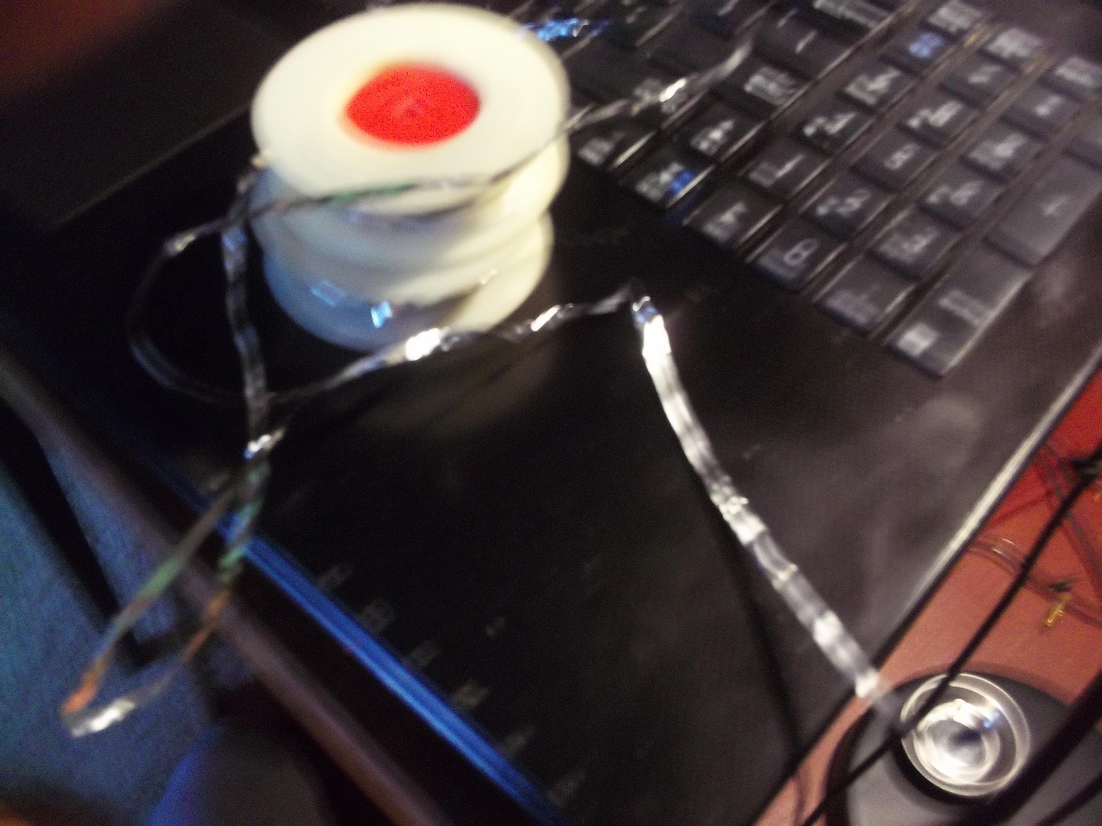

Over 5 years ago I got this QR foil....for repires an to put this foil in a pr of MG1.4 all wire two ways...that's tweeter was out....did not work well vary low output..I posted about my findings on this foil years ago.....
This old Wire type panels rocks...long as its mylr an wire..is playing out the back.
Here a pic of the foil not vary good .I well try to get a better pic..you can see it been handeled an twested a lot it dosen not breat ezey…..an if I were making-saleing panels...I would have to have them work...pure foil well break ezey...just look at Magnepan true ribbon tweere...small wind can rip it up

Above 300 hz ? Hihi i hope not 🙂 more like 7 khz forvthe bass panel 🙂
