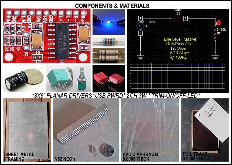

Ok so far I've looked where I can and the alu wire I would need I cant find. With this problem I cant see being able to build this line lvl style of speaker.
If I could cut this .0003" foil to .009" wide for 3' accurately I could still do it. I would have to make a thin foil cutting tool to do this properly. A Mill would be in order for this I used to have these machines.
I will continue to work at this problem until I can figure out the high resistance voice trace situation...
sreten's approach is the way left now.

Getting closer...
Ok I have most of the components for the build. Have to get most things from China these days so it takes a while.
Pick shows where Im at and just about ready to build the first set.
Everything is super tiny or so thin I cant feel it. So I'm looking at some tricky work ahead. I used to be good at this sort of work but as I turned 55 these things are already a lot harder. ... You know that's what makes me do it!
I'm adding a fixed bass roll-off to this because I want a controlled excursion at higher output levels as this little amp can push pretty hard.
Once a set of these are finished I will start on a Bass Box that would work with the set of Planar's. I have an idea for making a low power box that will output relatively low bass even with your typical 2 incher cones. We'll see how that goes in a while. enjoy
