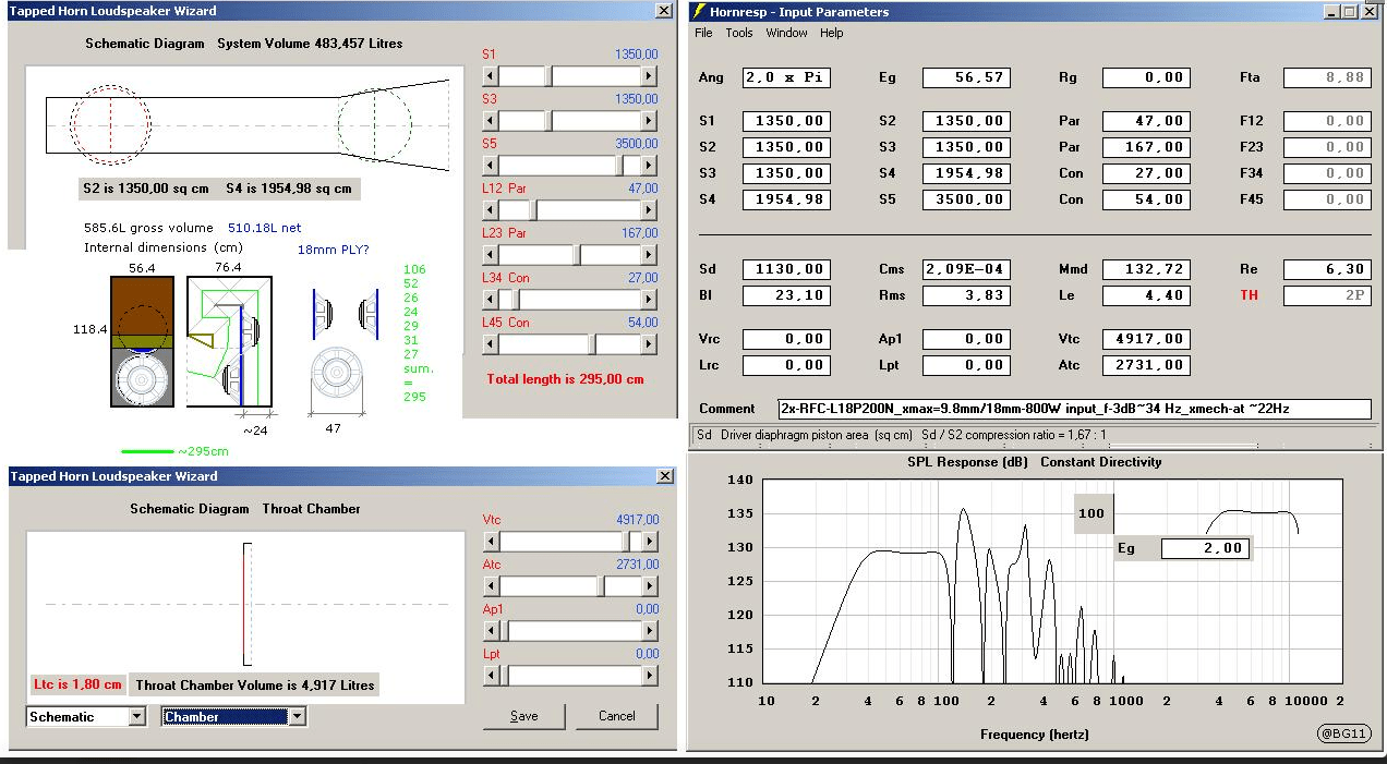

in post 24 are the hr inputs of tobiazz moddel.
i recalculated it later because at the begining of the horn it opens a bit more.
it wil actually plays 1,5 herz lower according to the first sim..
i also moddeled it the "cubo" way,wich shows aprox the same response in the passband.
this type th works pretty good with this rcf driver.

@ richard
grey line is the rcf driver ,black is your woofer.
these inputs wil get you started.
note, i dont know the le value so thats just a gues.
also i dont know the x-max value so i can't model how much output it wil give .

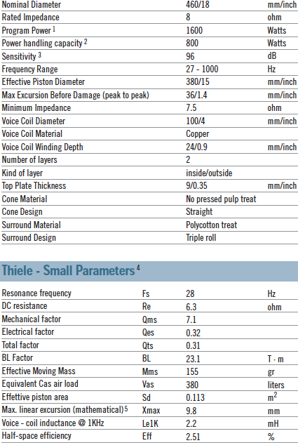

Good Day All,
Hi Epa, Thanks for your HR data input and simulation. Le is 1.9 mH at 1 KHz and Xmax is 5.5 mm based on Hvc - Hg / 2 . But if we follow the RCF standard as Hvc - Hg/2 + Hg/4 . It should be 8.5 mm.
Richard

ok tnx for clearing up
richard it wil put out ~ 126 db@x-max(8.5 mm)1 box 2 pi.
responce looks smooth.-3db @34 hz
If you want to push out 126dB from 8,5mm you will need quiet some power cause that drivers suffers from serious pwr compression. That's the reason why this driver gets fried very often. Actualy for us it is the number one in recone sales over the years.
To Erick( EPA). would you tell me what software ot program u use for drawing details as on subject no 31.

hi richardTo Erick( EPA). would you tell me what software ot program u use for drawing details as on subject no 31.
Cheers
Richard
i use autocad 2011.
Good day ,
Djim , thanks for your comments but i don't really understand what u mean with power compression. I'll be gratefull if u can explain to me in easiest way.
Richard.
Richard.
Hi Richard,
Power compression are the losses of energy by:
1.) heat development (thermal power compression)
2.) mechanical losses (dynamic power compression)
That means the more power you are feeding the higher the losses become. Most PA drivers use to suffer from 3dB to 4.5dB power compression at Xmax. This means you need at least 2x the power to get there. These days the latest generation extended LF drivers suffer a little less from power compression (still more then 2.2dB at Xmax).
