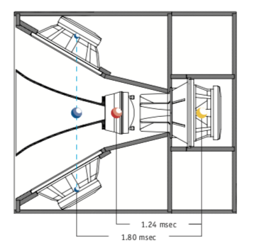

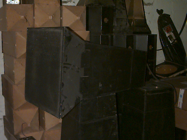

In my three-way nested Maltese horn system (circa 1992), the HF horn was enclosed in a box with a pyramid rear section which formed the phase plug for the two-part conical mid range horn.
Both horns used an identical expansion profile.
Is the horn enlarged and/or shaped to compensate for the volume of the HF horn?
It may or may not be enlarged.
Looks like EAW's KF700 series mid horn continues to expand from start to finish:
Lots of diffraction effects in that mid horn, it really didn't "come together" until "Gunness Focusing" (temporal equalization using FIR DSP) reduced the artifacts.

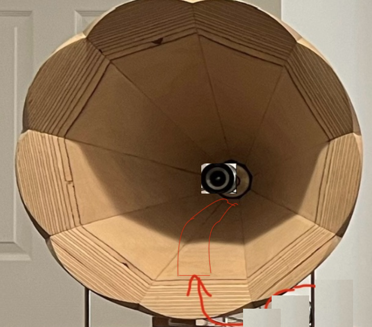

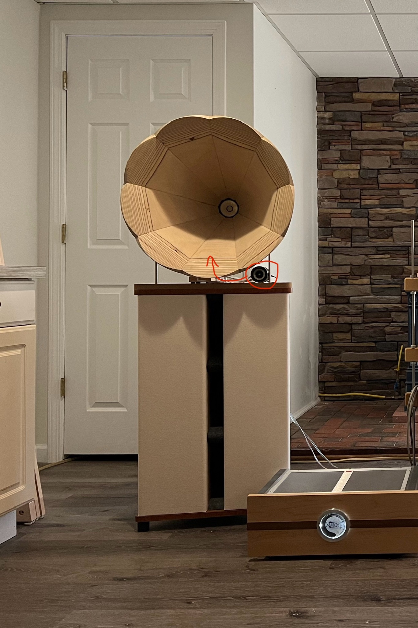

Interesting that this topic popped up.
I’ve been experimenting with a front horn/open baffle hybrid project for a while.
More recently I added a supertweeter I had to see if it would give me some desired clarity and detail I felt was lacking.
Because of the size of the horn it was difficult to find a good location for the supertweeter. I ended up just propping them at the edge of the horn on top of the OB bass section and angled them as best I could.
I was thinking this was a lousy solution and wondering how I could make it better by getting the supertweeters closer or at least along the same axis as the drivers in the horns.
I was brainstorming about adding some sort of low profile wedge shaped clamp on shelf for them somewhere along the center line of the horn near the mouth.
Roughly located as in this pic:
I wasn’t sure if this would be better than what I was currently doing with them or if they would have a negative effect on the performance of the horns.
I agree side mounting the tweeter is a lousy solution, and vertically above or below is still a big separation jump.
I think any deleterious affect from co-axially mounting the tweeter in front of the midrange would be far offset by the more uniform off-axis response the virtual point source will provide.
The tweeter could also reduce the mid driver's "beaming".
Using a "nose cone" (semi-phase plug..) behind the tweeter would make the transition smoother.
A toy football cut in half would take care of both tweeters, and would actually lower the mid horn's Fc slightly.
Covering the nose cone with felt or absorptive foam would reduce diffraction effects around the tweeter.
The UREI time aligned coax used foam around the tweeter.
If your crossover is in the 5kHz range, there may be 3 or 4 points along the mid horn's central axis that will phase align the tweeter/mid response. A temporary wire support (arrow pointing to the curved support bridge) could allow sliding the tweeter in and out to find the optimum position for frequency and phase response.
Once you find the sweet spot, a more elegant mount could be made.
