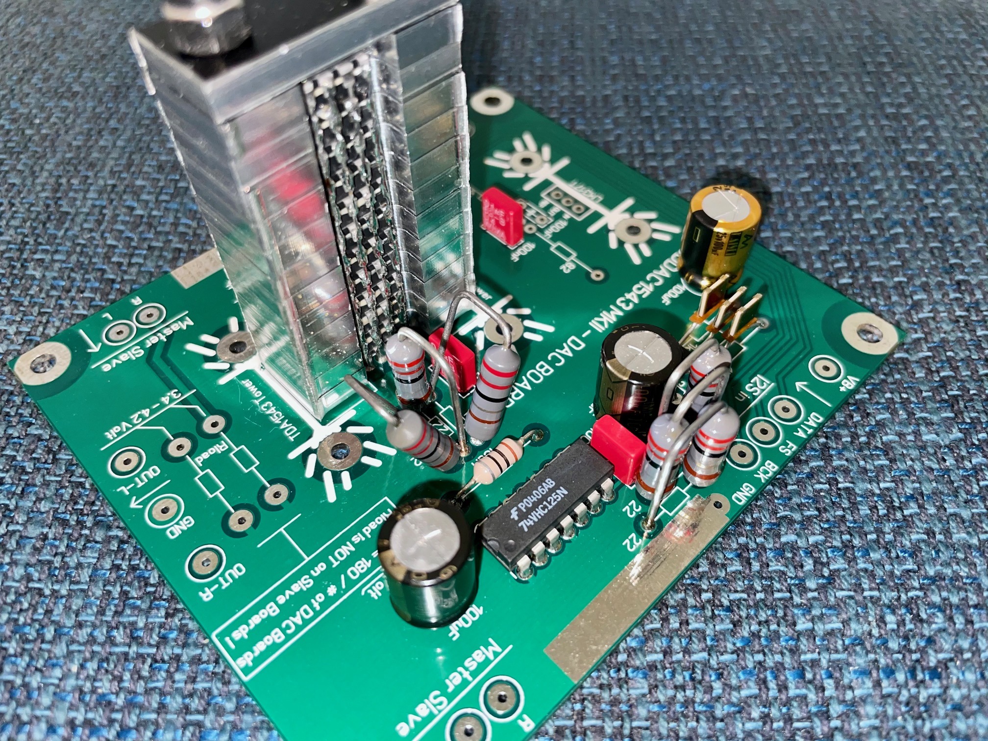

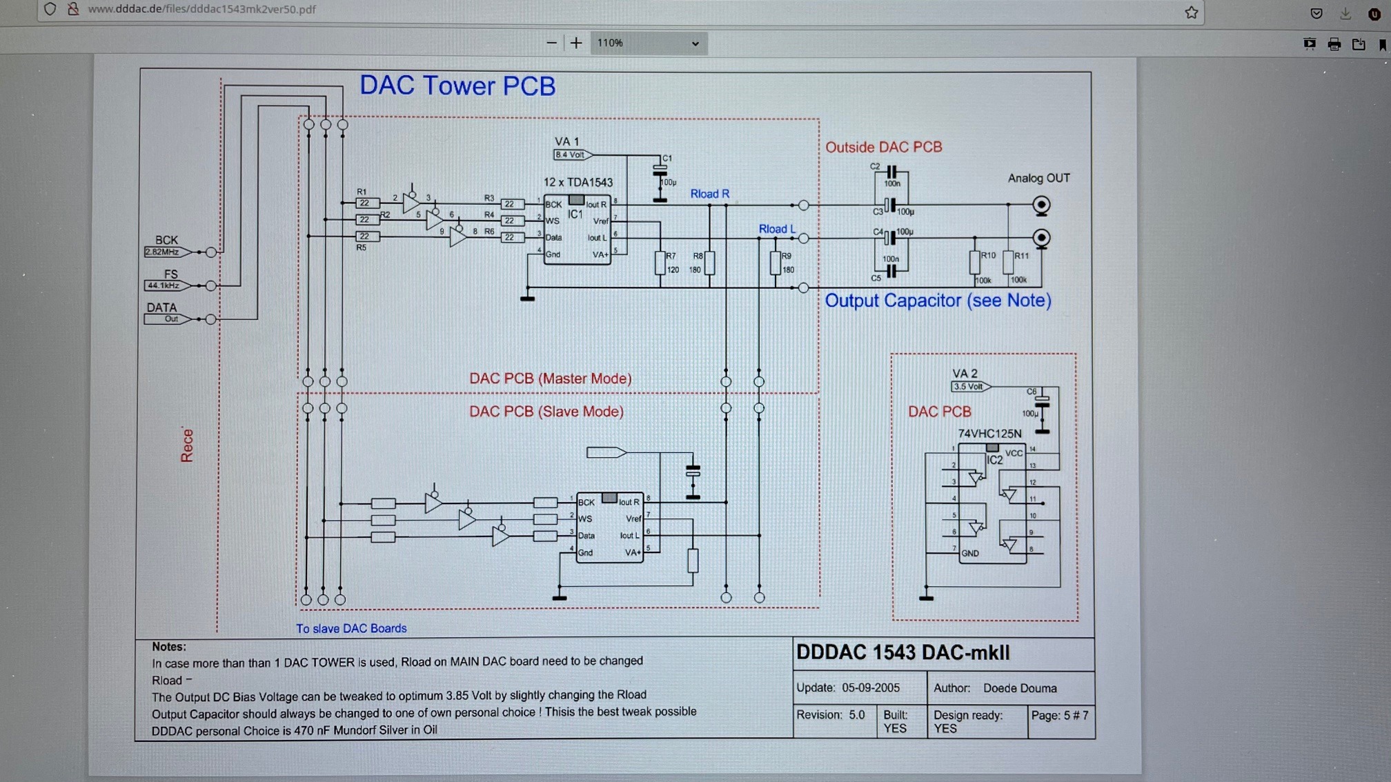

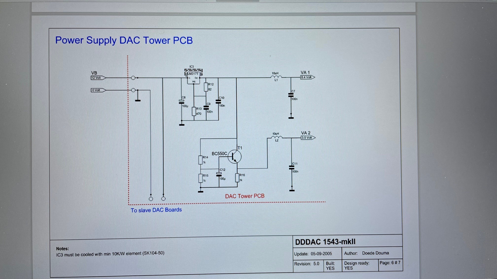

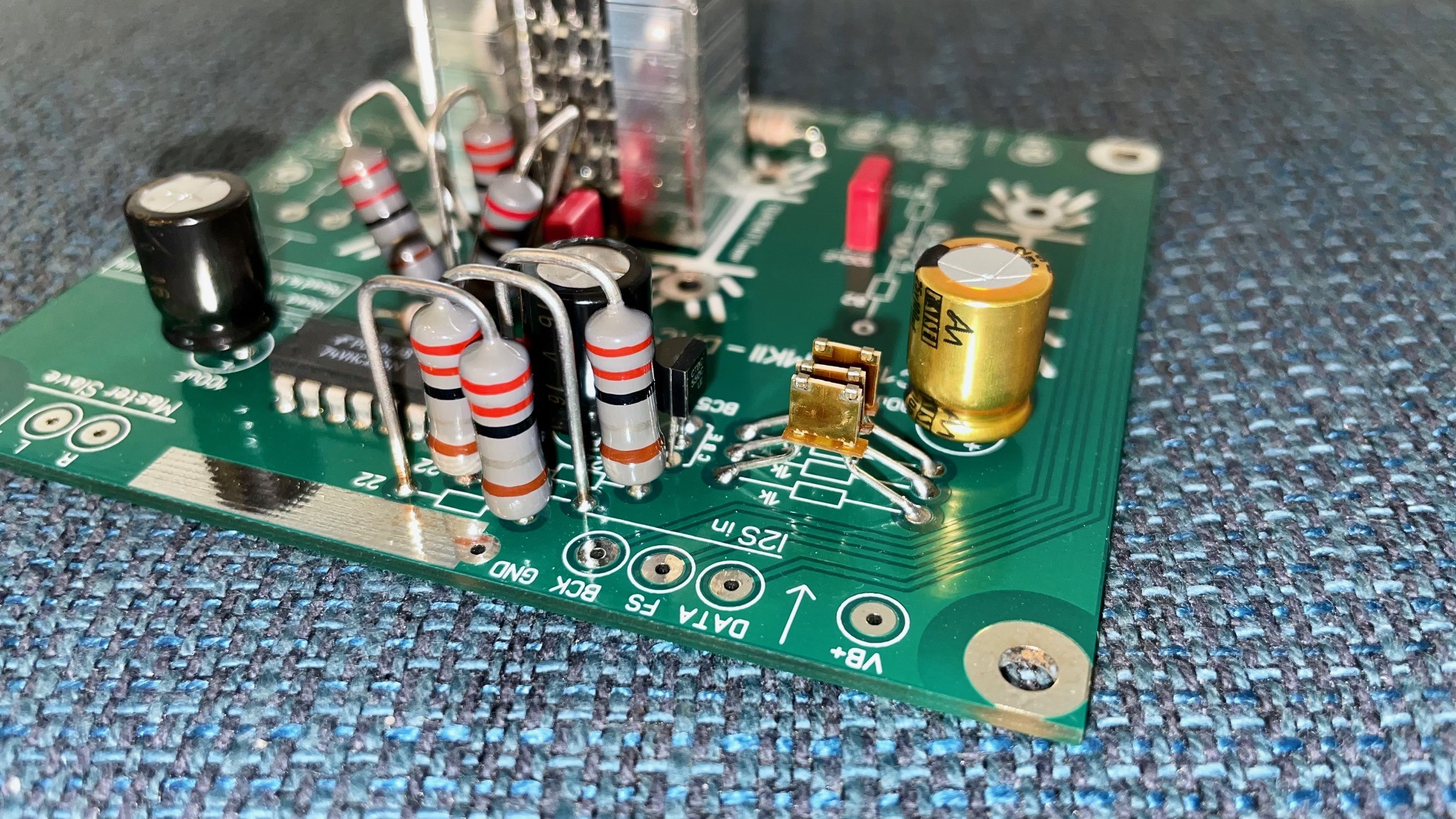

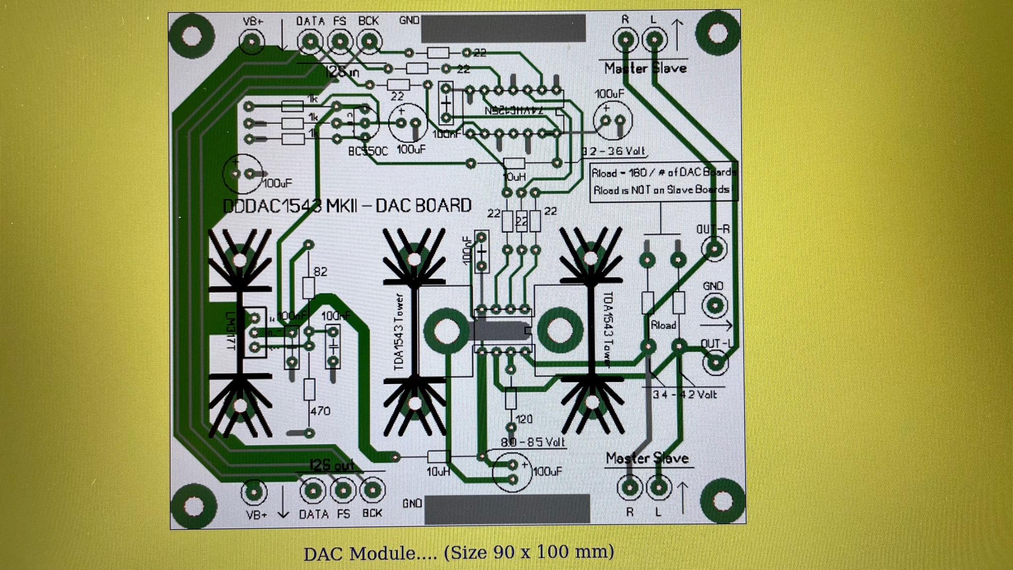

Hi everyone, thank you for response. Here is where Im have the "problem" ( :
Its on my DDDac1543, you see the tantalum resistors in signal path. Just wondering change 3 of them with Z-foil resistor. The same type that sits in the powersupply part off the construction. Frank

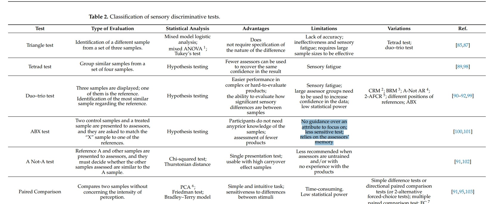

Please see summary of test limitations attached below. Excerpted from, "An Overview of Sensory Characterization Techniques:
From Classical Descriptive Analysis to the Emergence of Novel Profiling Methods"
IME the memorization part is what can be hardest to learn, particularly so for very low level weird and or unusual electronic sounds.
Also, as respected forum member PMA observed after personally learning how to pass ABX, the protocol requires fatiguing sustained concentration to pass a test, in contrast to the ease of sighted listening. People are not usually so quick to accuse PMA of using a 'playbook.'
EDIT: For the record and in response other accusations, I have said on numerous occasions that I recommend periodic blind testing for everyone to help maintain calibration as to what is real and what isn't.
