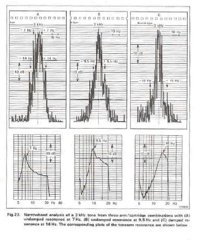

For Judging speakers. On speaker forums. Nothing about resistors, certainly nothing about DACs. You appear to be trying to use a blog by Lars to prove all sorts of things which it just doesn't. When the time domain signal is clearly different to the naked eye there is little to argue about. this really does not support your glom and listen reports into DACs and the like. Or the gloop filled benchmark etc.
For a laugh have a look at the modulation on a test tone on a record courtesy of B&K back in the 70s. And some people whose opinion on resistors you trust say vinyl is better...
