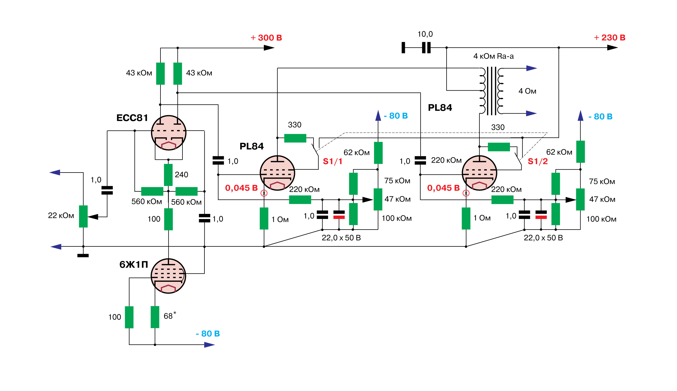

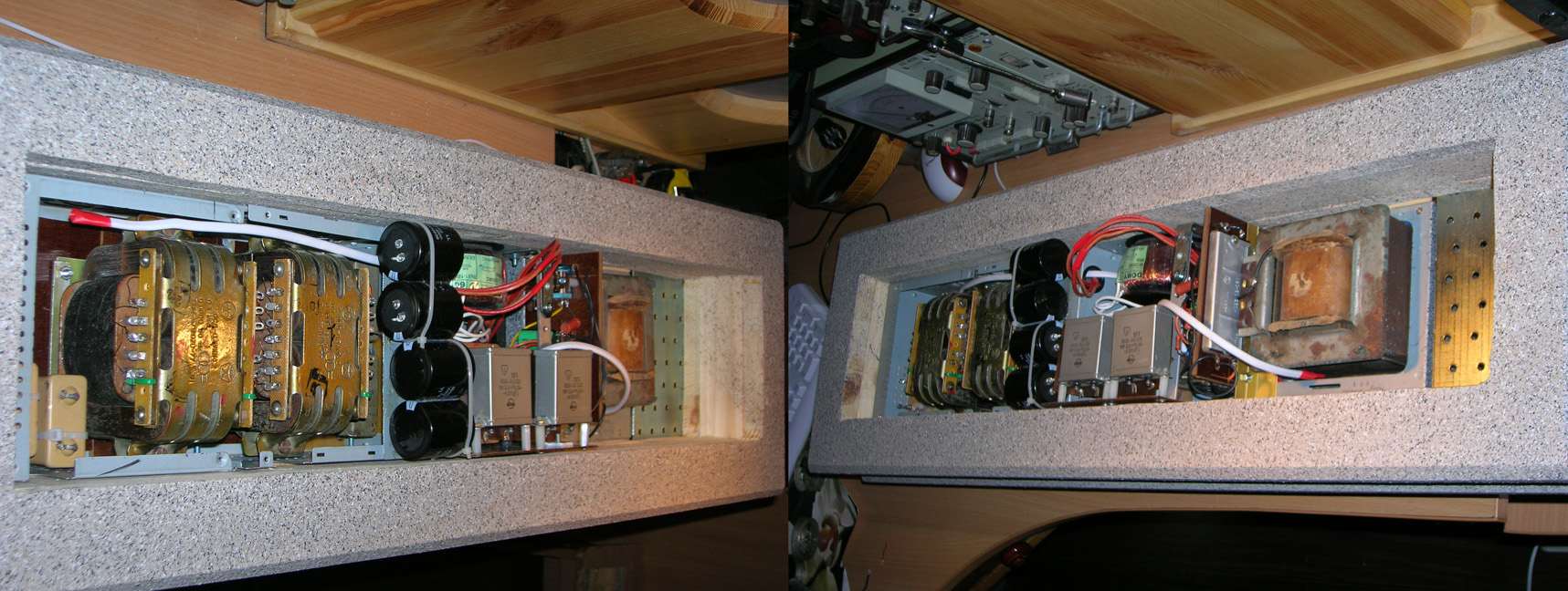

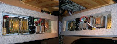

There is my new DIY amp. Great sound both in triode and pentode mode. Thyratrons are used in PSU for the output stages.I recently accidently bought some PL 84 tubes. Does anyone have a schematic
for an amplifier using these tubes?

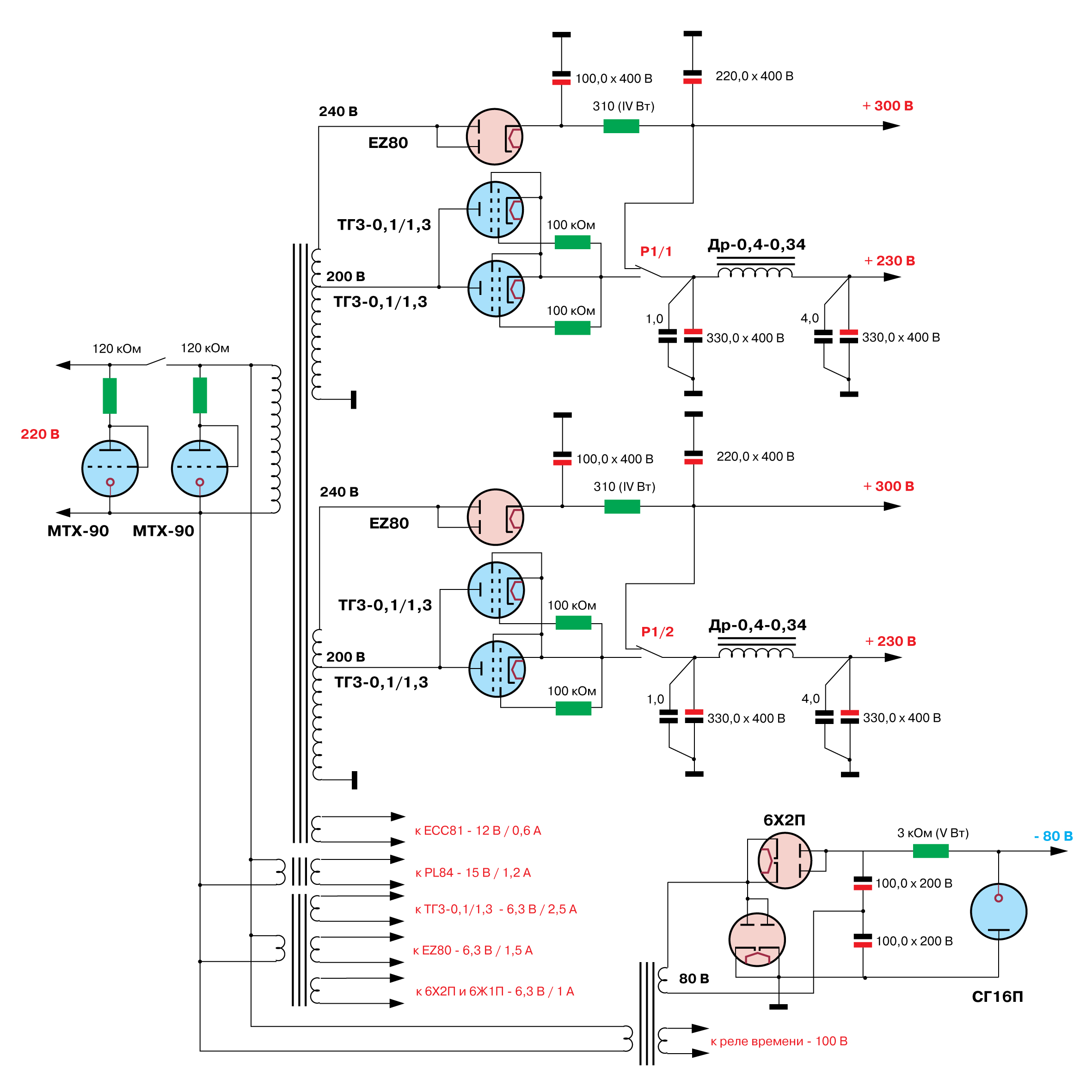

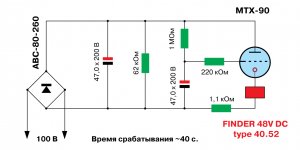

So the TG3s are functioning as half-wave rectifiers in this power supply? Please explain. Are they self-triggering because of the 100K grid shunt resistance? How predictable is the trigger threshold? What is the reason for including switch P1?
Hello, everybody!
Thyratrons feature the following.
Pros:
- very low plate (i.e. inner) resistance vs. kenotrons
- constant voltage drop (11 volts on TG3-0.1/1.3)
as a result the amplifier in class AB receives stable power from PSU, contrary to kenotron rectification where the voltage drop on kenotron varies along the variable anode current of the output tubes (in class AB)
Cons:

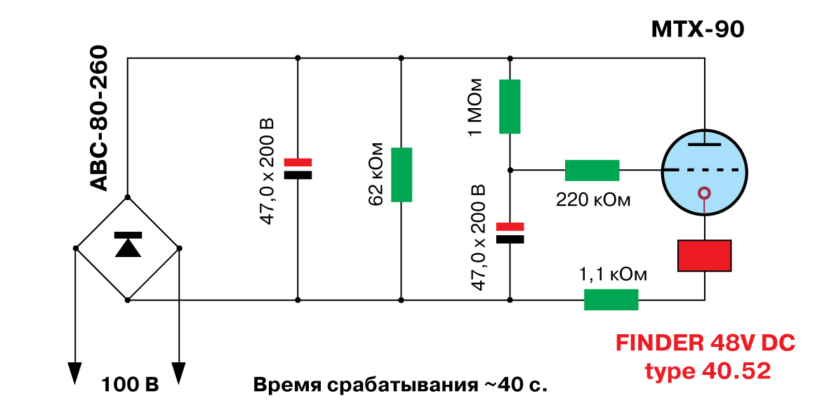

- thyratrons require a delay (specific for each type) when filaments becomes completely hot before the rectifying voltage is applied; otherwise the cathodes of thyratrons lose the emission after about a hundred of switching on.
So when the amp is powered on kenotrons EZ80 start to charge the filter capacitors and slowly provide power to the schematic; in 40 seconds the output stages (PL84) are switched to the power from thyratrons with already hot filaments; the phase splitter stages at that continue to be powered from EZ80.
As a results I’ve got here a great energy of sound especially in bass and especially in high volume.
P.S. I’ve tried different types of thyratrones (including RCA 2050) in several PP amplifiers and in my opinion they are a good option for PSU.

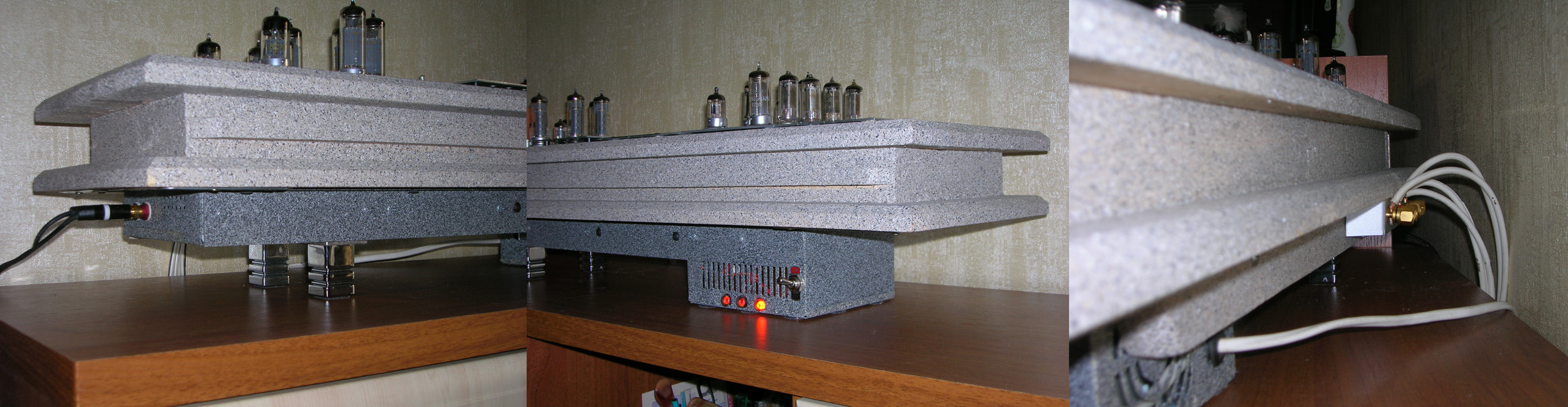

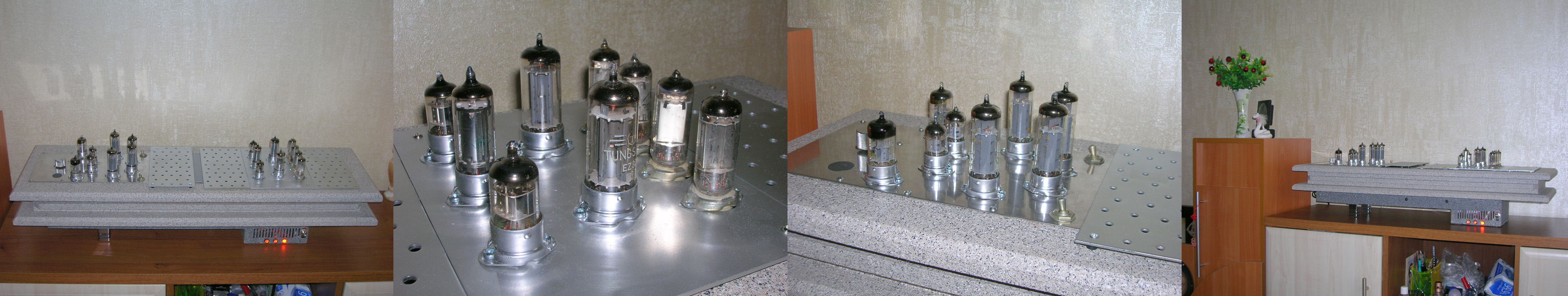

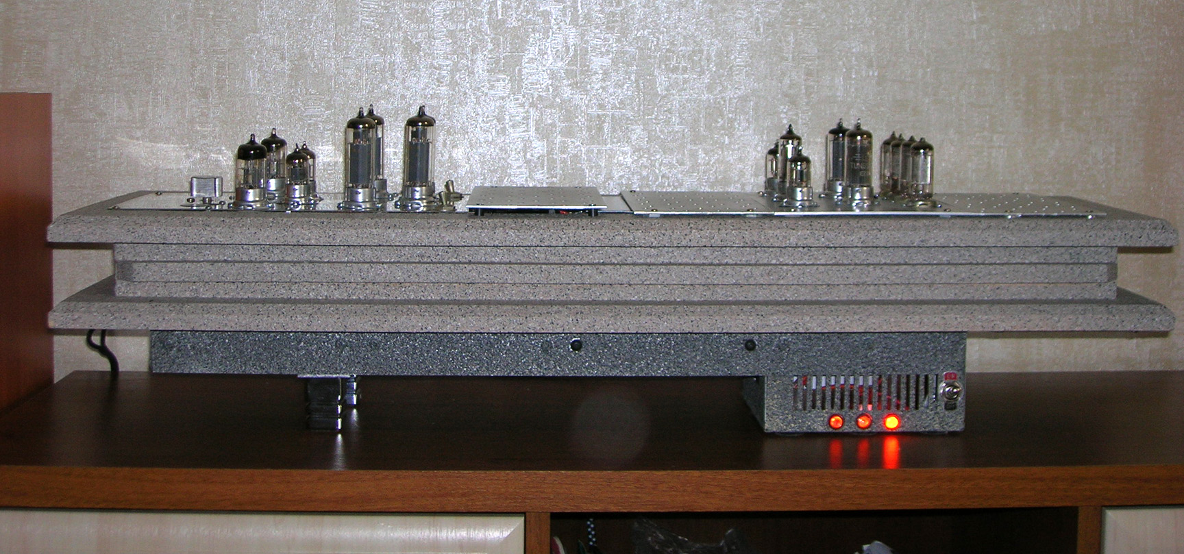

Very unusual style for chassis. I like.
Congrats.
Yes. The thyratrons are functioning as half-wave rectifiers here. And are self-triggering because of 100k grid shunt resistors (and grid 2 couplet to cathode).So the TG3s are functioning as half-wave rectifiers in this power supply? Please explain. Are they self-triggering because of the 100K grid shunt resistance? How predictable is the trigger threshold? What is the reason for including switch P1?
Pros:
Cons:
