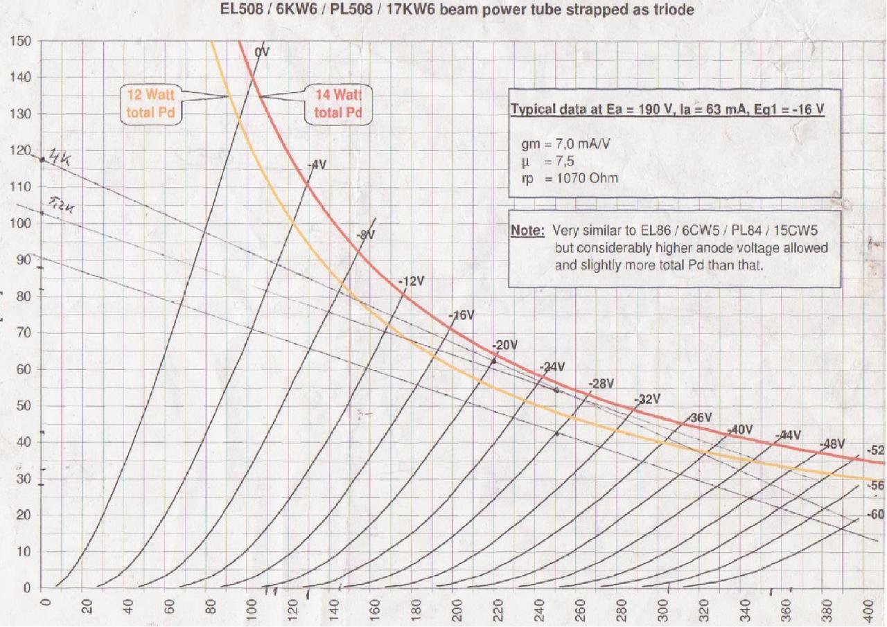

Friends Anyone have the curves of PL508 in triode mode ? Thanks Aldovan :D
A aldovan Member Joined 2005 2015-10-25 3:04 pm #1 2015-10-25 3:04 pm #1 Friends Anyone have the curves of PL508 in triode mode ? Thanks Aldovan ••• More options Share Sorento Member Joined 2008 2015-10-25 5:04 pm #2 2015-10-25 5:04 pm #2 I believe these are from Tom Schlangen, no longer online ... Attachments 22852521fl.jpg 174 KB · Views: 259 ••• More options Share Show hidden low quality content Status This old topic is closed. If you want to reopen this topic, contact a moderator using the "Report Post" button.
