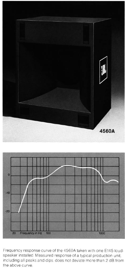

You must be thinking of the classic "Perkins Bins" frequency response, the Roseland Theater's tech specs don't mention frequency response.
Edit: Even the 4560, arguably Perkin's most widely known cabinet from the 1970's has response to around 45 Hz.
