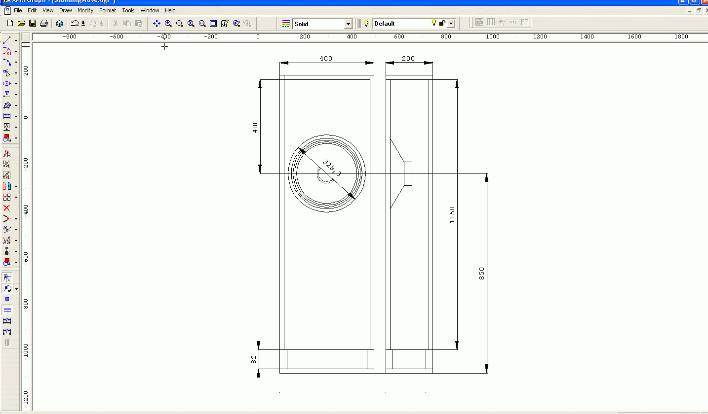

This is a rough sketch of the speaker we are talking about

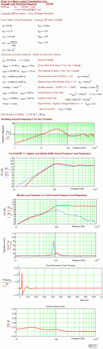

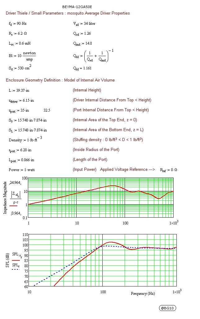

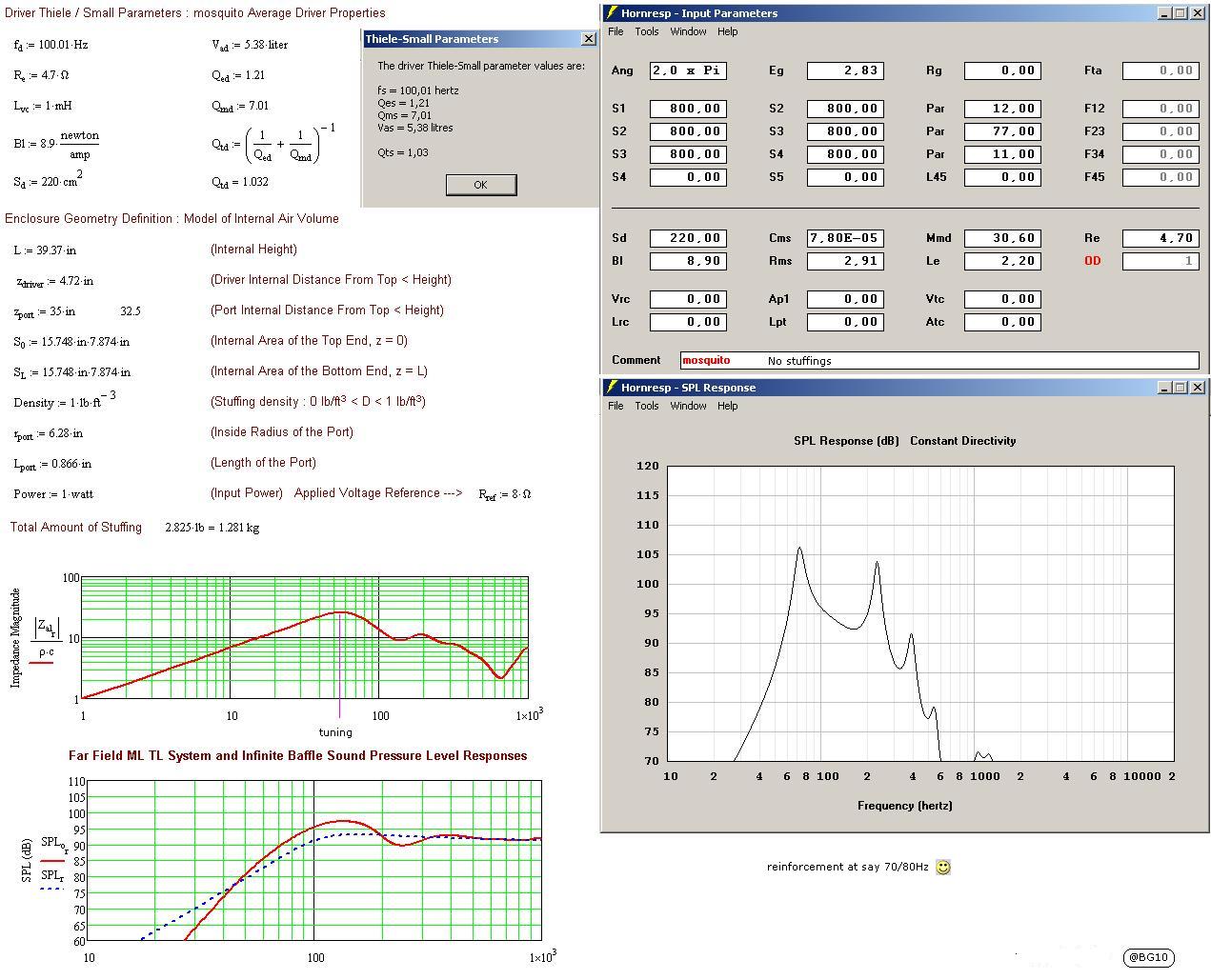

Following the MJK tables, and the simulation results from bjorno I drawed a line a bit longer.
1.25m minus the boundary end correction is 1.15m
Driver SD is 530cm2, fs 100, Qts 1
The suggested offset is 0.349. but I'm Not sure if it means 1.15 X 0.349 as in my drawing..
Any suggestion is welcome
Cheers
J
