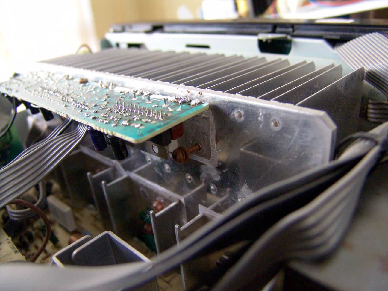

A friend of mine asked me to help get his A/V receiver up and running. Some guys have tried to fix it, without success.
First informations are as follows:

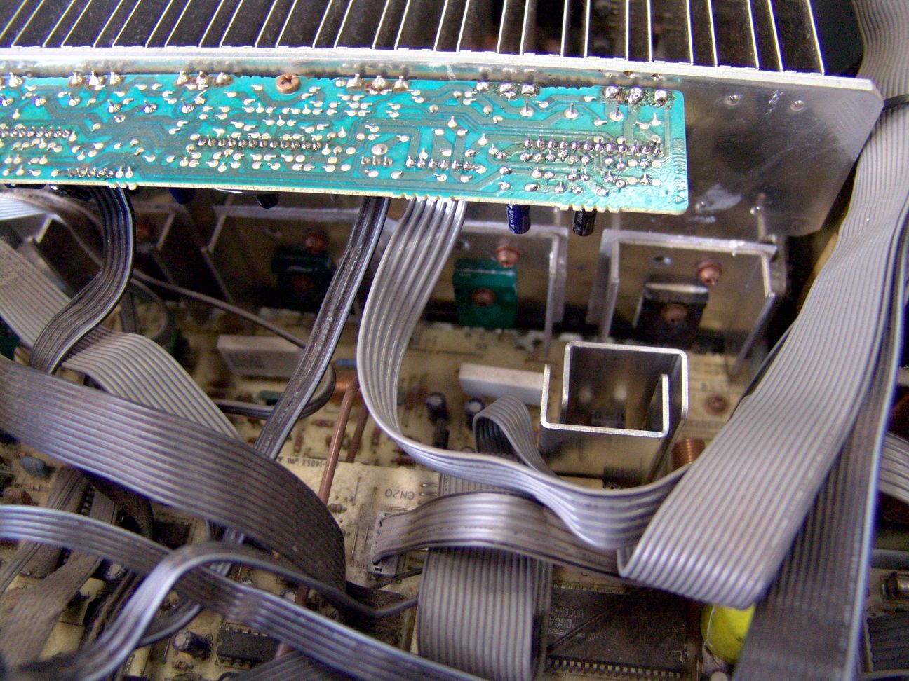

After an unpredictable time, it goes into protection mode, and only resets if powering off and on.
There is a pair of output transistors missing. :t_ache:
I will post some photos.
Does anyone have schematics for this amp? (I haven't tried to find them as yet).
Thanks for any advice.
Max.

Channel w/ missing OP's is 'floating" ... triggering protect circuit. Either short that channel out with 1k resistor to ground or fix it. Did this on my 4.1 sony receiver before I "moved on" to DIY. 🙂

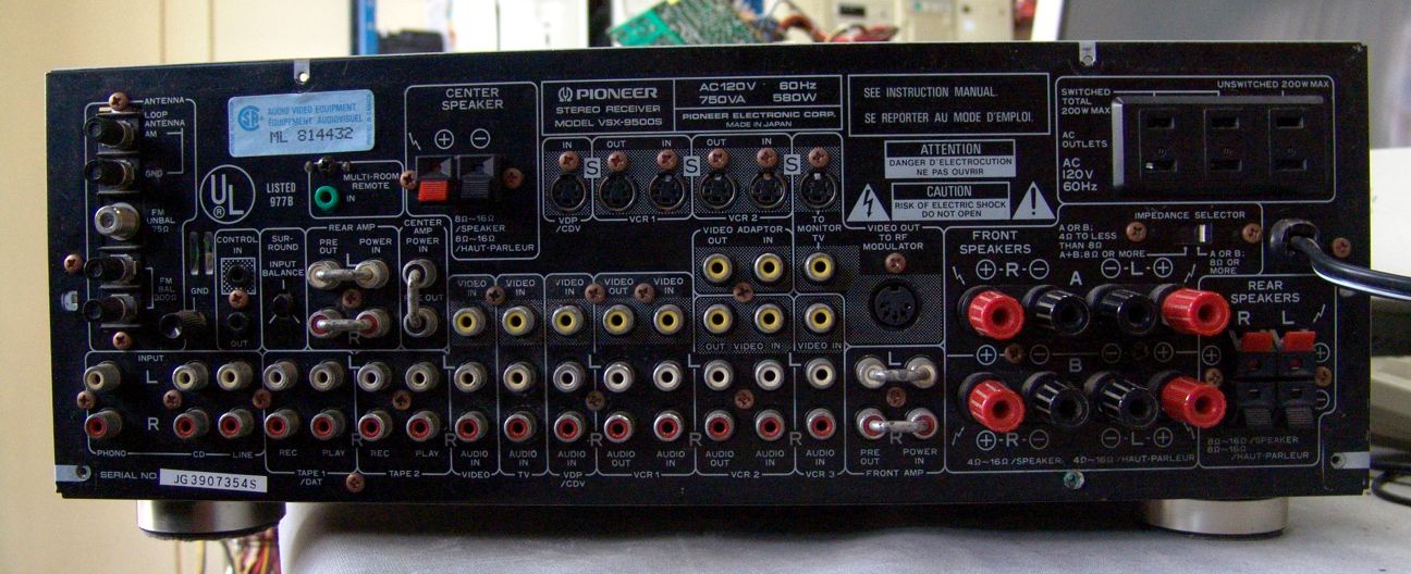

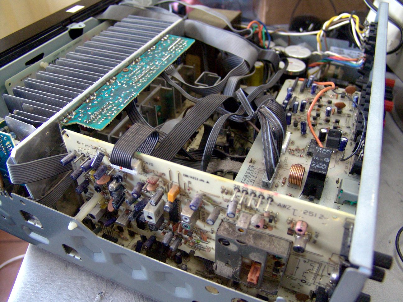

Thank you OS and Infinia. I was thinking of both situations, and I will manage to execute those procedures.

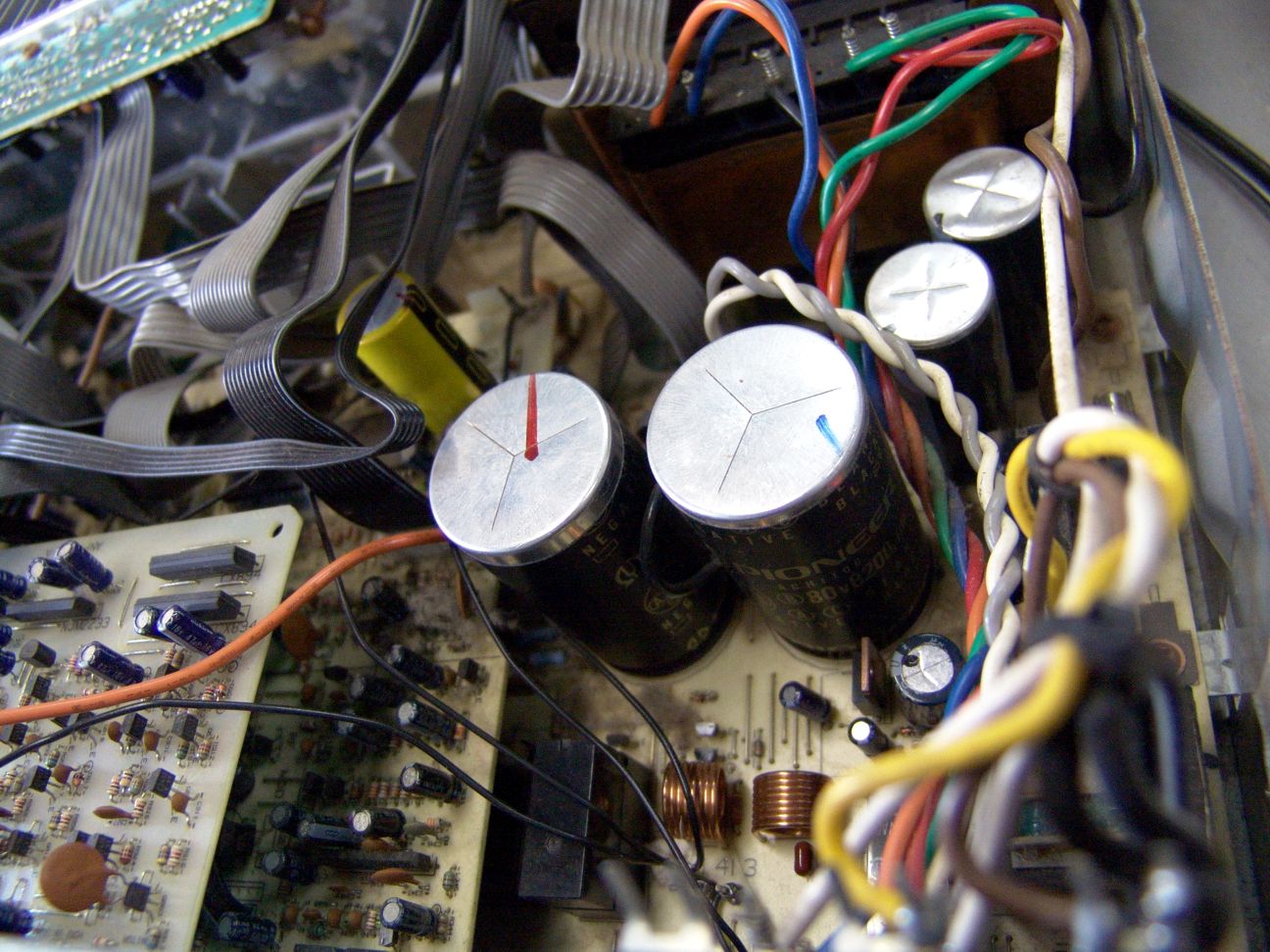

Your main PS capacitors are all bad by the looks of things. (melted sleeves) 😱😱
Recapping is a must in this case .. that could be the main problem !!!
It has been along time since I saw an OEM amplifier .. How do they get away with only 8200uF X 2 ??? Mine is 40,000+ X2 !
