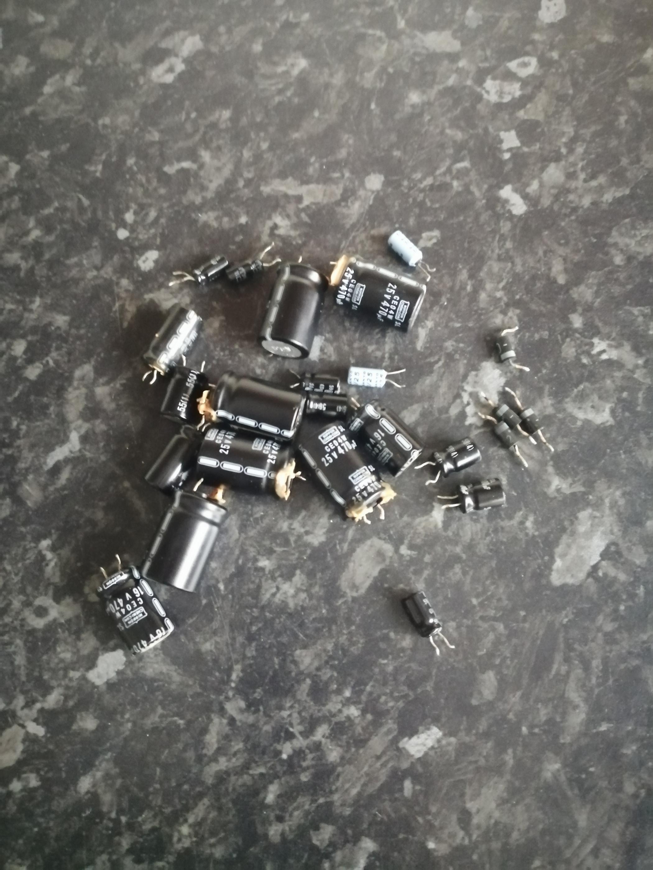

Just replaced all the elctrolytic capacitors in the power supply and audio board with fresh Nichicon FG series.
I bet those black Nippon Chemicon would still be ok but I wouldn't leave something 40+ years old in the power supply.
Tantalum capacitors on the audio board are fine, so I left them in place.
I've also replaced the bridge rectifier diodes with new 1N4007 diodes. Voltages are spot on.
I am not planning to change any electrolytics on the IF and MPX boards as they are all Nippon Chemicon caps and I don't expect them to be stressed too much.
The only electrolytics I replaced on these boards are four of them across power connection and earth.

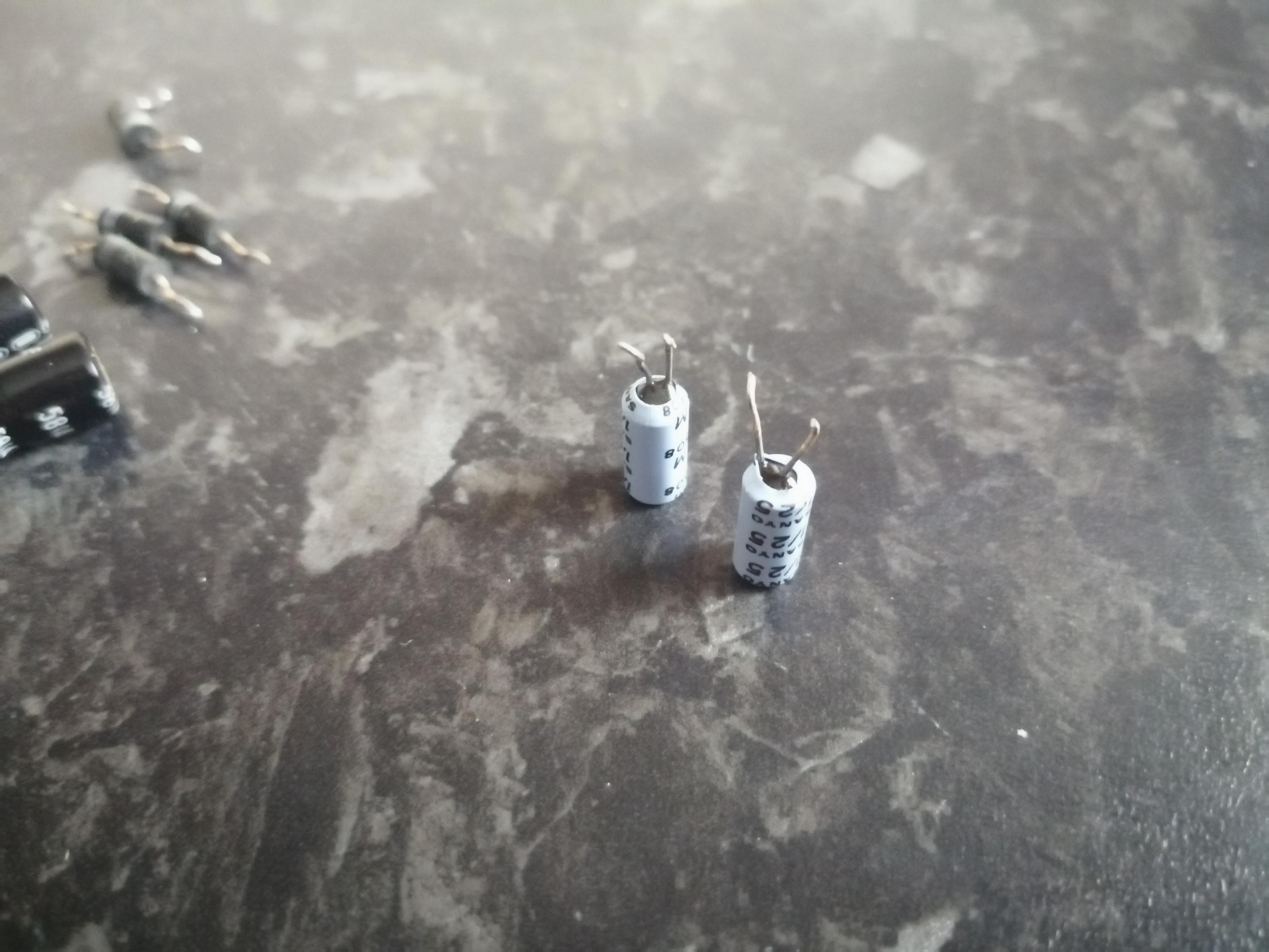

Check these two pale blue Sanyo capacitors that I removed from the rec calibration circuit. These are small 1uF/25V.
If you zoom in you will notice the bulge on the bottom.
These are notorious for failing and developing high esr values.
Unfortunately, there are three of them in the MPX board, which I bet will look the same and they are of small values. Would it be ok to replace them with Nichicon KL series or Wima MKS2 film capacitors?

IF you decide to change the three capacitors on the MPX board do it VERY carefully taking great care not to interfere with any surrounding component even soldering use a lightweight iron so that heat is not spread to other components .
With what you say about that signal strength on FM you have a very good RF circuit design there that's stable , much better than many I have come across some would "die " for that sensitivity .
Yes go ahead and change them but be VERY-VERY-careful !

I've just replaced the nasty Sanyo capacitors, and those orange ELNAs in the MPX stage with Nichicon KL, low leakage caps.
Moreover, I replaced a blue capacitor across the signal meter which I thought it was another Sanyo, but to my surprise it was a Nichicon, which I replaced with a fresh Nichicon KL since I had it in stock.
Overall, I took good care to replace only the electrolytic capacitors which wold not affect the tuning performance, namely, power supply and audio circuit. I've only replaced a few capacitors in the MPX stage just because it was necessary.
I think stereo kicks in a bit faster now.
Tuner tunes in beautifully, stereo reception is excellent even with a piece of wire connected to the 75 Ohm terminal. If my signal meter is properly calibrated, this tuner is amazing...
