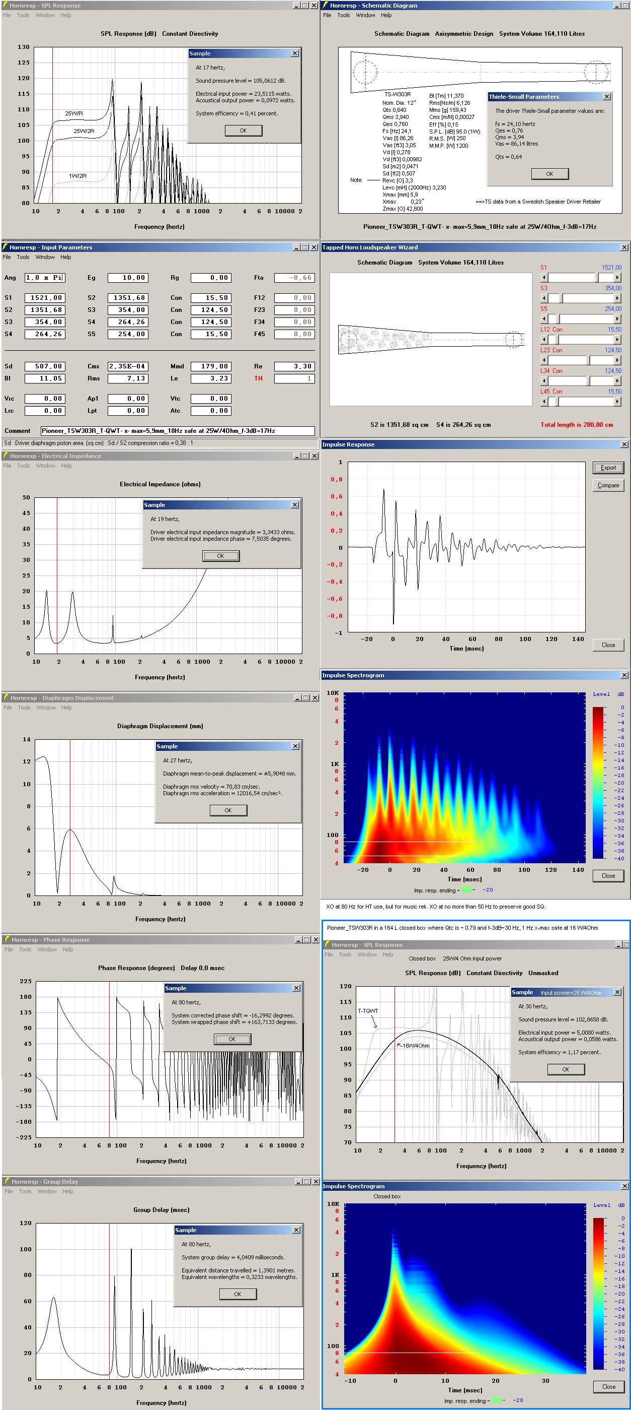

Agree, I found more believable T/S data..?.. that I tried to use for use in a T-TQWT 🙂. See the plotted simulation results in the picture:
