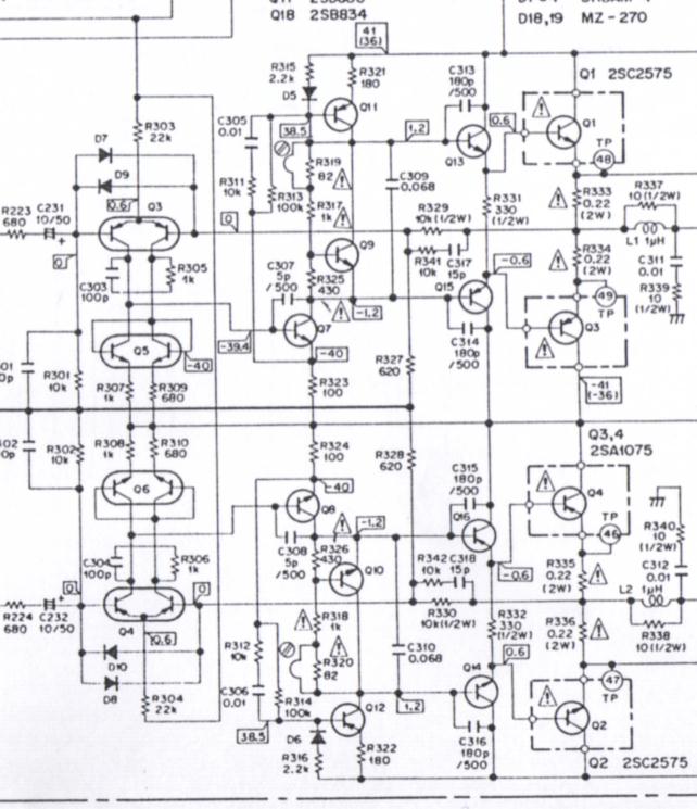

Many newer rcvrs have the bias network done with fixed resistors. Sometimes there is a higher value in parallel that is cut or reinstalled to adjust the bias. With a nice unit (nice-ish?) I'll mess with the value to set the bias where I want it. This is very difficult to find unless you are use to finding these without a manual. Hint: The small transistor on the heatsink. Follow the traces.
-Chris
I just messed around with a SX 3800 with the same outputs, but mine had 2 pots per channel to set the bias. the pots were on the amp board that is mounted vertical and also hard to access with the regs mounted on a vertical board on the other side of the sliced fin sink. Beware of the crappy sockets on the outputs.
PS nice units they are. The 2 pots near the output meters are meter adjustments.
Here is the procedure from the Service Manual
Pioneer SX-3700 Idle Current Adjustment
1/ Turn volume down to minimum, turn power
power on, and wait about 10 minutes.
2/ Connect DC voltmeter to the TP terminals.
(L ch - TP48/49) (R ch TP46/47)
3/ Check that the voltage lies within 2.2mV-100mV
DC. If voltage is LESS than 2.2mV, cut jumper
A (L ch), and jumper B (R ch). If voltage
exceeds 100mV, check for circuit failure.
