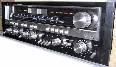

A bit OT, but does anyone know how close the SX-5580 is to the SX-1250. I sold the 1250s new when i worked hifi in the laste 70s, the 5580 looks like a black faced 1250, and has an accessible voltage selector on the back, so it is a non-North American model.
dave
I'm not sure, but it does look exactly the same, only with a black face.
