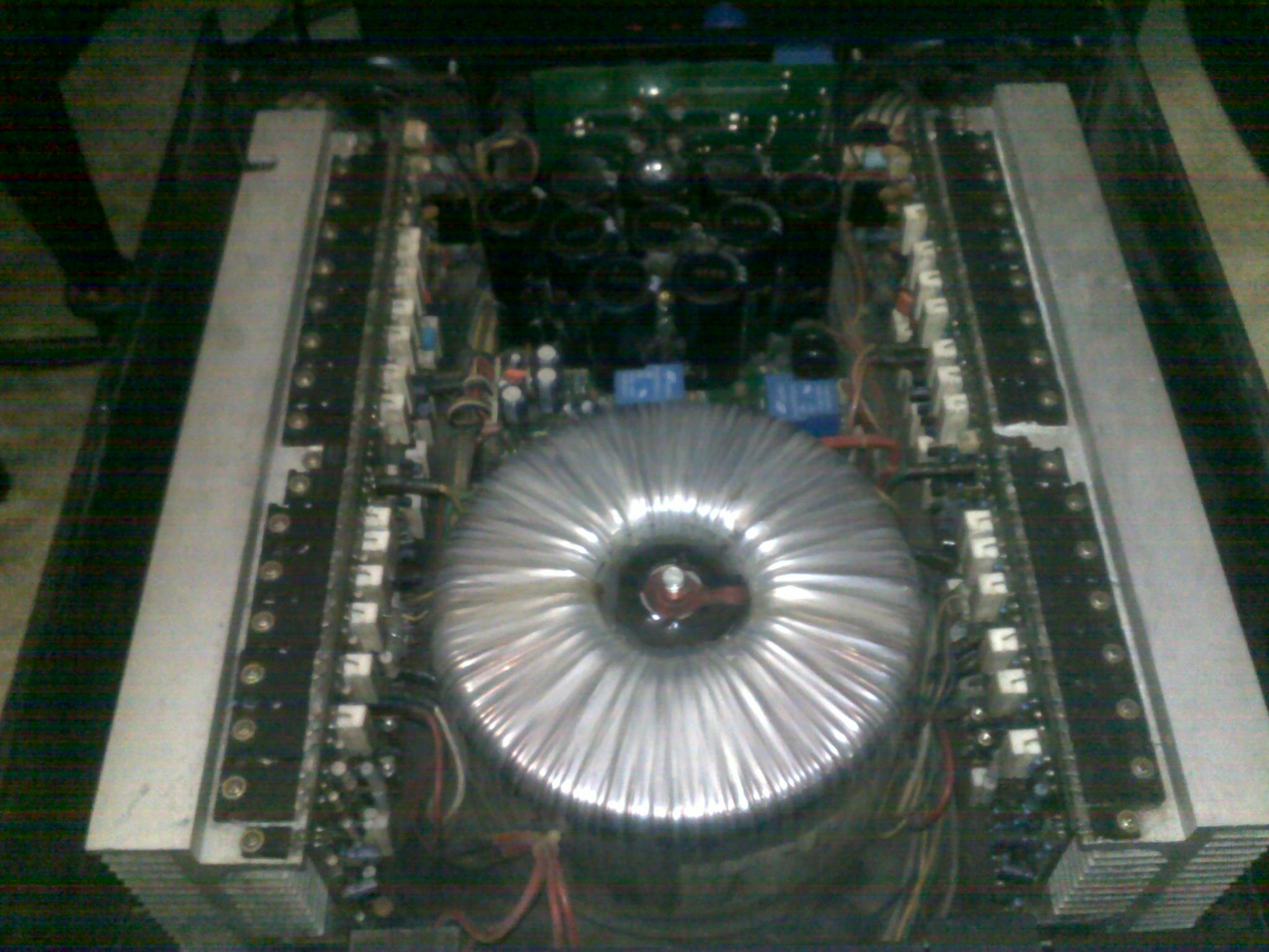

Dear chris the sub is required below 50Hz. I have this amplifier sort of copy of JBL. IT has a massive toroid is suspect around 3KVA. with 54 total ouput devices, i dont have manual but i expect it to deliver somewhere around 1600W into 2Ohm. So for DVC woofer i will have 3000W of power.
Any ideas how much volume will be good for maximally flat QTc 0.75 or lower for low end extension.???Whts your current setup.

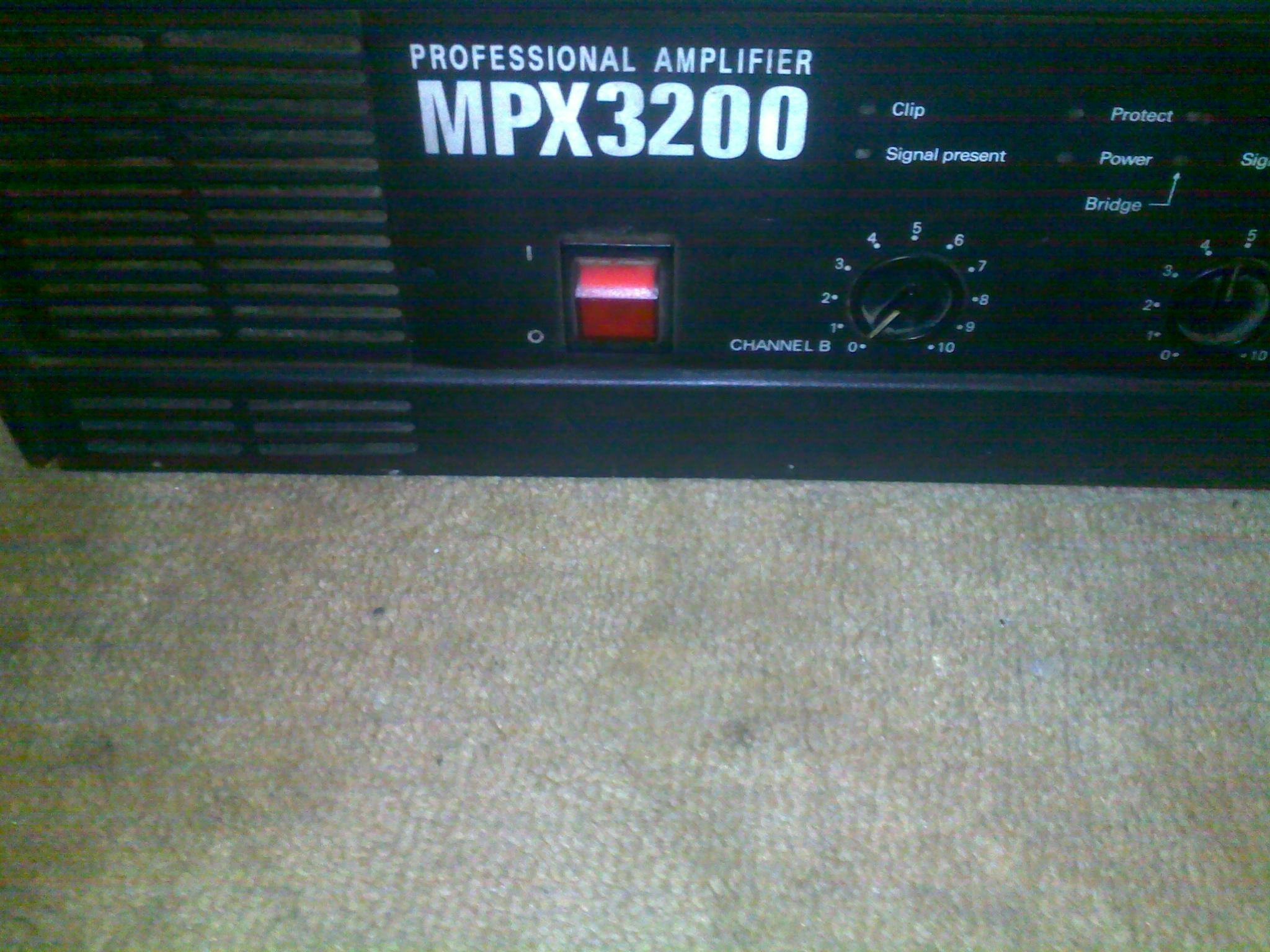

i am loading the pics of the amp if any one can recognize it.
here are the pictures of the amp

That amplifier looks like a PA amp. Not sure if it'll drive 2ohm safely, but it would appear to have some protection built in.
I'd try wiring up for higher impedance (=easier time for the amplifier), and see if you have enough power available.
