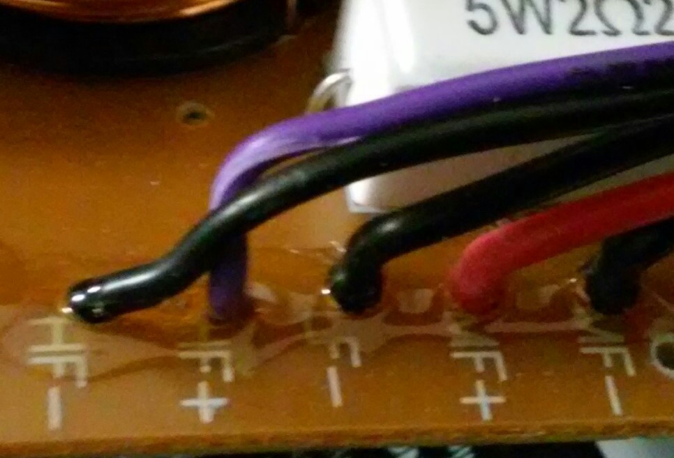

This is Tom From Wells, MN. A friend of mine brought me over the speakers mentioned in the title. Said he bought them at a yard sale but they don't sound right. I check the crossovers of both of them and they are both partially disconnected. Does anyone know how these are supposed to be wired up? All they have on them is MF-, MF+, LF-, HF+, and HF- the model number on the crossover is 350-FS51-2.

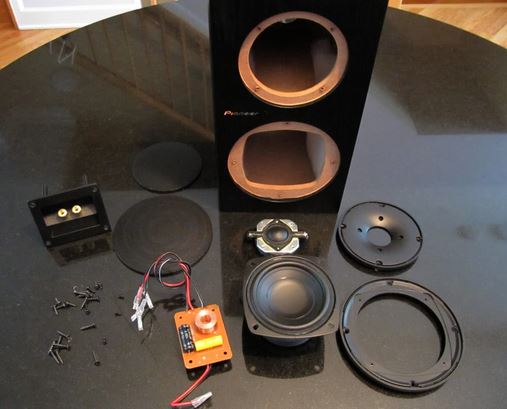

thanks for that can you take a picture that shows the actual hookup to the speakers? For some reason I have extra resistors inside the tower and I don't know where they go?
Ok give me a few minutes to take them apart i had that picture on hand. I do believe the woofer positive are in a series with the mids but i will look. The loose resistors sound suspicious what are the values? Are there any missing pieces on the crossover?
3.3 ohm 10% 5W wire wound connected in series to a 2.2uf 100vnp capacitor. Red wire connected to free end of the resistor. A blue wire connected to free end of capacitor.

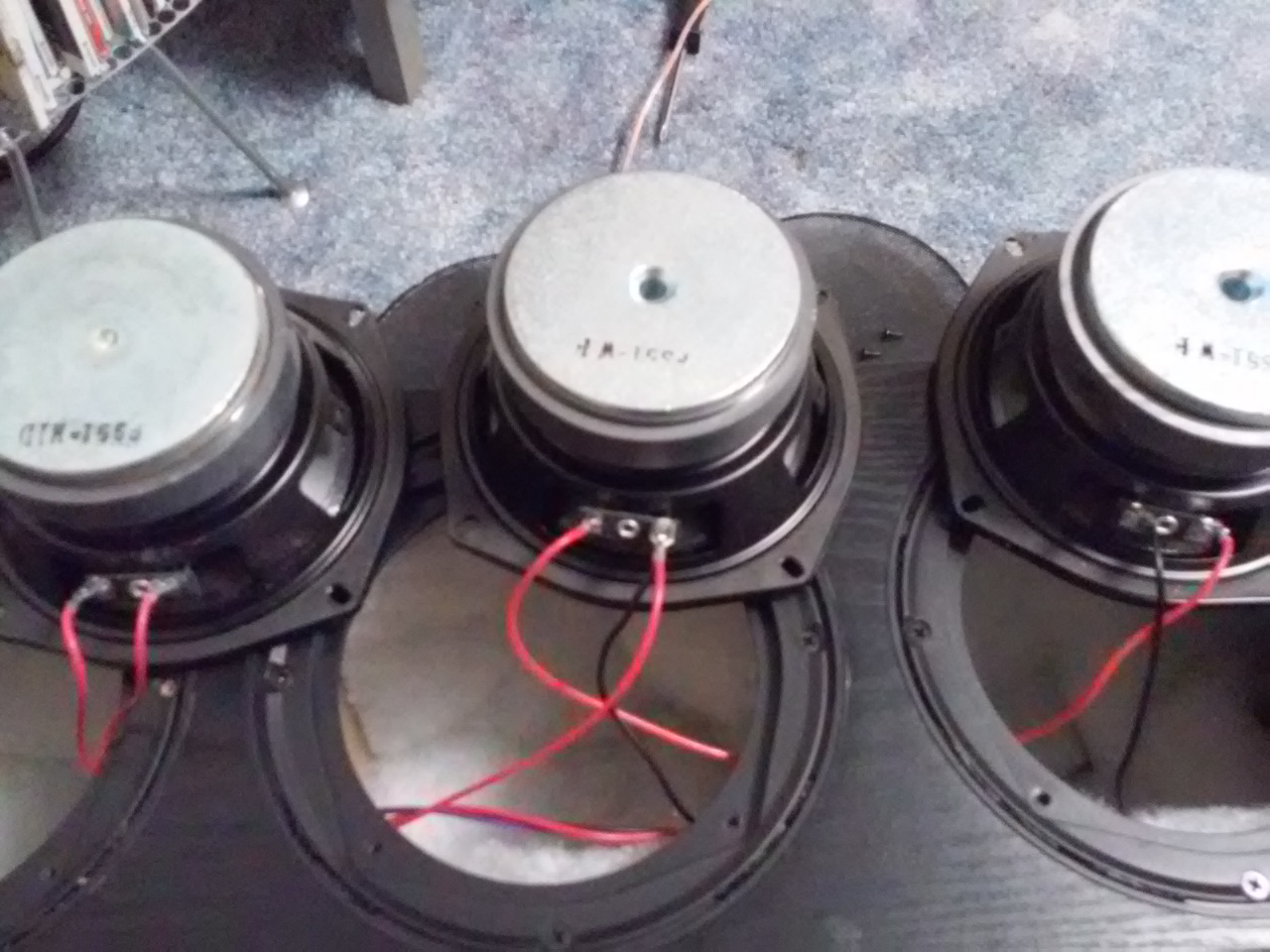

Ok so MF- on crossover goes to neg side of the woofers and mid and MF+ goes to Pos side of Woofers and Mid correct? So where does the LF- go? Thanks for your help with this.
So here is goes L- goes to - on the bottom woofer.
+ on the bottom woofer goes to - on the top woofer.
The + on the upper woofer has a split connection the black wire goes to Mf- on the crossover the red wire goes to the - connection the the mid.
The mid + goes to Mf
perfect. Hopefully this will get this working correctly. I think the resistor and cap were added because some replaced the pioneer tweeter with a Pyle 8 ohm 200w midwoofer whatever that is supposed to be. Anyway let me get this hook up and I will report back.

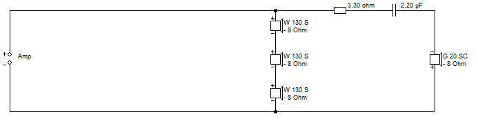

BTW, if I had to guess what Pioneer did here, given that this is some commercial rubbish 2.5 way speaker designed to sell to people with cloth ears, it might be wired like below.

Just to let you guys know that I got it working. It sounds good except for the Pyle PDMW5's which are mid woofers. I am wondering if that is the reason for the resistor and the capacitor to filter the high's and lows better. It seems that frequencies form the HF on the crossover are too high and making them crackle.

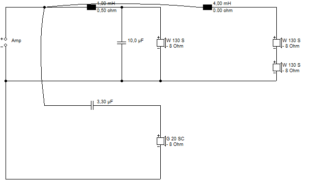

I think you really need to post some photos if you want to make progress with this. AFAIK, the tweeter is easily replaced with the Goldwood GT520 tweeter unit Inductor pointed out.
What the Pyle woofers are doing here, I have no idea. This speaker sounds like it has had a rough repair. A wiring diagram that might work is below. The W130s are woofers. The G20SC is a tweeter. it gets a capacitor to protect it from bass and a resistor to drop the level.
