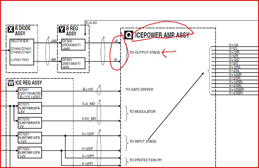

Pioneer sc-lx71 blowing fuses
thought so too could be the error. Therefore I bought brand new B REG ASSY board. Unfortunately, there is no difference.
The output you have selected is supply to the motherboard and not ICE ASSY.
ICE ASSY has its own supply from the transformer;
The B Reg feeds the ICE power stages.
Does it blow the fuses if you disconnect the feed from the regulator board ? You say you disconnected the leads to the ICE power board. You should be able to measure continuity from the regulator direct to the plug/s you disconnected. That's a check that you have isolated the correct feeds
You are going to have to physically look and measure where the output from the reg goes. Its far to complex a service manual to just navigate on a screen.Its possible for the problem to be a low impedance failure and not a dead short, for example if one transistor in the output pairs was faulty on one of the 5 (is it 5?) channels. That wouldn't read as a short across any rail but would draw excess current when powered and blow the fuses.
Its hard when its such a massive service manual viewed on a laptop screen 😉
Listen 🙂... you said yourself that it met its demise after playing loud music for a fun night. That alone points to the output stages and overload damage.
I'm not following you on that.
Do you mean could a capacitor cause the fuse blowing... yes... there are probably many caps that could cause those fuses to blow (and not just caps across the rails) but also caps that could alter the biasing of the output stage and so on. Its just not very likely as a first line of attack given the units timeline in the run up to the fault.
