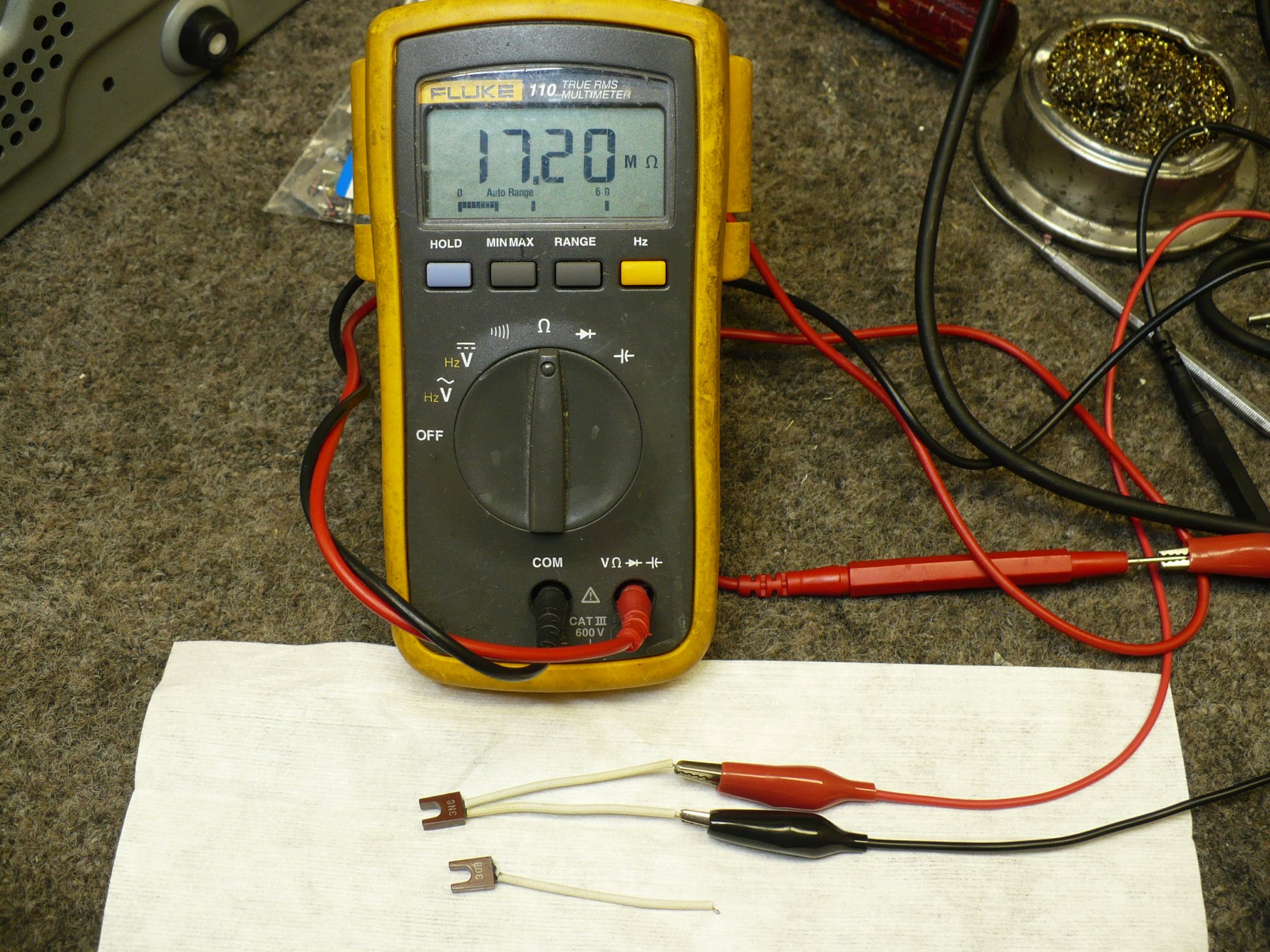

M micjacks45 Member Joined 2010 2022-07-08 8:26 pm #1 2022-07-08 8:26 pm #1 Need help replacing these components. Marked on schematic as TH103-2 and listed as thermistors. However they measure as diodes? Attachments P1000912.JPG 611.5 KB · Views: 104 P1000913.JPG 398.4 KB · Views: 114 M micjacks45 Member Joined 2010 2022-07-08 11:38 pm #2 2022-07-08 11:38 pm #2 Sorry, those are the infamous SV4H diodes from the bias circuit. M MAAC0 Member Joined 2010 2022-07-09 12:09 am #3 2022-07-09 12:09 am #3 Check this thread from Audiokarma https://audiokarma.org/forums/index.php?threads/replacing-the-stv-3h-and-4h-diodes.279530/ You must log in or register to reply here. Share: Facebook X (Twitter) LinkedIn Reddit Pinterest Tumblr WhatsApp Email Link
