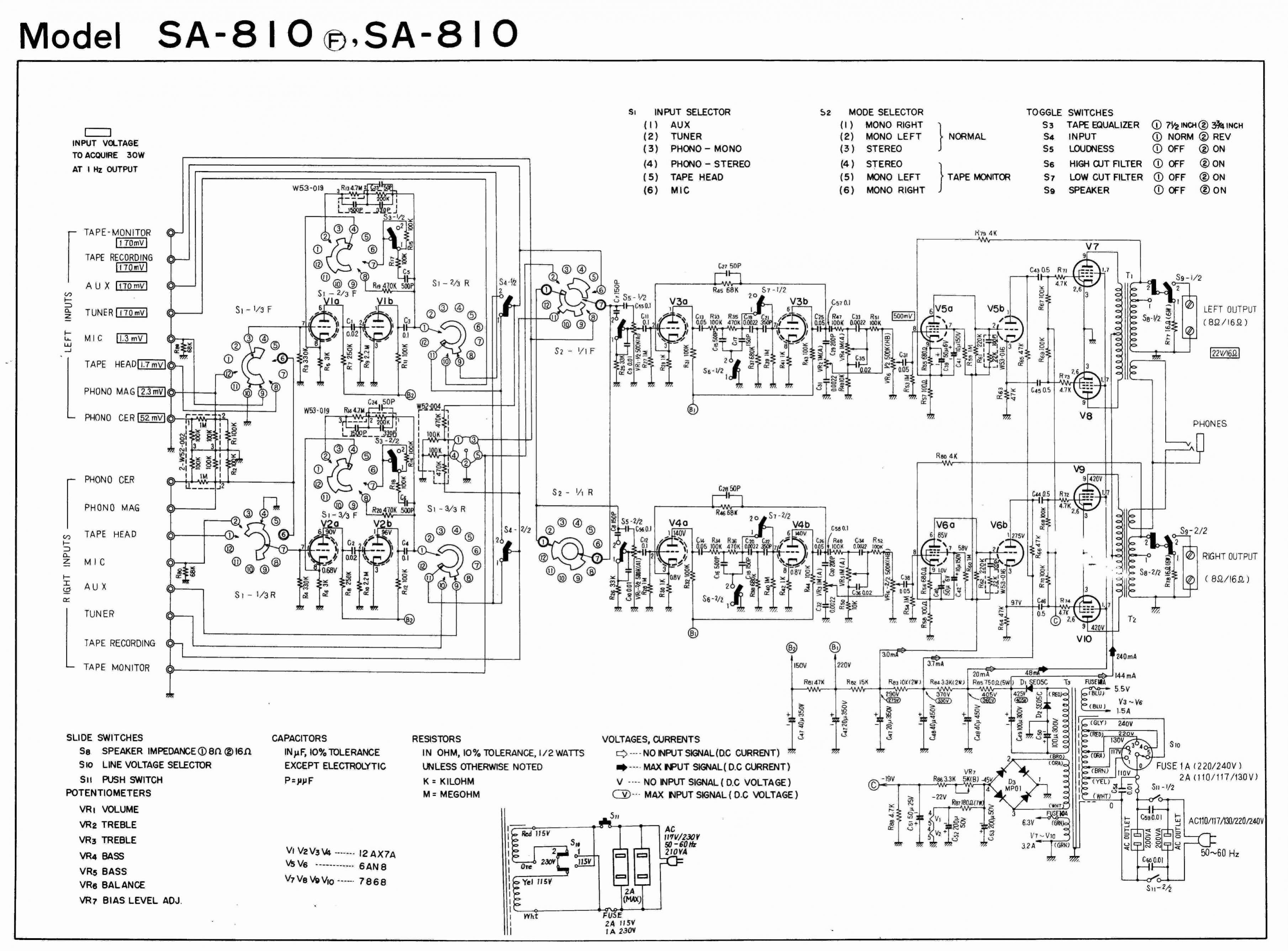

Hello everyone, I am just hoping to get a little help and advice on rebuilding my recently acquired Pioneer SA-810 tube amp..

The reason I am asking for some help is, I now have a white noise issue..
if i turn the treble pots up full its loud on both channels evenly..
I am now looking at replacing all the CC resistors as many of them have drifted high.. and maybe even the treble pots as one is a bit sandy like..
So I'm thinking of replacing all CC's with metal films apart from grid stoppers..
thoughts?
and when we talk about noise in resistors, just how much to the ear can they give? its a fair hiss i have on both channels with treble pots at full..which makes me wonder if i have bad tubes...I hope these are not needle in a hay stack questions.. what ever is causing the noise it is definitely not normal, it is loud enough to come over the top of music.. it does not increase with volume.

I had the schematic blown up and printed onto A3 today to help me read it. Something i didn't mention is when switching the high/low bypass filters the circuit is not happy. I get an audible pop when flicking these switches..although old they are pretty well sealed and i don't think its a case of being dirty.. I am looking at 2 330pF caps in this circuit off the grid pin 7 of the 12ax7 wondering if they are bad as i have not replaced them..I would actually eliminate these switches if i could as i don't see any use for them.
Ok, I went and purchased some decent high voltage clip on probes yesterday and done what i should have done first thing and that's check voltages. I have low B+ measurements which sent me into panic mode thinking I may have a bad transformer. Even with variac and dimb bulb tester
So I went back across all my work marking everything off on the schematic looking for current leakage. I also replaced some out of spec resistors and the diodes.
I cannot find any faults. I have also now replaced the one remaining Can capacitor with 2 fresh caps.
I am worried about powering it up now even to check voltages as i don't want to blow a transformer.
Measurements I have taken are
PIN 1 and 6 of 12ax7 are nearly dead on 140V which is correct
PIN 6 of 6AN8 89V , should be 85V
PIN 1 of 6AN8 160V , should be 275V
PIN 9 of 7868 285V , should be 420V
I have been across the power supply and filter caps 3 times checking everything which is all correct i believe. I have low measurements here at each filter cap junction.
So I believe there is excess current going somewhere...
Should I stop now and get the 6AN8's tested? or should i be putting an Amp meter in series with these B+ taps to find exactly where the current is going?
I am still going across circuit now looking for anything I may have missed.
Am I one the right path here?
Here is the schematic taken from another thread..

PRR
Joined 2003
The little tubes CAN'T suck big current' cuz they are little, and cuz they have large resistances in series.
Don't even be looking there. Pull the BIG bottles, and look around the power supply.
+ of C49 should be over 420V. Report actual value.
However, both C49 C50 must be "good" to get proper voltages. If they are old, they may be replaced on general distrust.
Also verify voltage at C51 is in the ballpark (and negative!).
