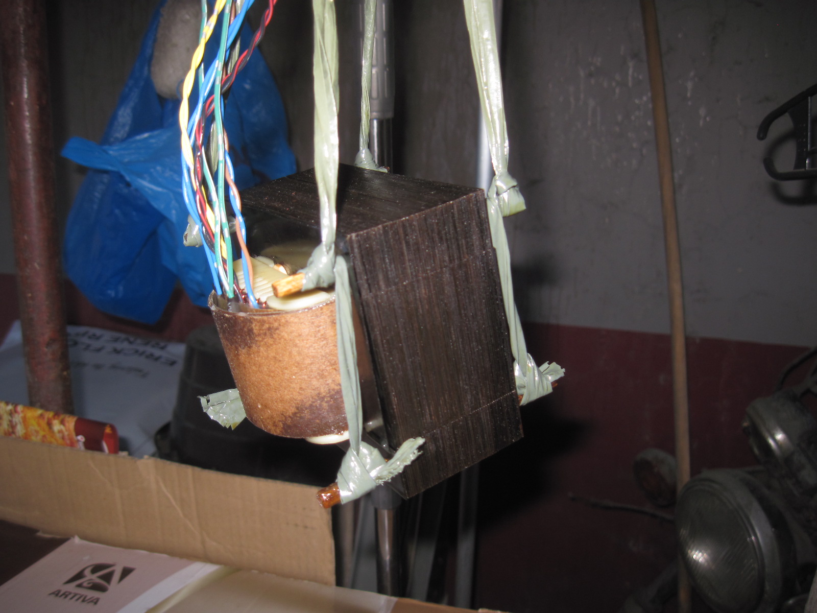

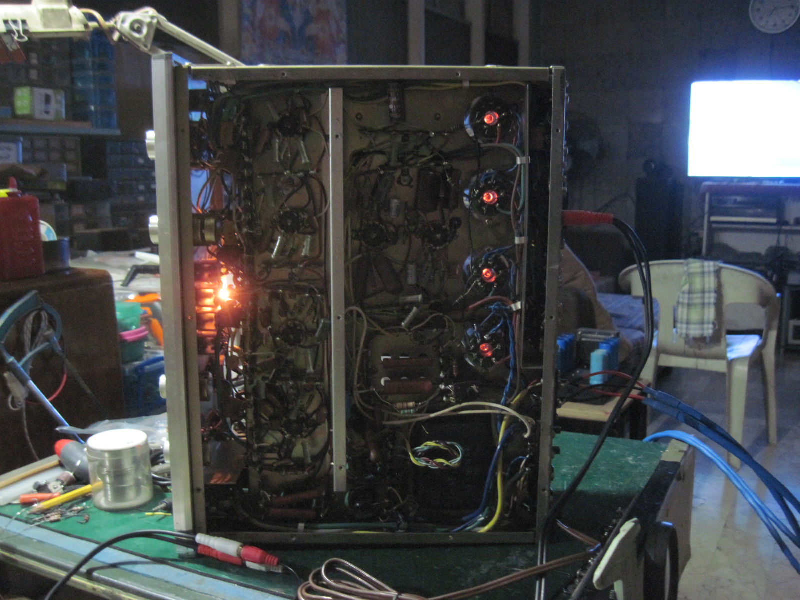

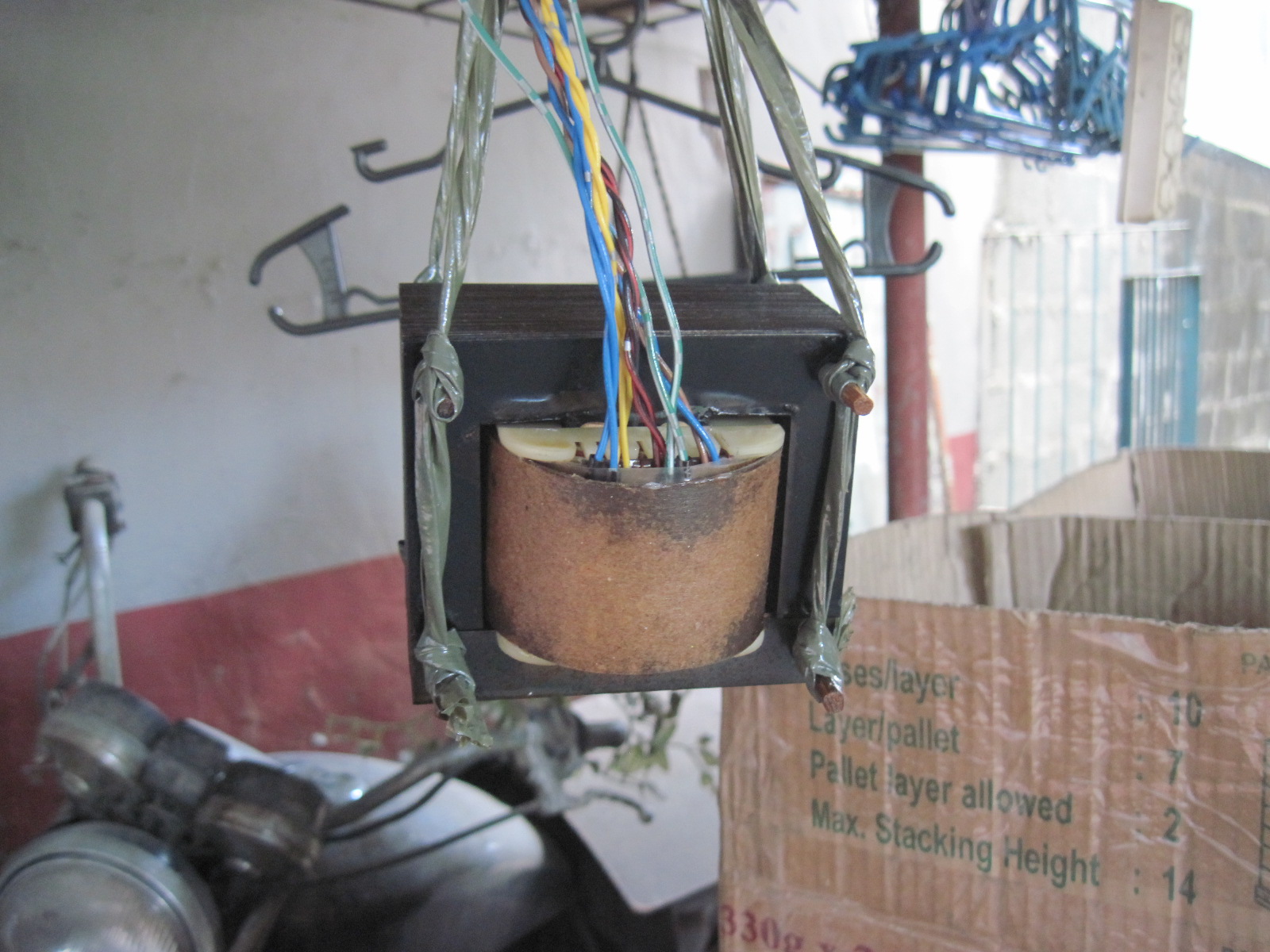

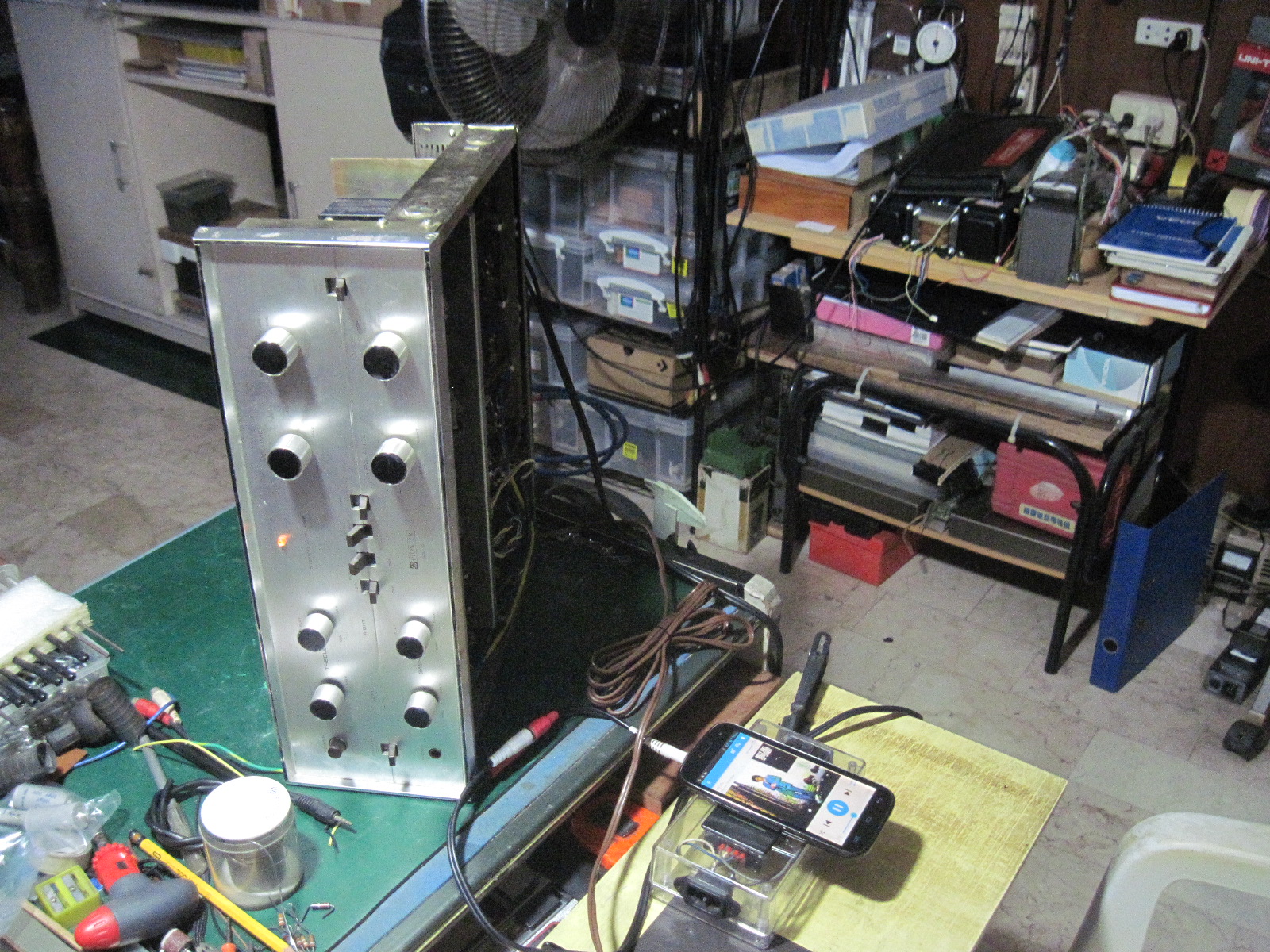

finally i did it....the amp is singing again, power traffo converted to 220 from 100 volts mains...
Reactions: RLC3976
Hi AJT,
Did you rewind the primaries on that? Did you dip it, and if so, what did you dip it in?
You went way further than I would. I haven't any experience rewinding transformers at all.
-Chris
yes i did, i dipped it in a tub full of air drying clear polyurethane varnish...
figuring out the primary turns was easy, count the 6.3 volt winding turns and
you can get the required number of turns pro the new primary..
i waited more than two months for the varnish to fully dry up....
