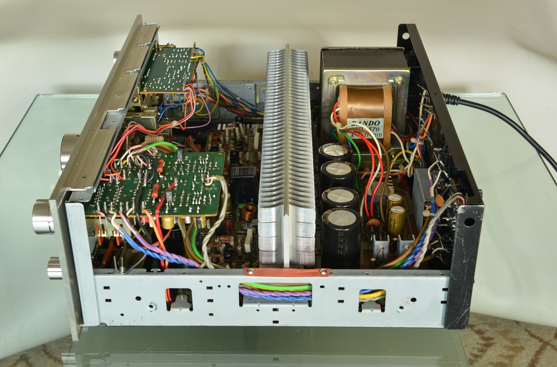

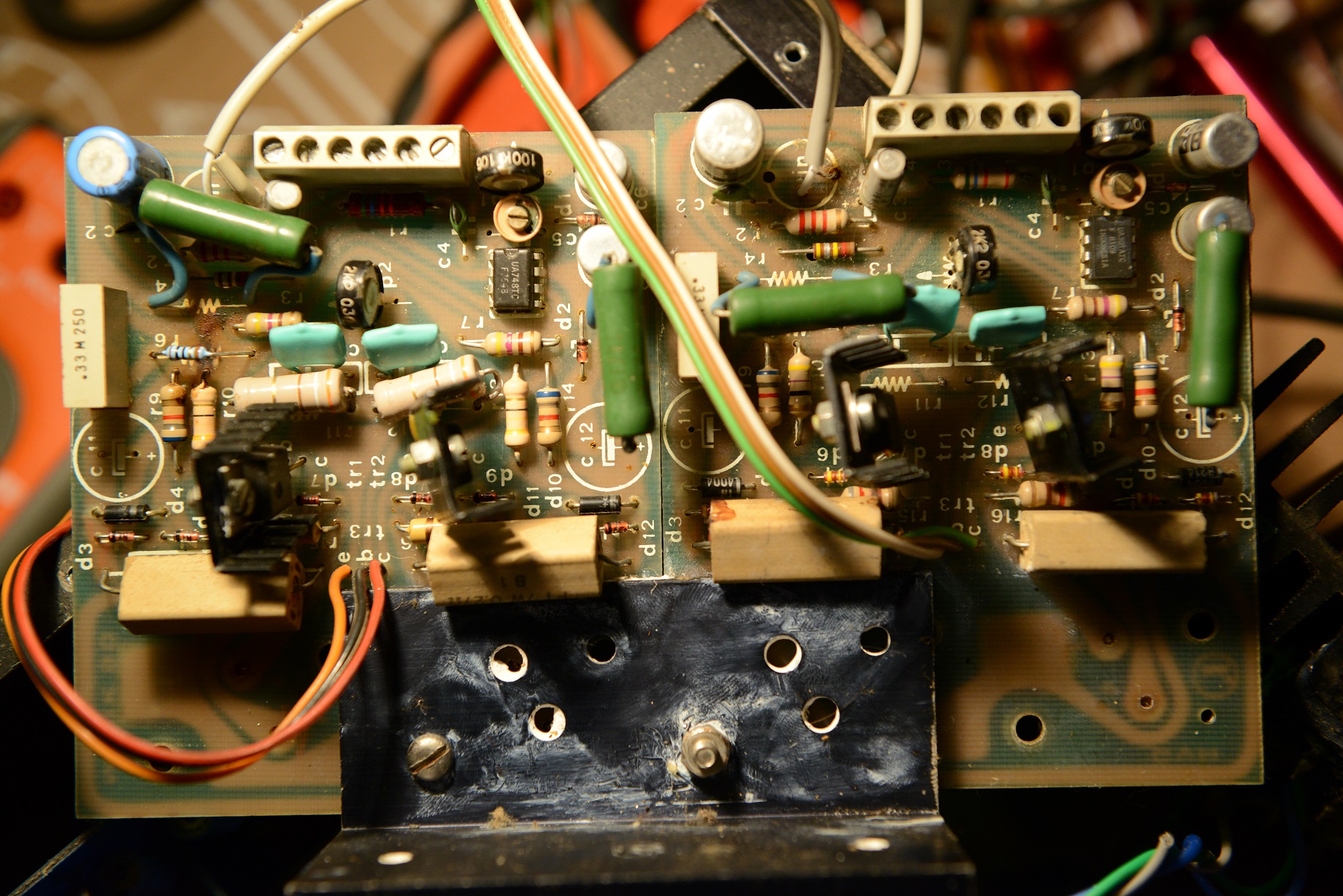

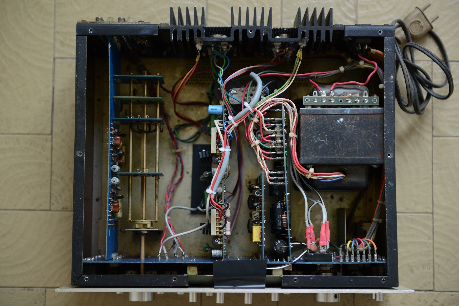

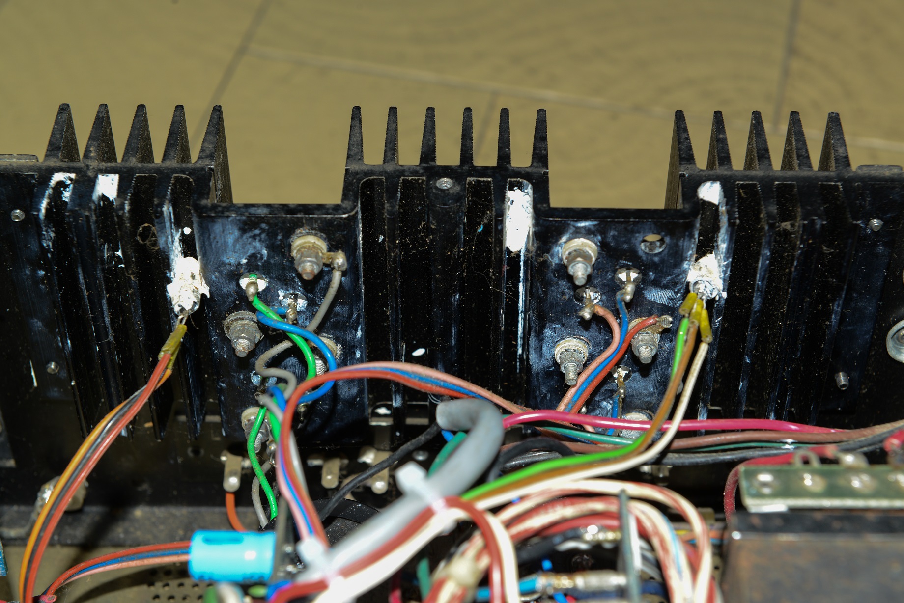

Talking about bad repairs : I bought this Marantz 1120 from a shop that said it had been restored to new, this is what I found, power amp board was not original and was just a mix of different transistors, no pairs just random transistors close to original specs, tracks were gone on other boards, to-3 outputs were two different pairs from 4 different brands, anyway I'm trying to get it back to original, still looking for the power amp board... DSC_3331-2.jpg
I have no idea, I went back to ask them when I saw this and they couldn't tell (or didn't want to, they seemed surprised that I even opened it). Anyway, got the power supply back to original and the preamp is working great now that I removed all the junk so I just need to find that board and than get the original parts (I already have the original outputs : 4 sj2519).

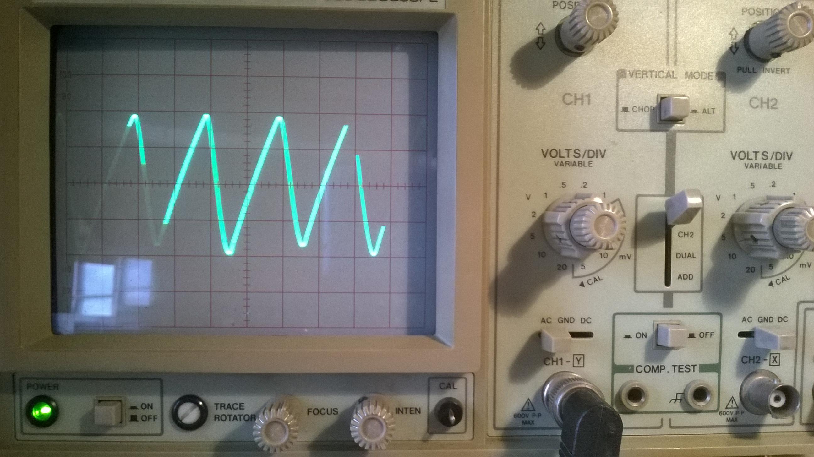

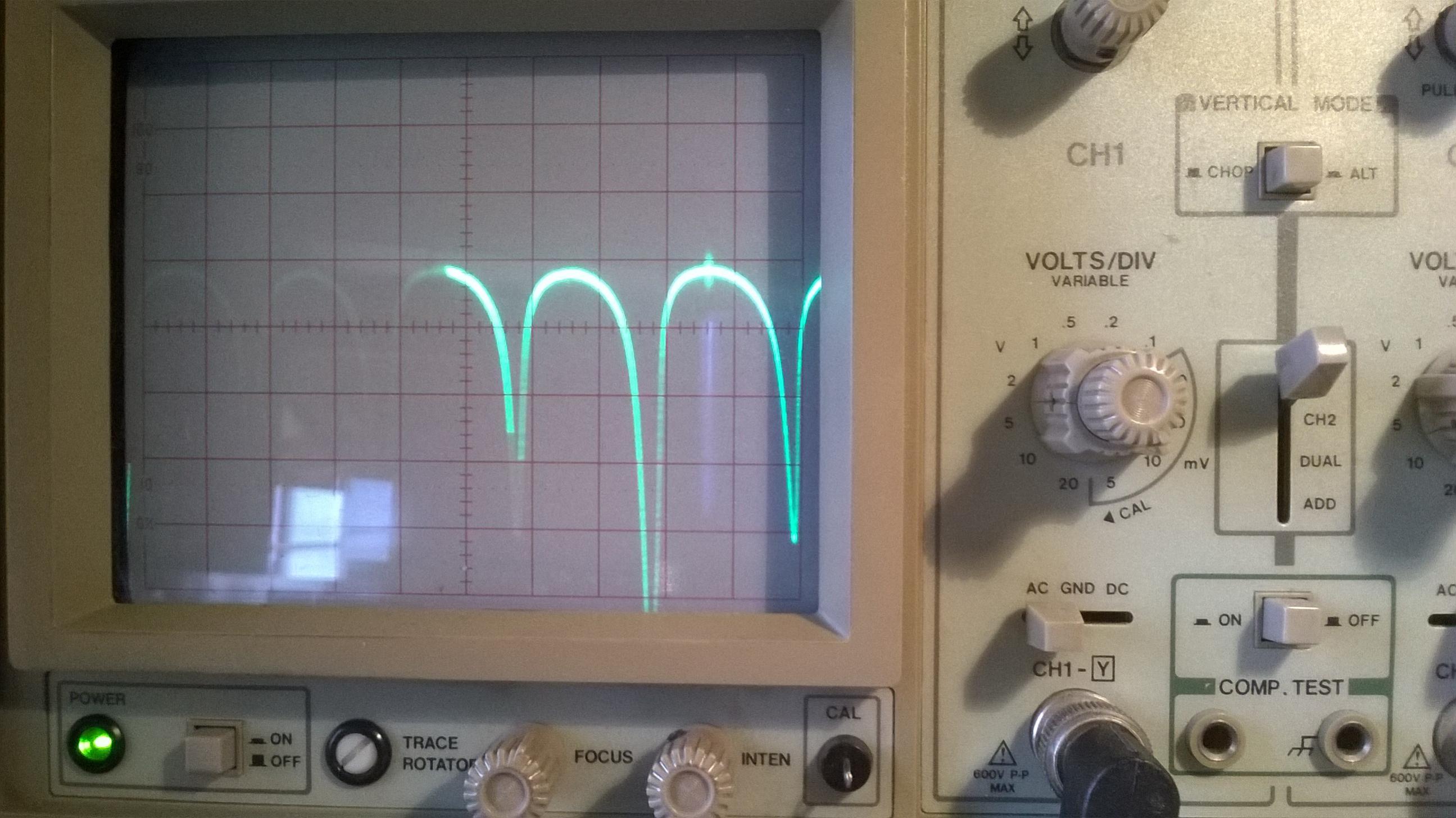

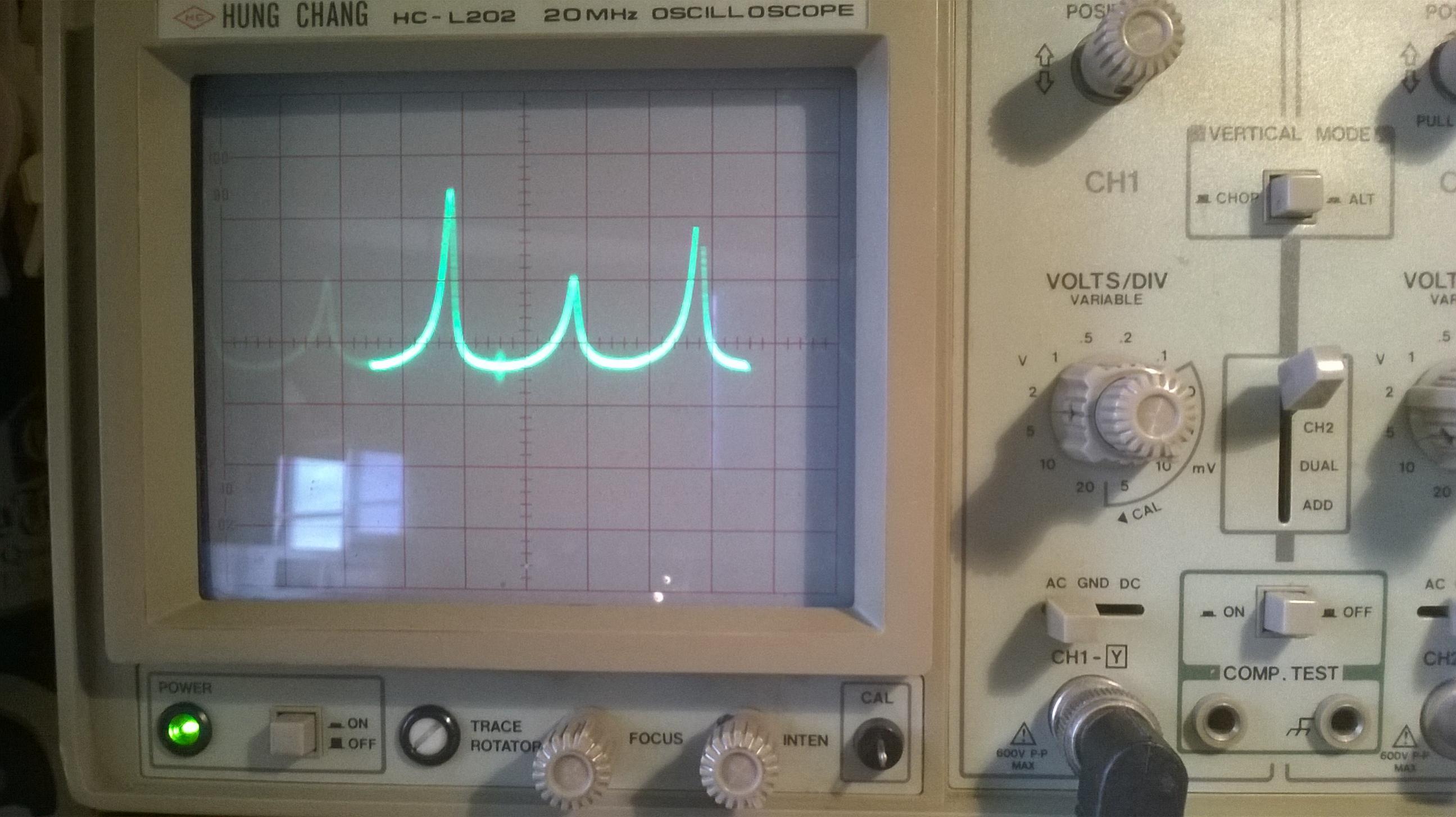

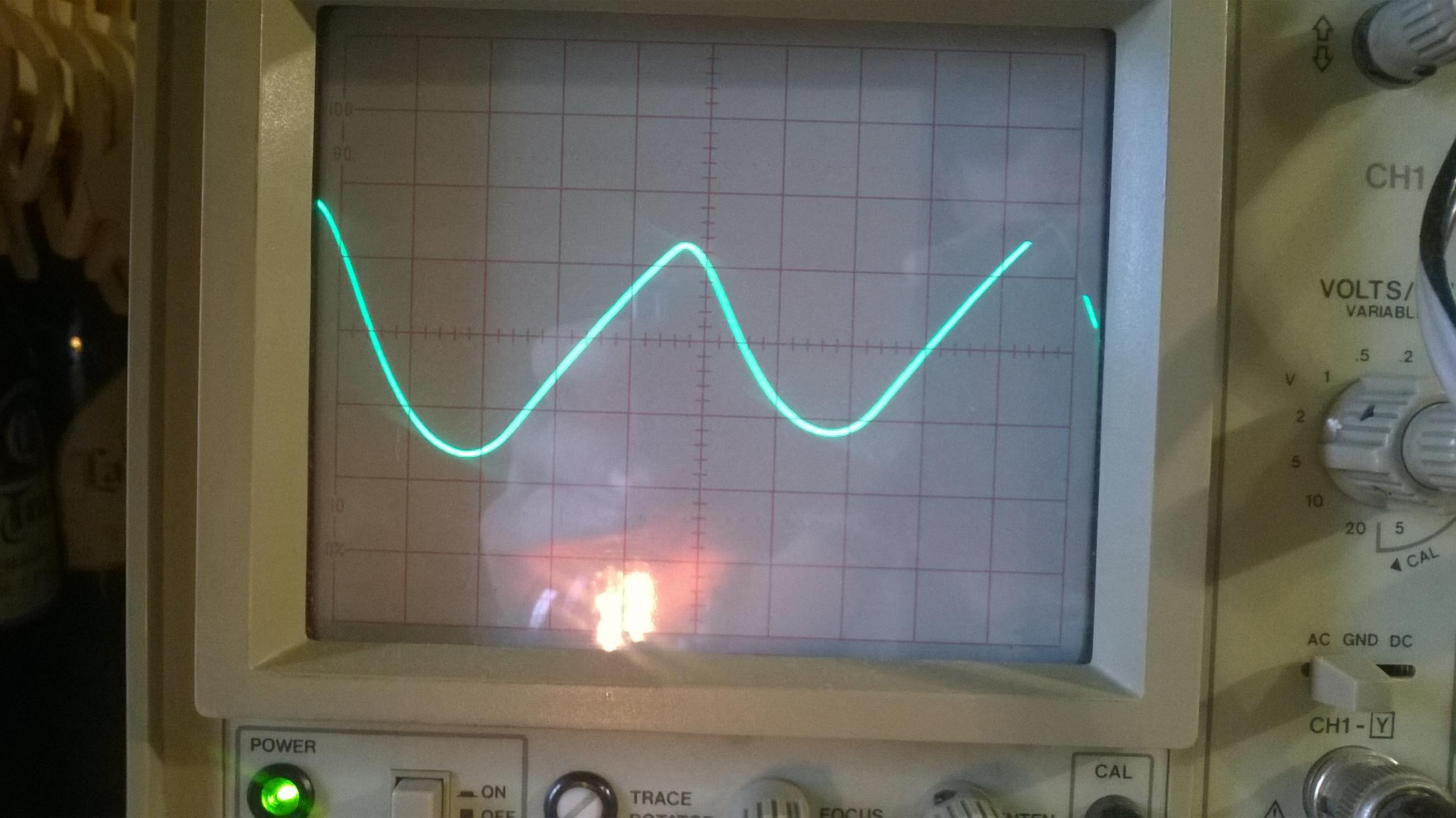

Bad news : when I first changed the drivers I took some that I had taken out of an other pioneer amp and as I said the sa-7800 worked fine, I decided though to replace them with the drivers you guys suggested (2sa1930/2sc5171) because the ones I put in had been in an amp with output problems so I didn't trust them too much. Now I'm exactly back to square one, got the exact same hum coming through the headphones and the exact same signal on both outputs : WP_20160520_002.jpg WP_20160520_005.jpg and power supply rails : WP_20160520_009.jpg 😡
I could just go and test the 2sk34 again but I feel there's no point if I don't know why it keeps going in circles.

Thanks for the tip but I don't think the drivers are the problem (not any more at least). When I just take random reading with the oscilloscope I got the first image everywhere on the positive side and the second on the negative side except for everything that comes from the power supply. Bias and offset are good, I changed the dual transistors with matched ksa992 (for the 2sa979) and ksa1845 (for the 2sc2291) which got offset down by 10mv, and did all the solder joints. I will check the voltages tomorrow. What is strange is that this is exactly the same symptoms as in the beginning

I checked all the voltages in the main amp stage and they are all good. A little correction the first reading on the oscilloscope is on one channel and the second on the other channel not negative and positive side of the same channel. I had the good idea at some point to disconnect the power to the equalizer stage and the problem was gone. As the signal is about 55hz I first checked all the ground connections but they're all good and the stage itself seems to work fine and the voltages are good on the transistors.
Well, I tested the amp without the dim bulb and... hum is completely gone, all voltages are perfect and the amp sounds amazing. I Actually have another SA-7800 here that works perfectly and I turned it on with the dim bulb and guess what, got exactly the same hum and same reading on the oscilloscope. I got a 100W bulb that only lights very slightly with the amp idling, strange this has so much impact.

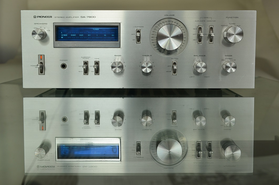

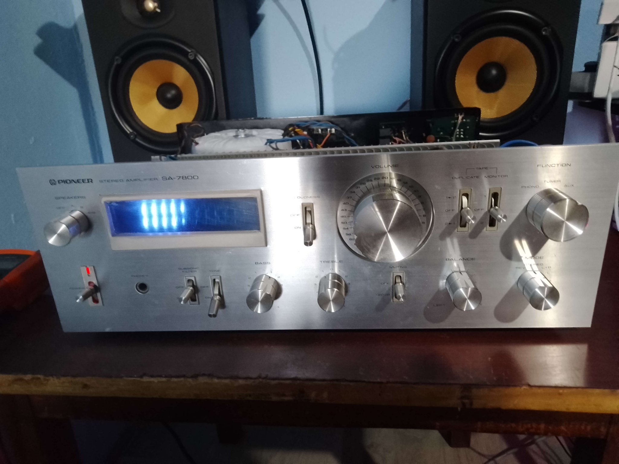

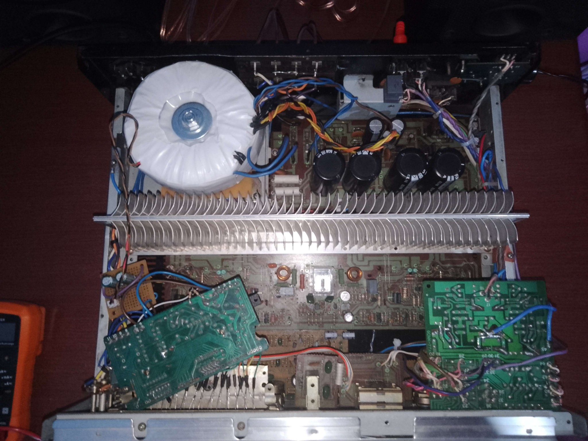

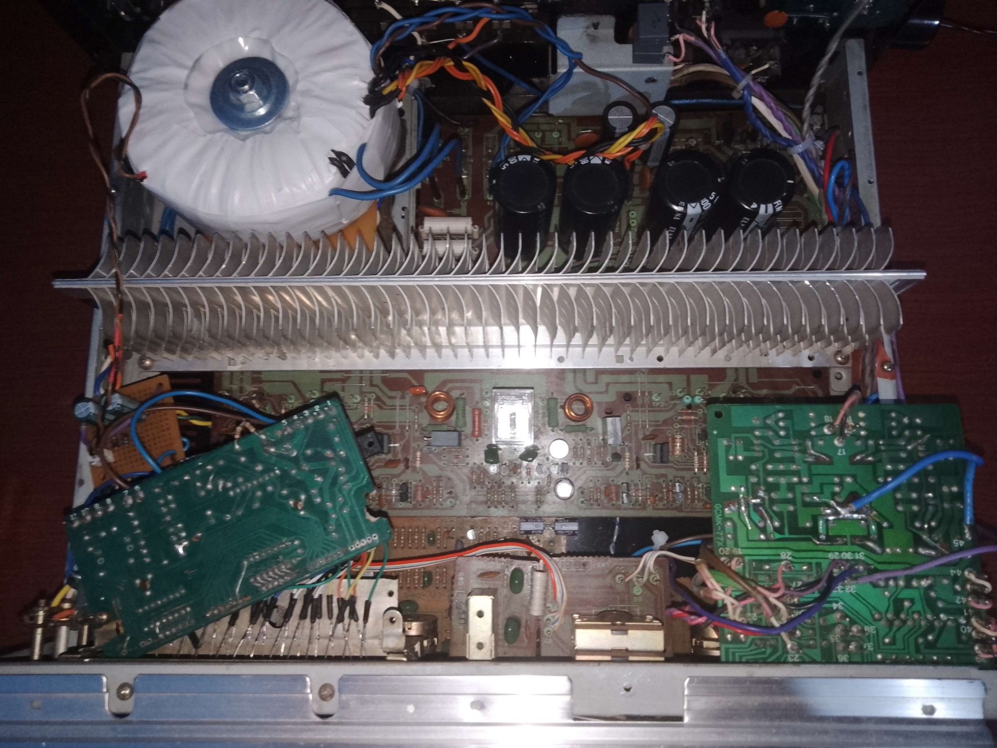

Anyway here are some pics of the finished amp, love it !!!

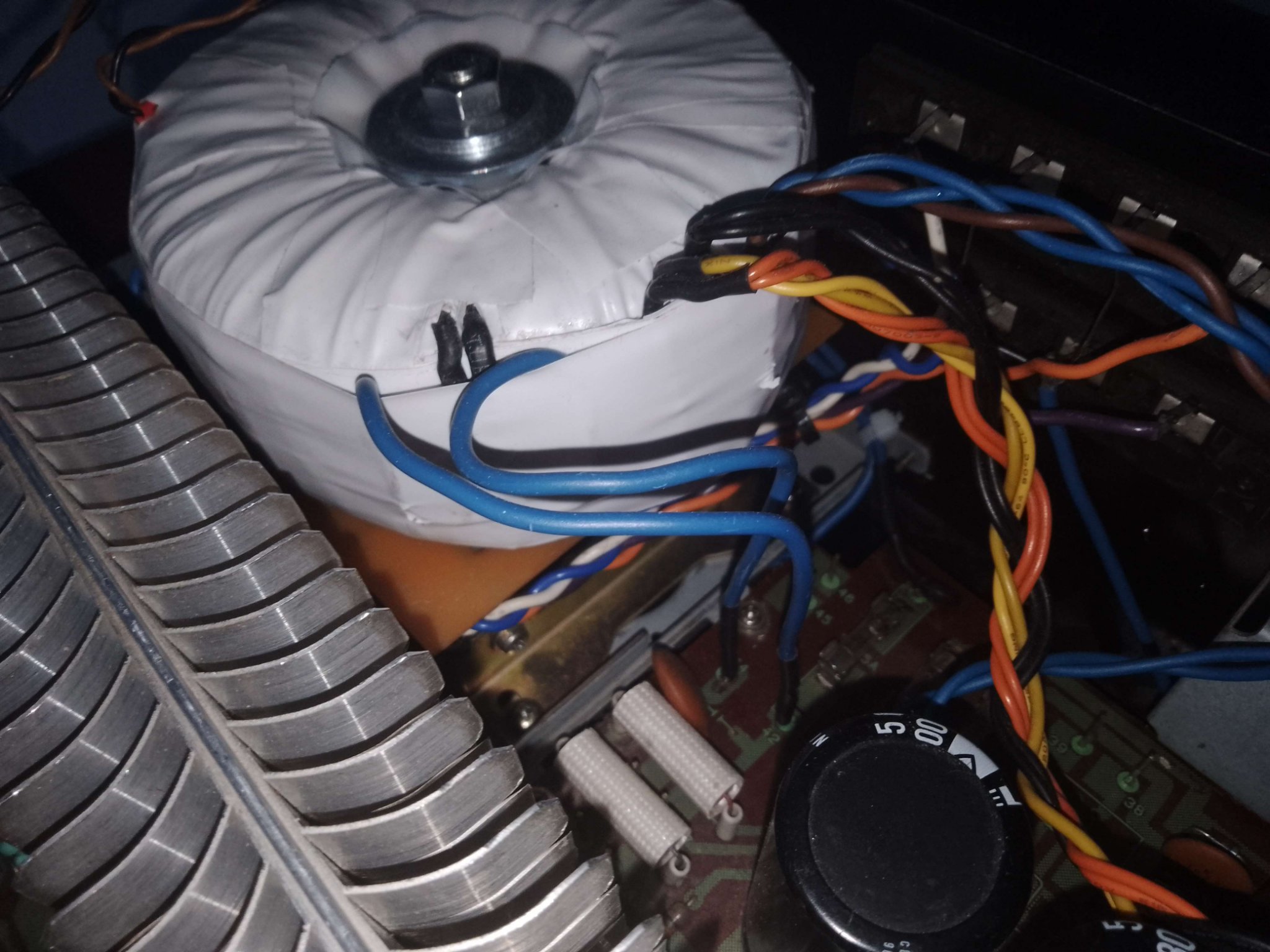

Mine was like Power Transformer was getting on 80c+ on idle (the transformer core itself)
The VFD tube on mine was dead (Unobtanium)
The amplifier were blown. (Amplifier needed full rebuilt + most of the "working" transistors were leaky, caps were bad, but i found that the main filter is okay. Not bad, not that good but its ok! 7000-7200uf out of 8000uf and the ESR was Perfect!)
I am at Europe but not in EU itself, so mouser components not really available, but i got good components. (Some Nichicons and Elite caps)

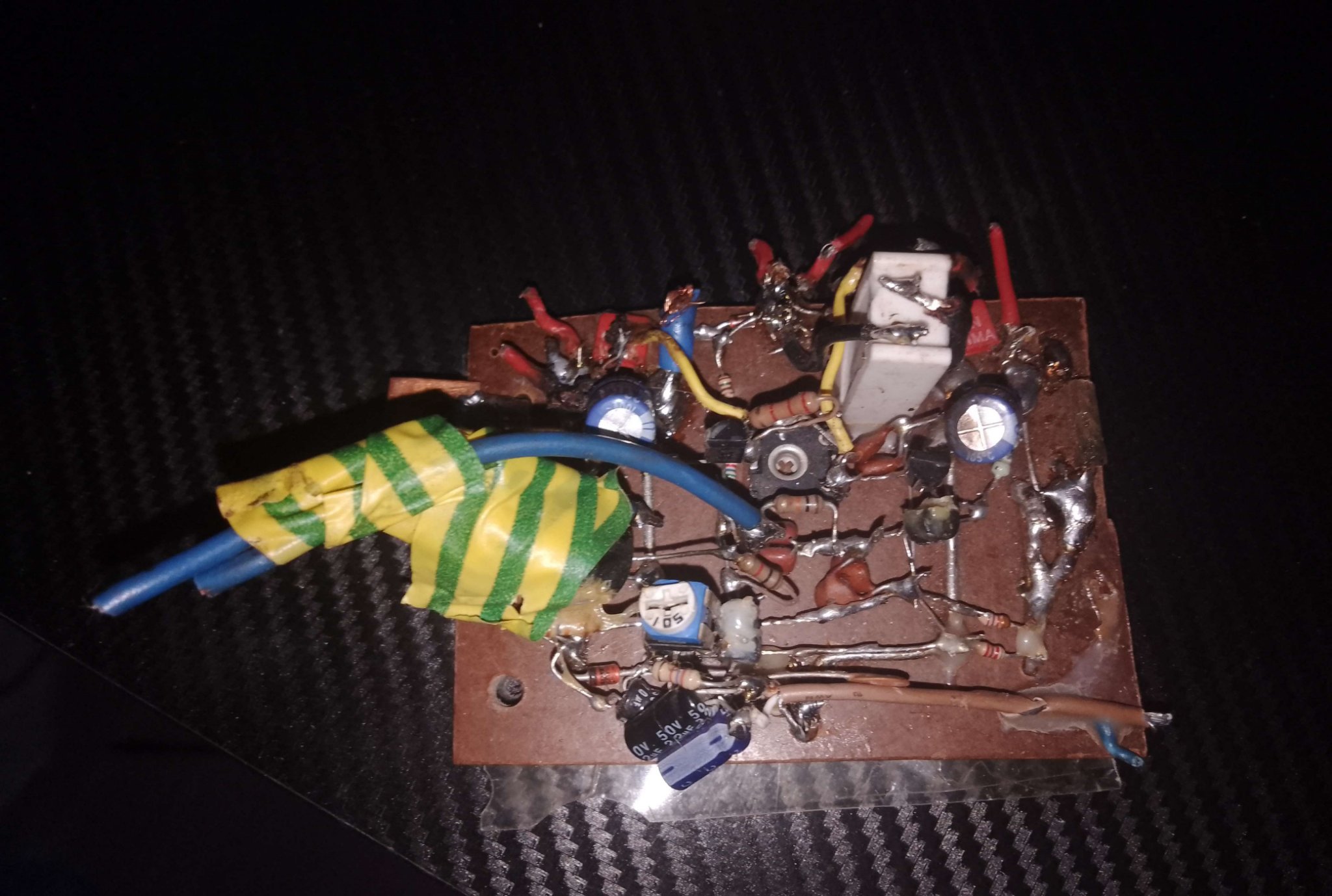

I think its more like now a DIY amplifier, since it looks far from Depaj's unit, and it was really in rough shape, and also this poor unit were at a bad Service man who loved Vodka so much he made that in the amplifier (The last photo where the components all in air with the yellow-green stripped tape (must have))

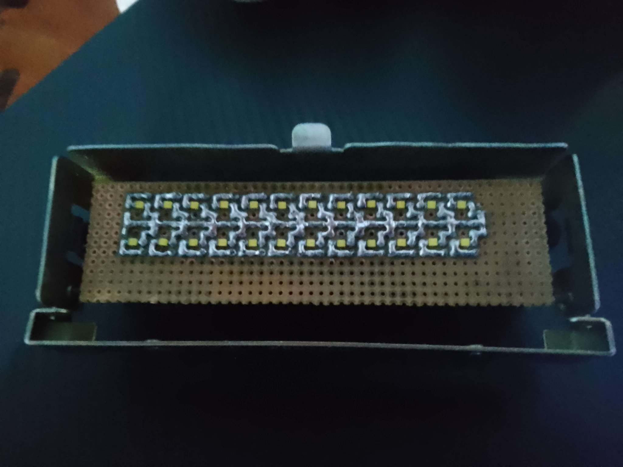

I'm also showcasing the vu meter that i made. it made with Cold white 1206 Lite-on's smd leds on a pertinax board.
