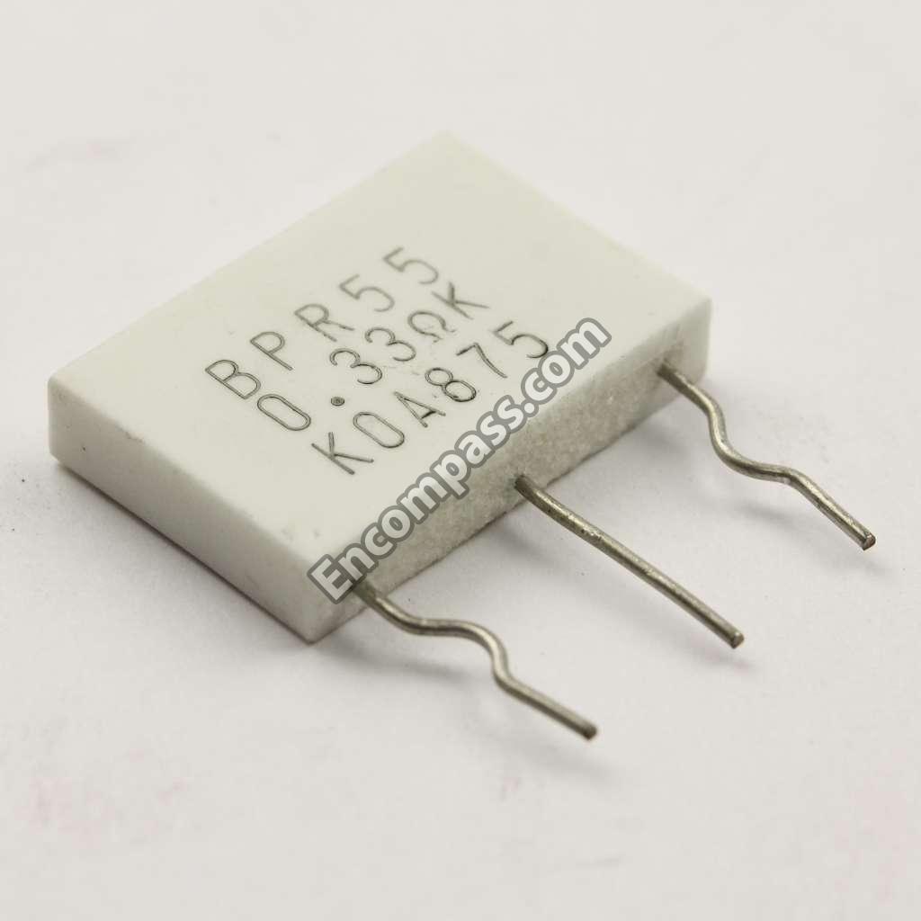

So i just changed the fuse 3.15 amp to my amp and since then the front lights are very dimmed (seems like low in voltage) and the big white resister (R-592 (right channel, please see the attachments, there are 2 big white colored resistors for each channel) is getting super hot and i can see some white smoke coming from the resistor and had to turn off within 1 or 2 seconds before it blows up or cause other damage.

Reads like you have shorted output transistor(s), the white resistors being the emitter resistors. Will take a look at the sm so time for an expert to chime in. All this from only changing a fuse? Was unit working ok before? Did it suddenly go silent? Little more history required...

and here's the picture below of the resistor which gets hot like lava and makes smoke as soon as i turn on for 1 or 2 seconds ...

Most likely you've got a failed output transistor with a short between c-e.
With amp powered off/unplugged measure the resistance between the case of an output transistor and any leg of the nearby emitter resistor. Repeat for next transistor. When testing the other channel/outputs, you will need to measure against the corresponding emitter resistor. Don't expect a near short.

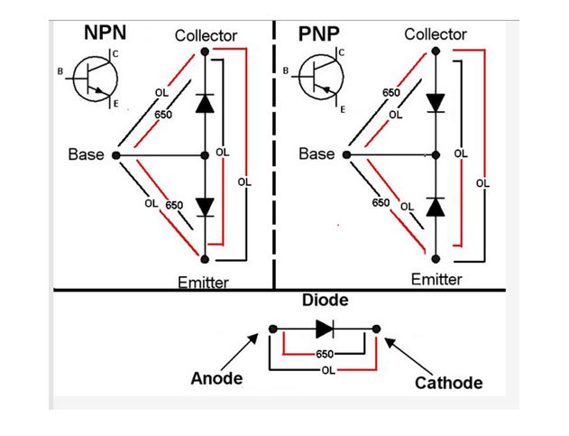

Here is a nice graphic from markthefixer from audiokarma. It explains in a nutshell how to diode test transistors. Red/Black refer to meter probe orientation. Two expected results, either OL (open loop) or 650mV or thereabouts.

I should add that output transistors rarely fail solo. Expect other damage eg, driver transistors... Ooops, You should test output transistors on the side with the hot emitter resistor...ie, the right channel

Wanting to measure resistance between Q532 Collector and any leg of R592.
on 200 ohms settings on the meter and connected the node with transistor's collector, the value shows up as 00.3 on first leg, 00.6 and second leg and 00.9 on third leg of the resistor.
Repeat for Q526 collector and R592.
on 200 ohms settings on the meter and connected the node with transistor's collector, the value shows up as 00.3 on first leg, 00.7 and second leg and 00.9 on third leg of the resistor.
If i set the multi-meter on diode setting then all the values shows up as zeros with a beep sound.
Results suggests Q532 and Q526 have failed (c-e) short. If you have any doubt about the test then you can redo but measure from the middle leg of the transistor to R592...
Next step is to check for other damage.
R592 looks ok.
Diode test Q528, 530, 522 and 524
Also Q602, 604, 614, 616
Diode test D602, 604
Resistance test R588, 590, 586
Refer to previous graphic on diode testing, all tests with amp powered off/unplugged.
