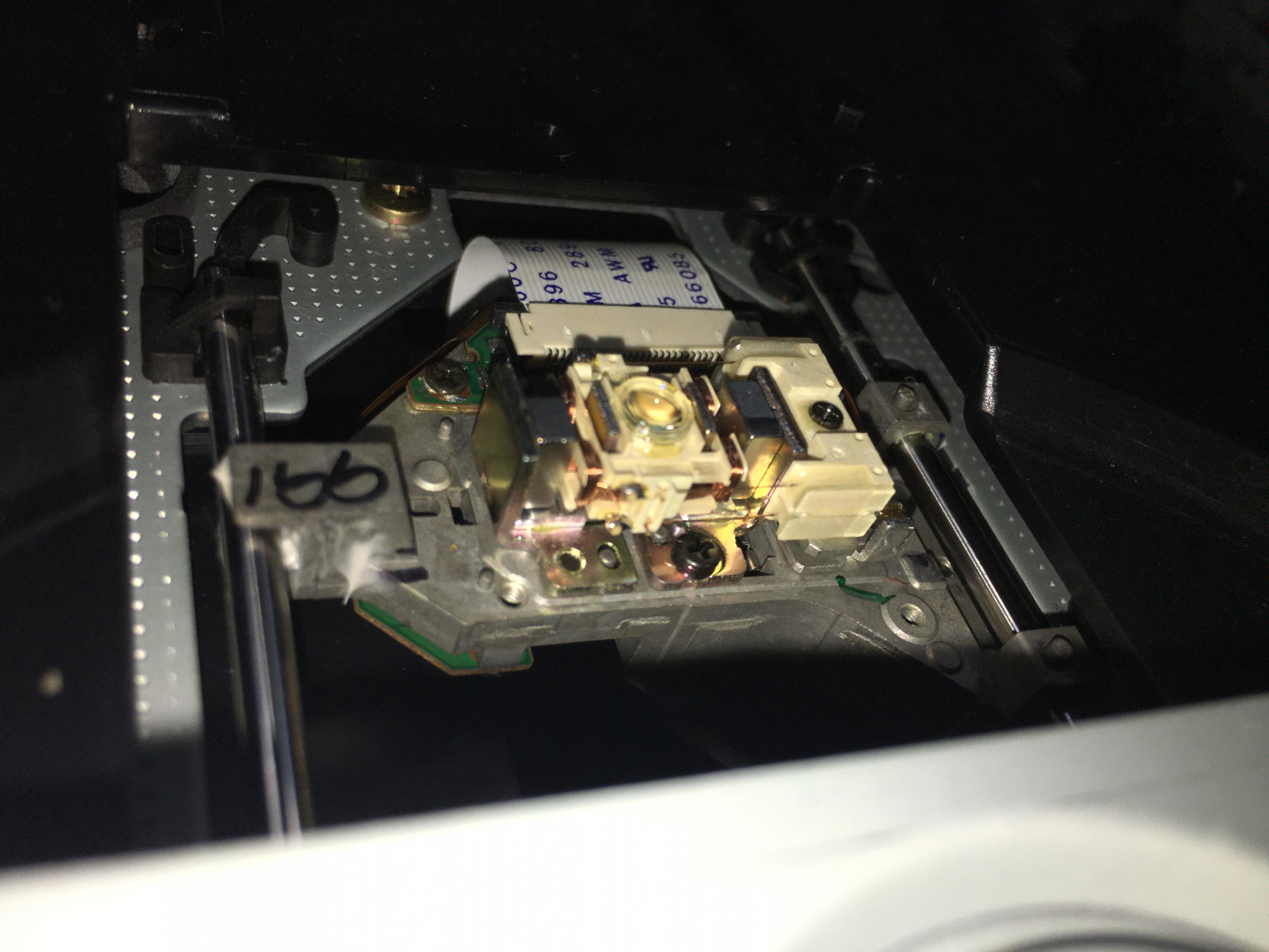

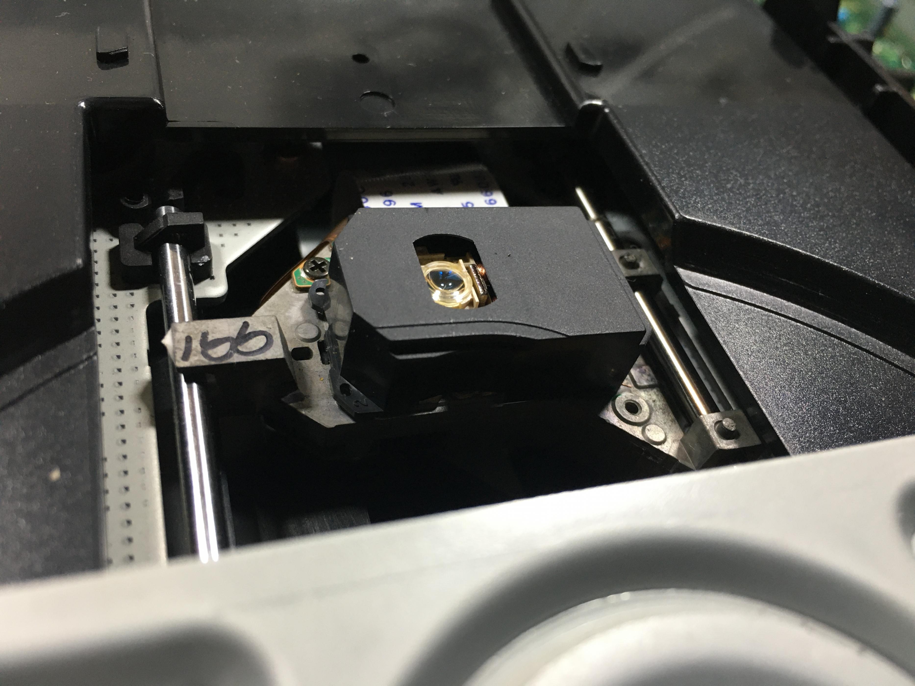

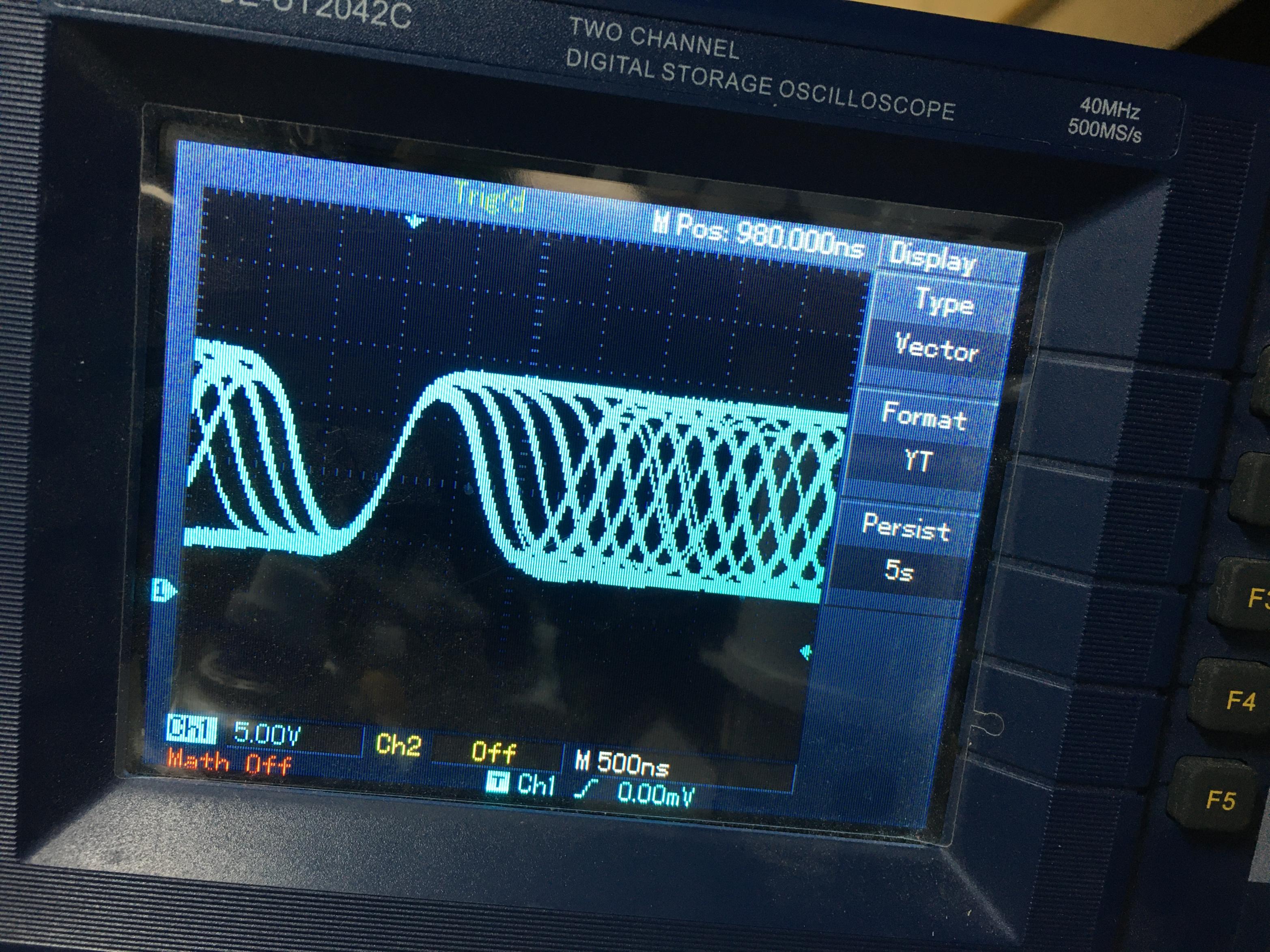

The laser on that model is optimized for CDR media which makes it easier for it to read that over standard aluminum vapor deposition CDs. What does the eye pattern look like when it does manage to play back a standard CD? You may have a fogged lens on the underside which is very hard to clean. Has this unit been used in a dirty or smoke filled environment?
sorry for the very very late response and thanks for your answer.
The Eye pattern looks good while playing CDs.
It's only the TOC Read for pressed CDs the player can't perform.
That is only possible if I have set the playback laser power to nearly maximum.
The recorder is a used device but it is very clean in the inside.
